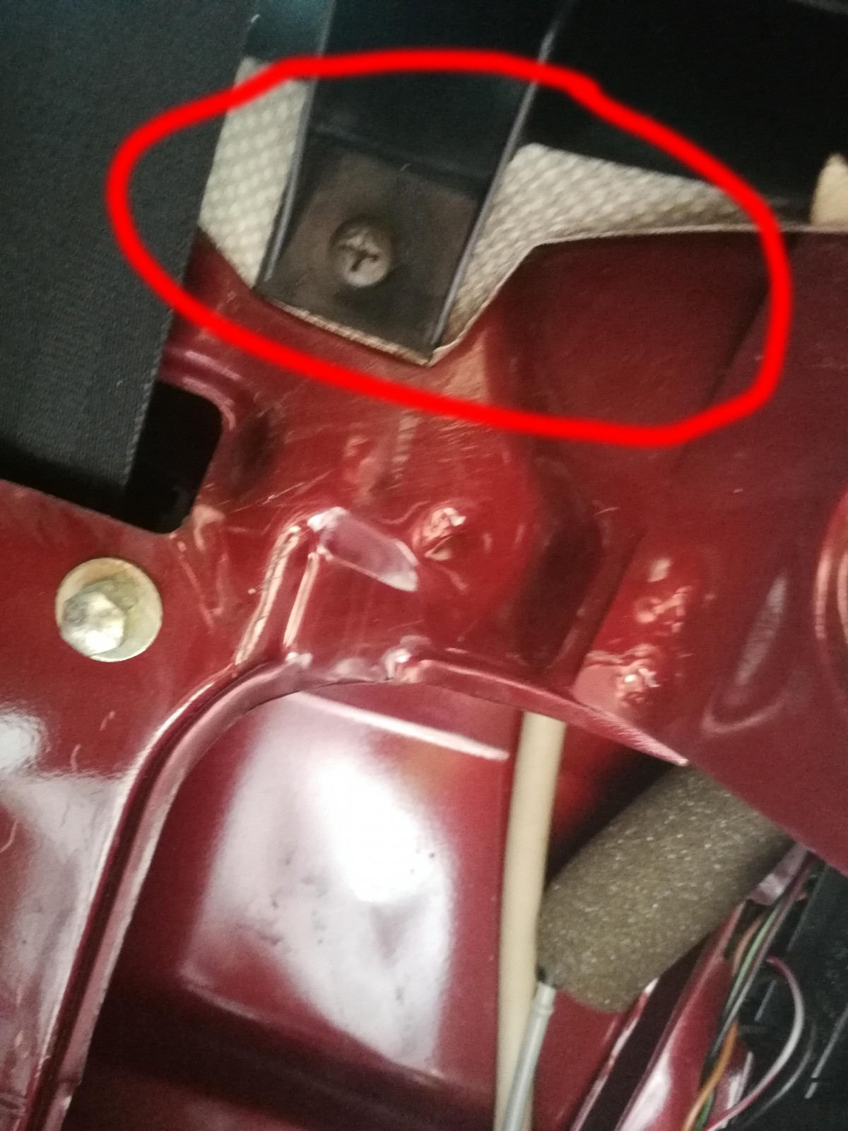

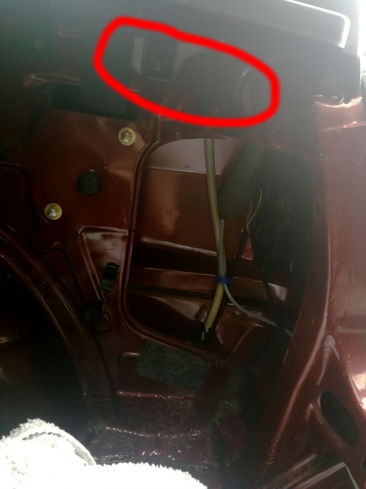

Hi all,
I am stumped regarding a leak in my mk3 bready, am getting puddles in the boot, but only on the drivers side near the rear light cluster. I have put silicone in every seal i can see in the area fucked about in the boot whilst someone poors water on the boot however the problem still persist. It only seems to happen when i am parked uphill water seems to come out of the area circle in the photos. I am thinking it is the rear sun roof drain, but not 100, any suggests what else it could be and any solutions if it is the drain that doesnt involved removing head liner.

is it coming in where the rubber boot fits near the boot hinge
