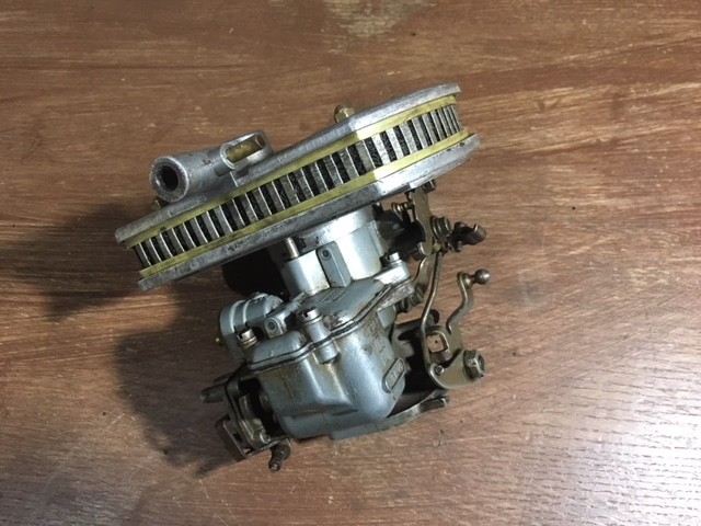

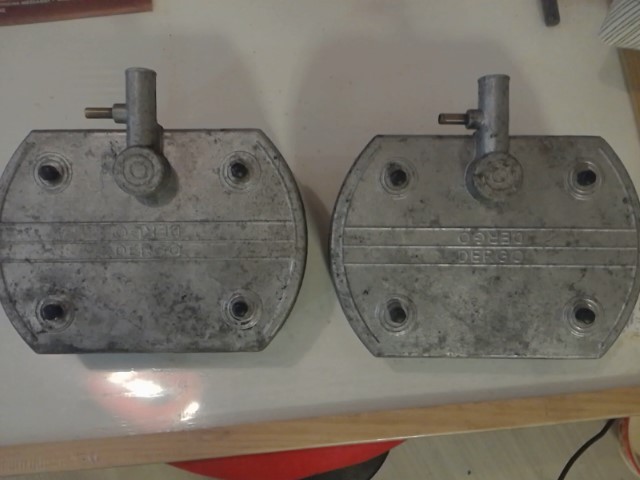

Anyone come across Dergo filters before?
I can only find a few images for Fiat 1100 twin choke carb filters, but no company history or other information.
The filter element looks like scrunched up wire wool. I'm sure it flows better than paper element.  I can imagine it stopping insects and dandelion seeds but not being as effective as K&N oiled cloth or polymer coated Ramair foam
to keep roadspray suspended rock-salt, grit, tyre rubber, diesel soot and pothole dirt out.
I want a filter that covers the DHLA idle circuit, which trumpets plus foam socks do not. And found some Dergo for Alfa twin carb filters.

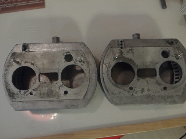

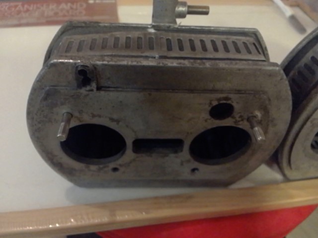

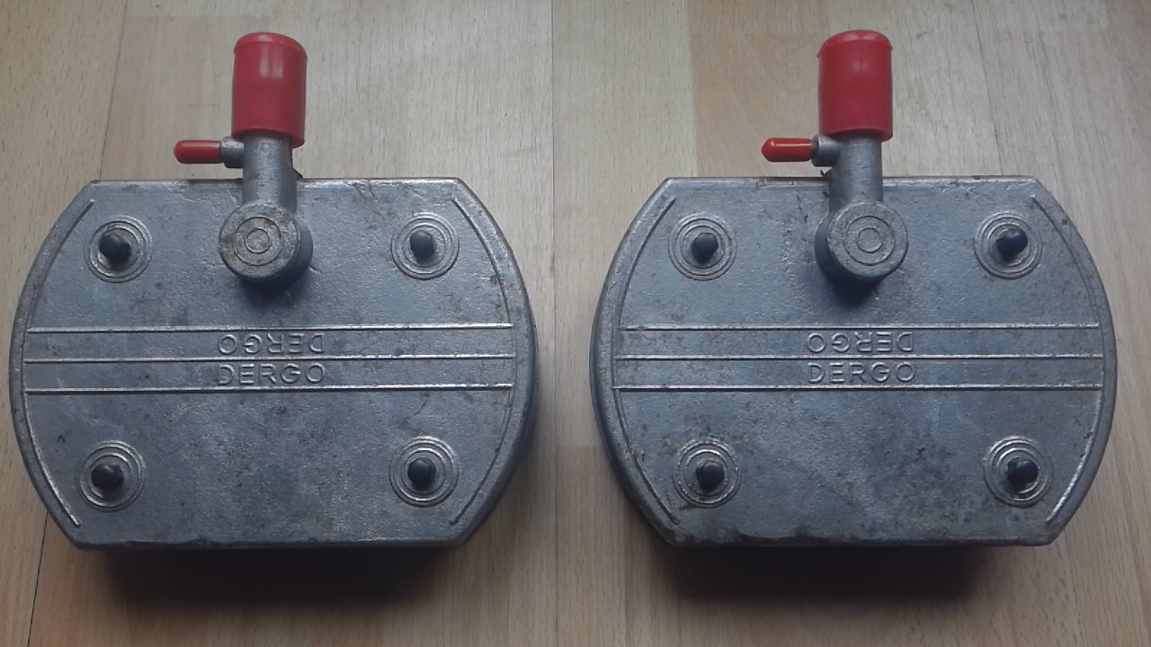

imageproxy.php?img=&key=a31c107f08879a83imageproxy.php?img=&key=a31c107f08879a83dergo-filters.thumb.jpg.960694e27ae88e0f50b581c64889e12f.jpgdergo-filters-open.thumb.jpg.df41bf9673ed798d14012ece329c77b9.jpg

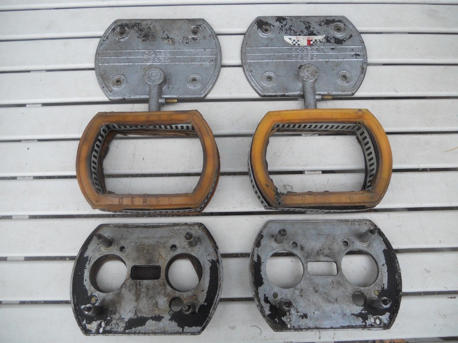

In a bit of a mess...

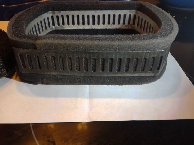

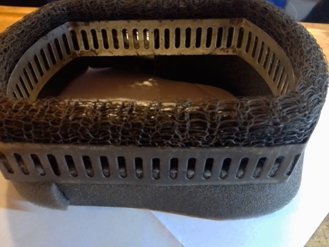

This is the wire wool construction

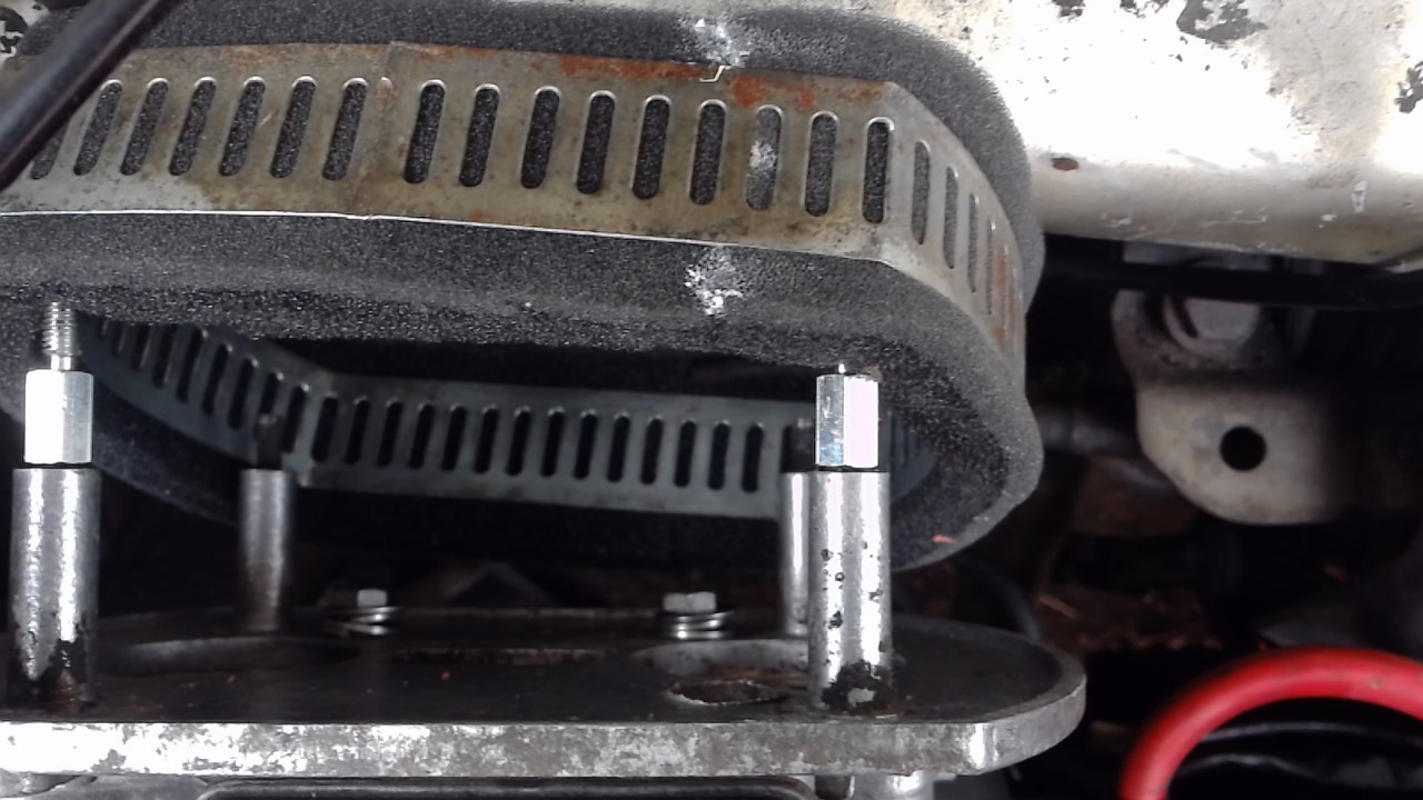

You can see I'm pushing it out from below with a sheet of Ramair foam.
Fitted longer m5 spacers and new m6 studs and nuts.

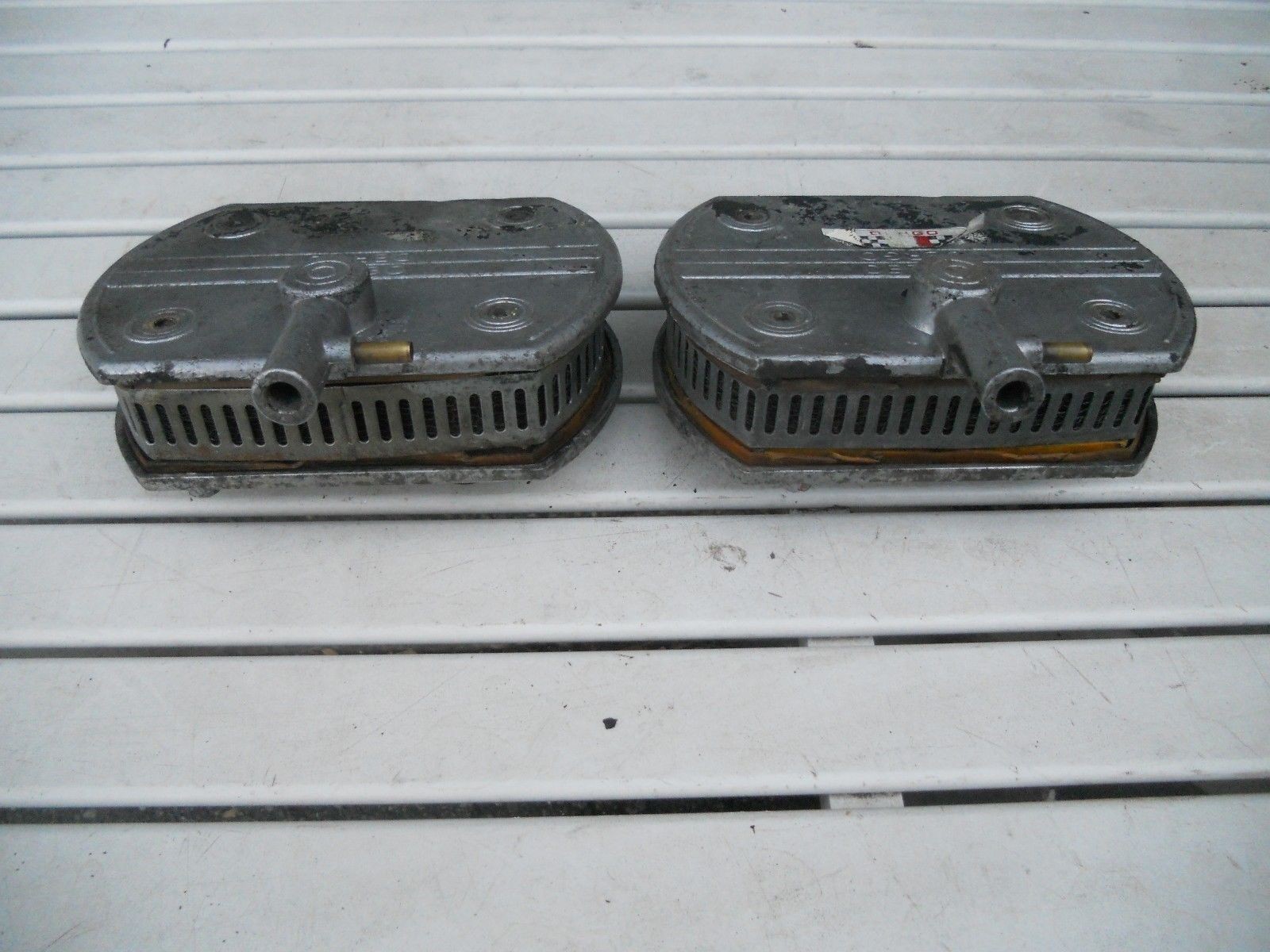

Clean up the cases
Should keep carbs clean and shortens the inlet.
Can't decide about the vacuum and breather ports.
Blank them or use with Y-piece from the breather pod on block?

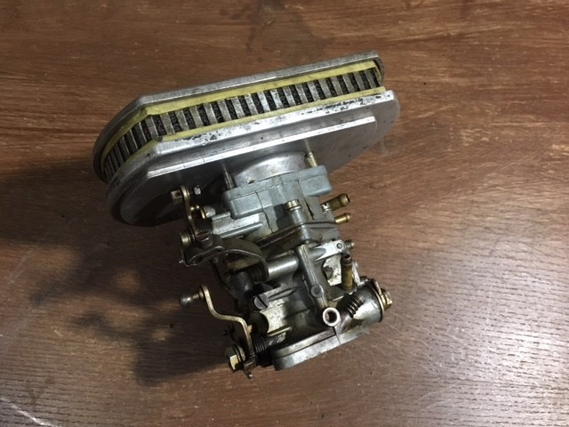

Looks like they were black
See the source image
on a weber 32iba … with some ingenuity!

Alfa Romeo did not have trumpets inside the Dergos and were only ~26mm deep front to back inside faces.
(I'm pretty sure I added 12mm spacers)

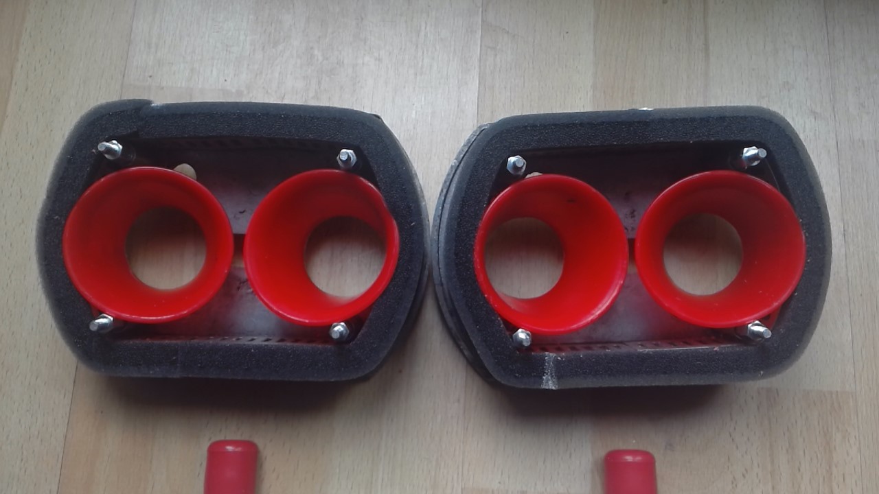

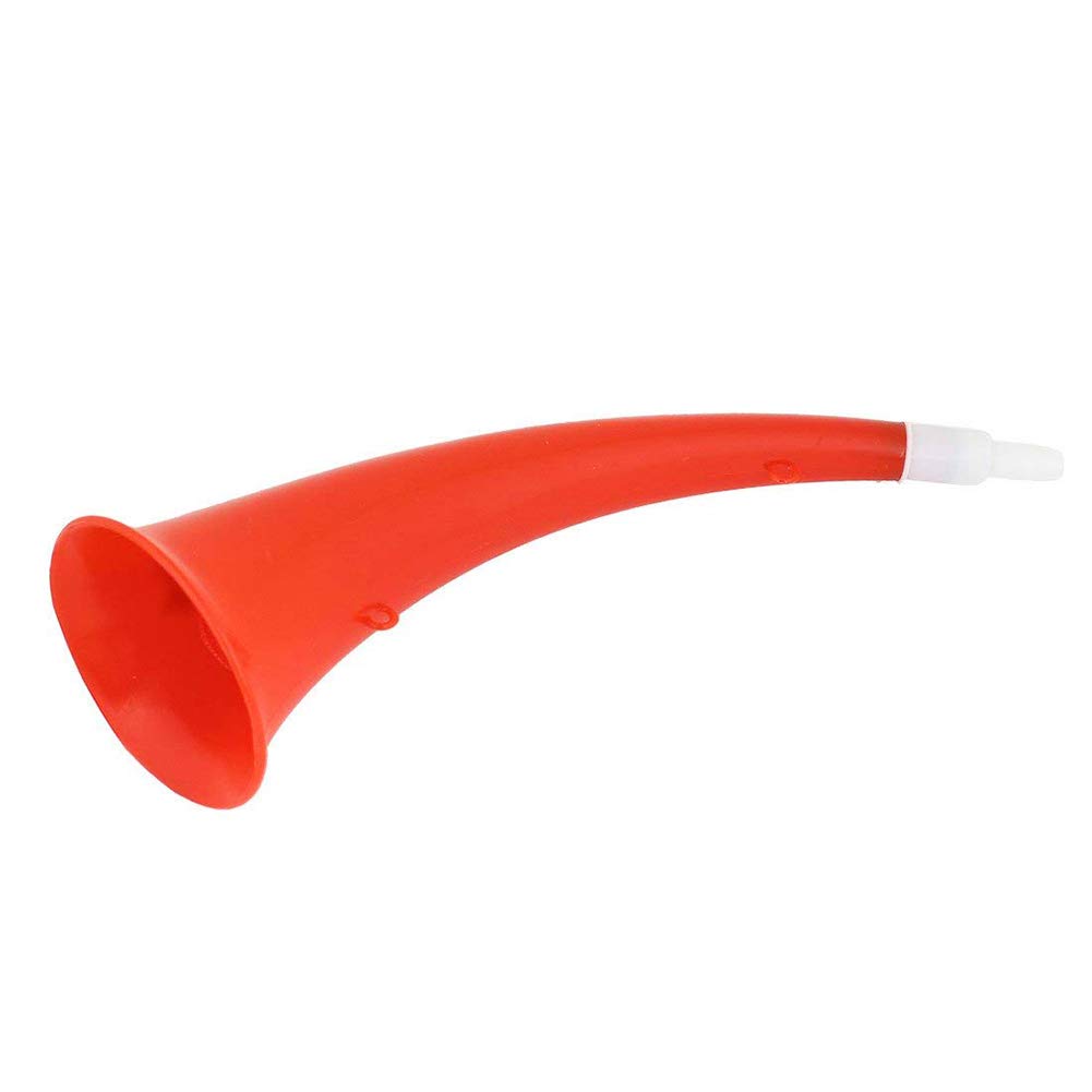

Going to try chopping four of these down to size.
Chopped the toy trumpets (after checking petrol and heat does not dissolve them)... a bit too deep, but adjustment possible.
I decided to cap the random breather and inlet holes for now.
Test fit... won't go over the inlet studs without severe bulkhead bashing.
