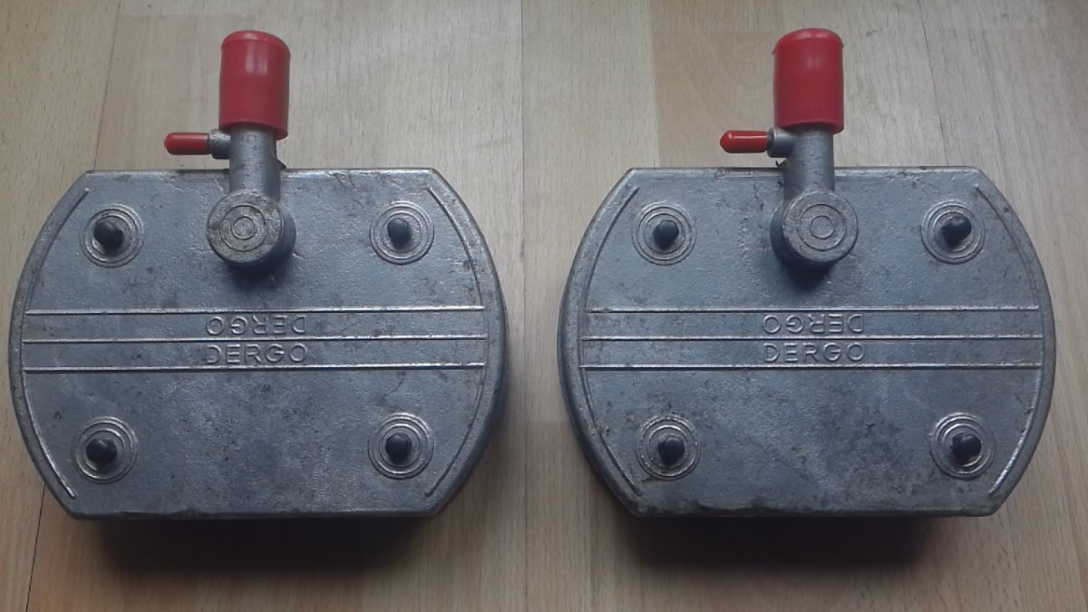

I should retitle this thread
dergo air filter

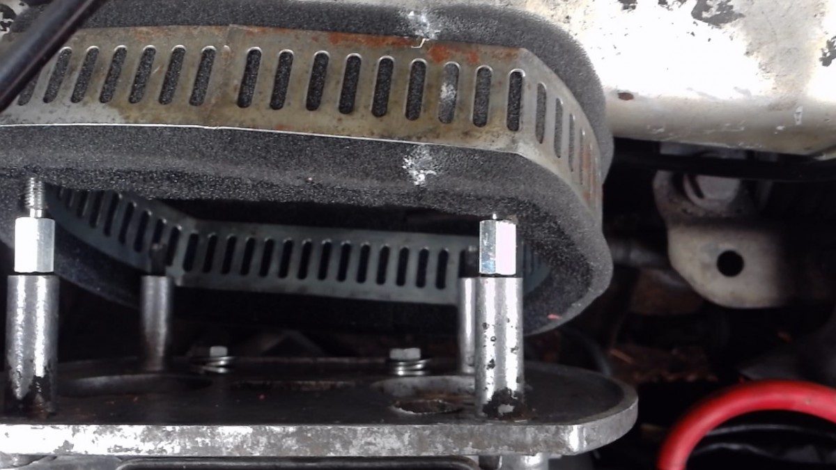

One fell off, shaken loose by fenland roads I think and did not survive the fall or HGV wheels.
Of course it was the one that was easiest to access.
Not the one which requires raising the engine to go through a bulkhead grommet.
