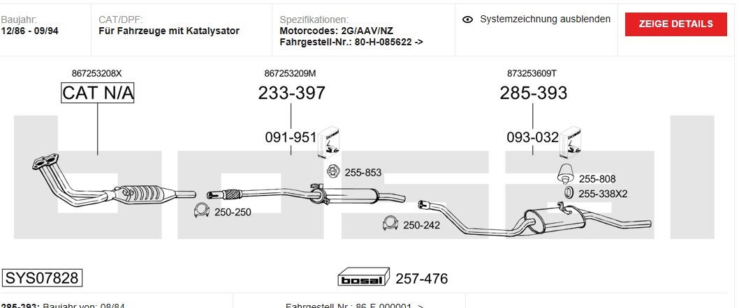

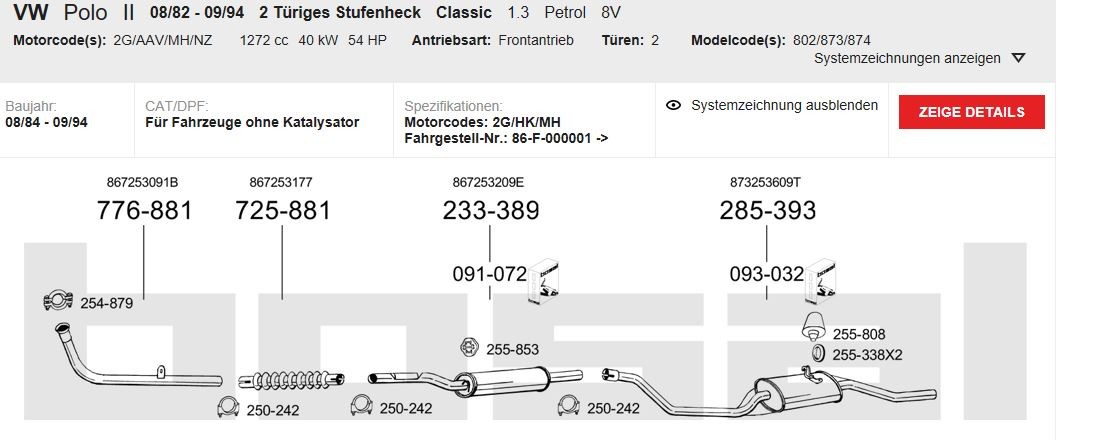

Just a quick question.. about to buy an exhaust that's come off a MK2 breadvan, would it fit on my 2f coupe? Or would I have to make adjustments?
  • Views 1.5k
standard or custom?
Centre box to back of car should be the same for coupe or breadvan..
Saloon is longer.
It's the catalytic convertor and exhaust manifold end that's different at front mk2 versus mk2f.
Look on the Bosal catalogue website for car exhausts and you can check outside diameters at clamp points.
eg 250-242 is 42mm pipe.
