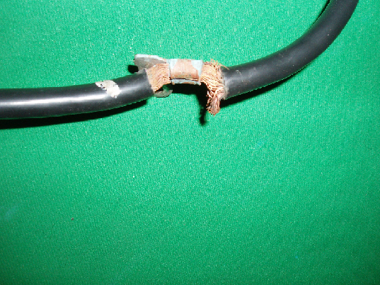

If you wish to test your battery when it is fully charged, connect your multimeter across the battery terminals and ask an assistant to turn the key to the 'start' position - a battery in good condition should maintain a voltage of at least 9.5 v whilst cranking.
You can also use your multimeter to check that those earth connections that you mention - and even the main cable from battery positive to the starter motor are in good condition:
(1) Connect or hold the RED meter probe onto the positive BATTERY terminal (NOT the terminal clamp)
(2) Connect the meter BLACK lead to the starter main terminal (NOT the lug on the cable)
(3) Ask your assistant to turn the key to the 'start' position.
(4) The meter should NOT read above 0.5 volts during this test.
A higher reading indicates a poor connection, so to locate the poor connection, remove the black meter lead from the starter terminal and clip it onto the cable lug, if the reading under load now remains below 0.5 v, the bad connection is between the cable lug and the battery terminal post.
Using the above method, you can work back towards the battery, finishing up with the red meter lead on the battery post and the black lead on the positive clamp.
Earth connections can be checked in the same way, but this time, the meter RED lead is connected to (for example) the engine block and the meter BLACK lead to the battery negative post.(You would still be looking at 0.5v as a MAXIMUM reading.)
What you are measuring here is something called voltage drop, in essence, this means that when you have higher readings, electricity, being lazy stuff, finds it easier to flow through the meter that through the intended route of the cable and its connections.
