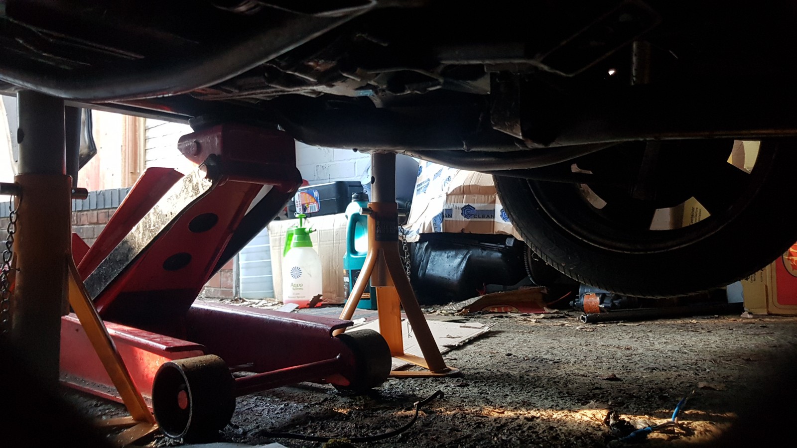

kiran_182
Yeah i use my brick or reverse. This pic is the front frpm the other day
