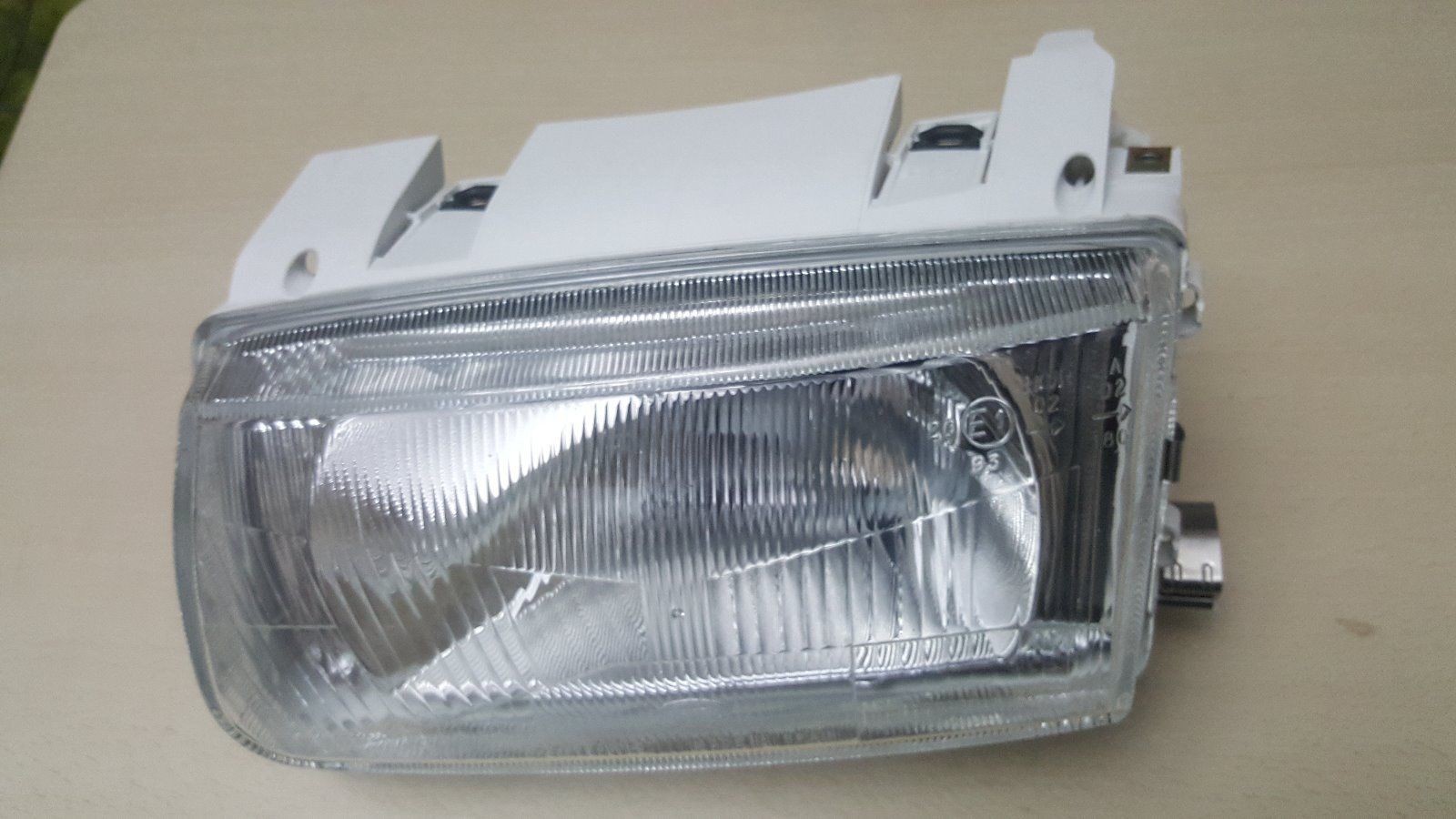

im trying to match brands as im buying new. i found a prasco left handside light from UK.
and a right hand side light from germany
the german ones say it's for left hand drive only, why would that matter?
i checked the cables and the the connectors are identical on either end? one for head light and one for indicator , one for fog
 so can't see how it wouldn't work?
Lhd ones and rhd ones point the beam away from oncoming traffic
Thats why when you take a rhd car to europe you have to put stickers in the beam pattern so you dont dazzle people
A LHD headlight has the light beam cutoff for driving on the other side of the road so it would be an MOT fail as you can't adjust the beam cutoff
aaaah i see.
do the lens glass colour differ from different brands of headlights  for the 6N?
glassmark.thumb.jpg.52429e56db46b8ab520917d362bca7bb.jpg#
the arrow is outwards, for a left hand headlight is this correct
it's fine. facing the kerb. cheers
