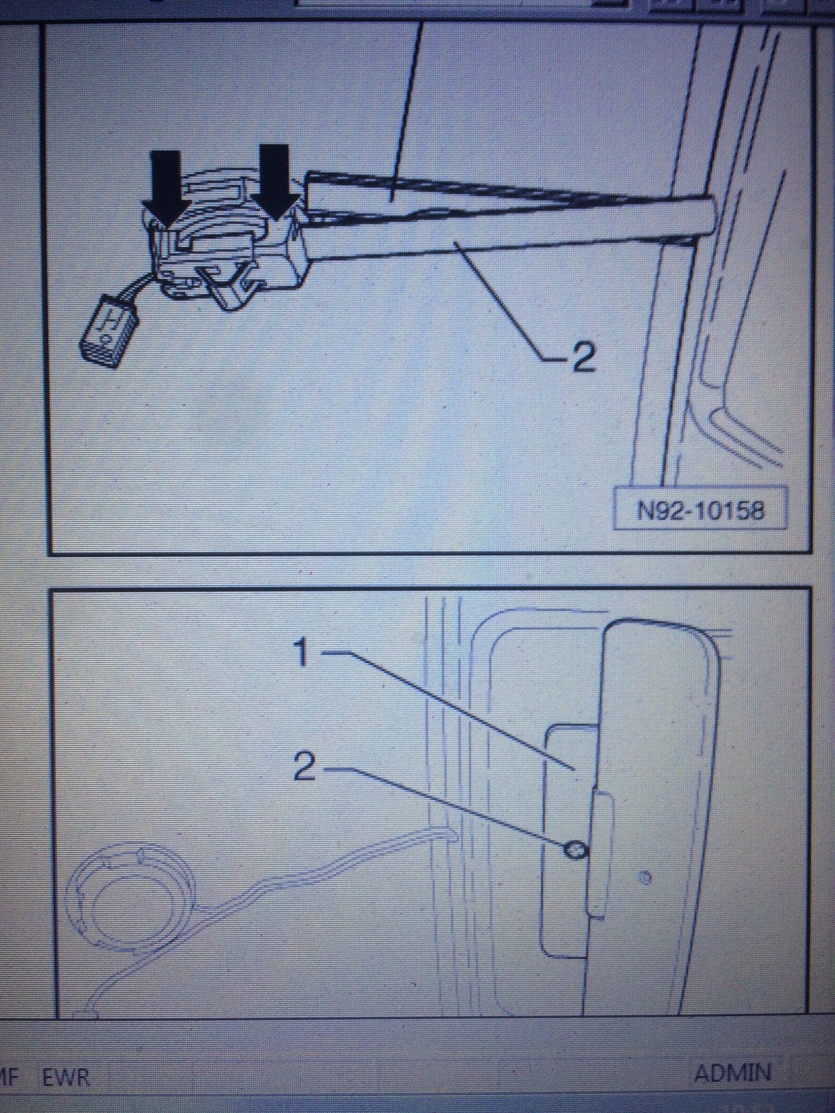

If the rain sensor is fitted it's behind the rearview mirror, a round plastic casing with another plastic cover leading up to the roof lining, it signals direct to the Onboard power supply module, so if it's fitted and faulty you should see it as a fault code.

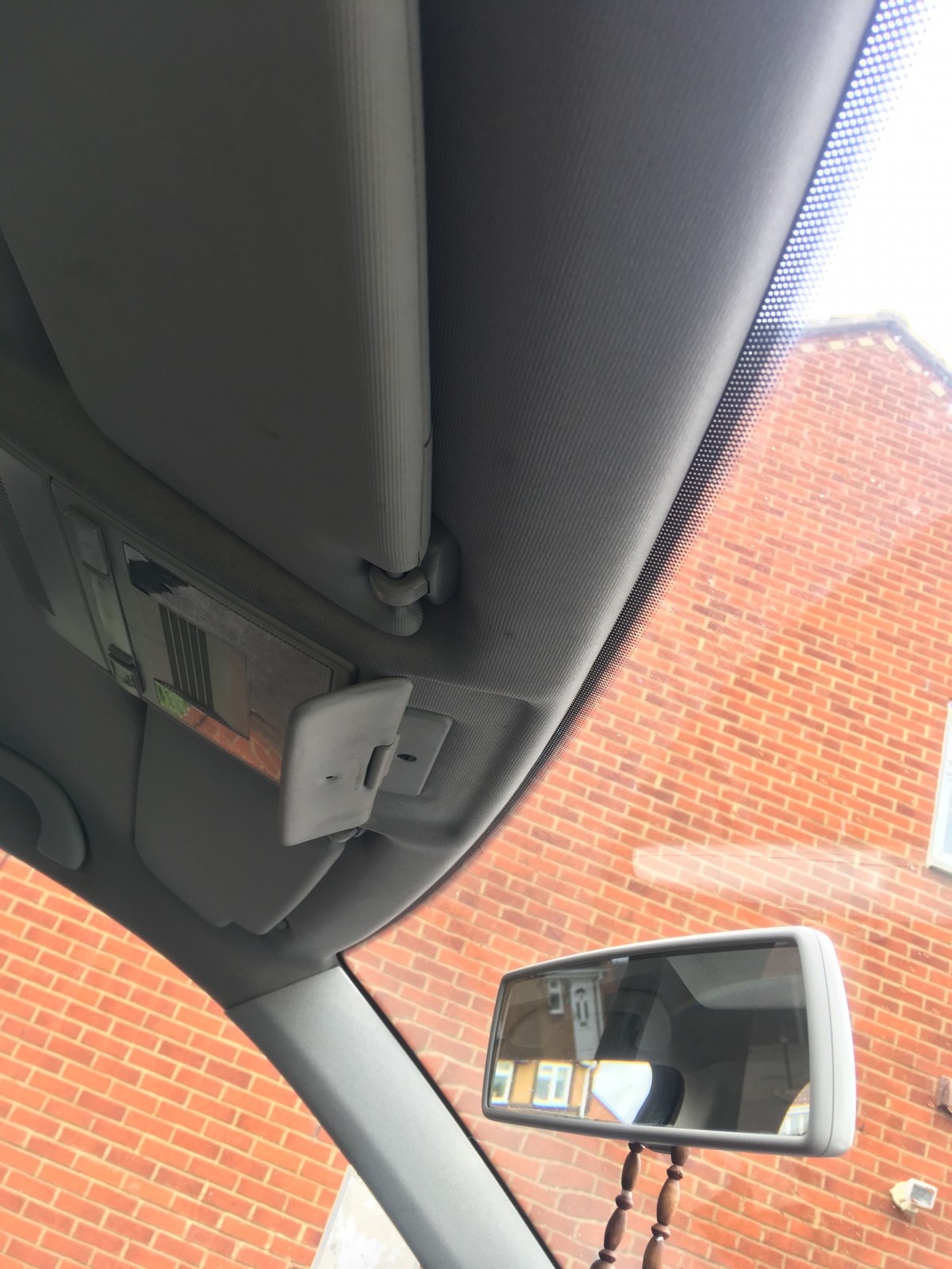

there is nothing extra fitted behind the rear view mirror and no cables / wiring either. I think thats how it came out of the factory but I could be wrong.

and if you drop the interior light light you should also see the 4 pin connector I think they were only an option?

I have checked for rain sensor but cant see anything and looks like it was never factory fitted otherwise there would be some signs of it being removed or similar. So could it possibly be the switch fault or do i look for some relay / fuse etc

nige8021
So it looks like it never had the "Auto wipers"  so if it works in all the other positions there is nothing at fault
