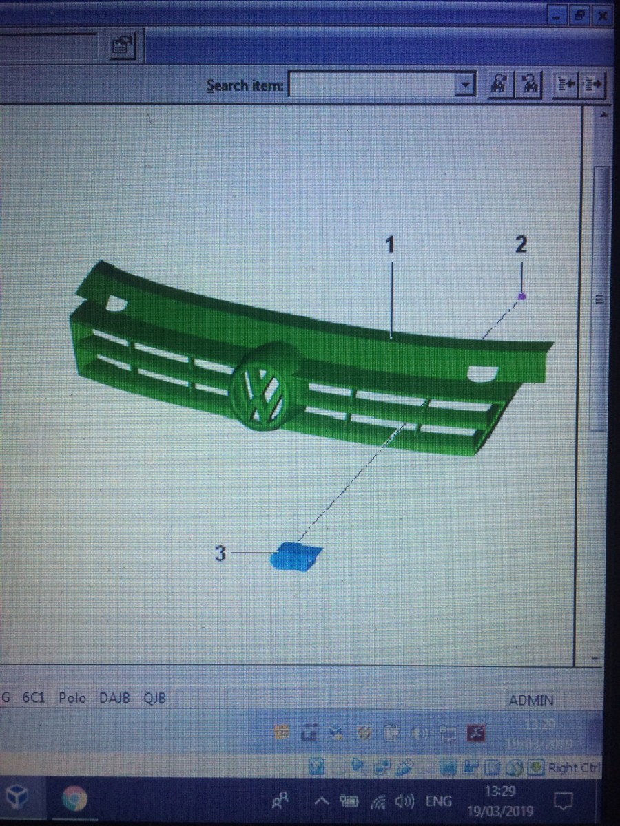

  • Just been looking and there seems to be two versions of the grill ?    the first version appears to be a stick on and its the it’s the second one that needs the grill removed

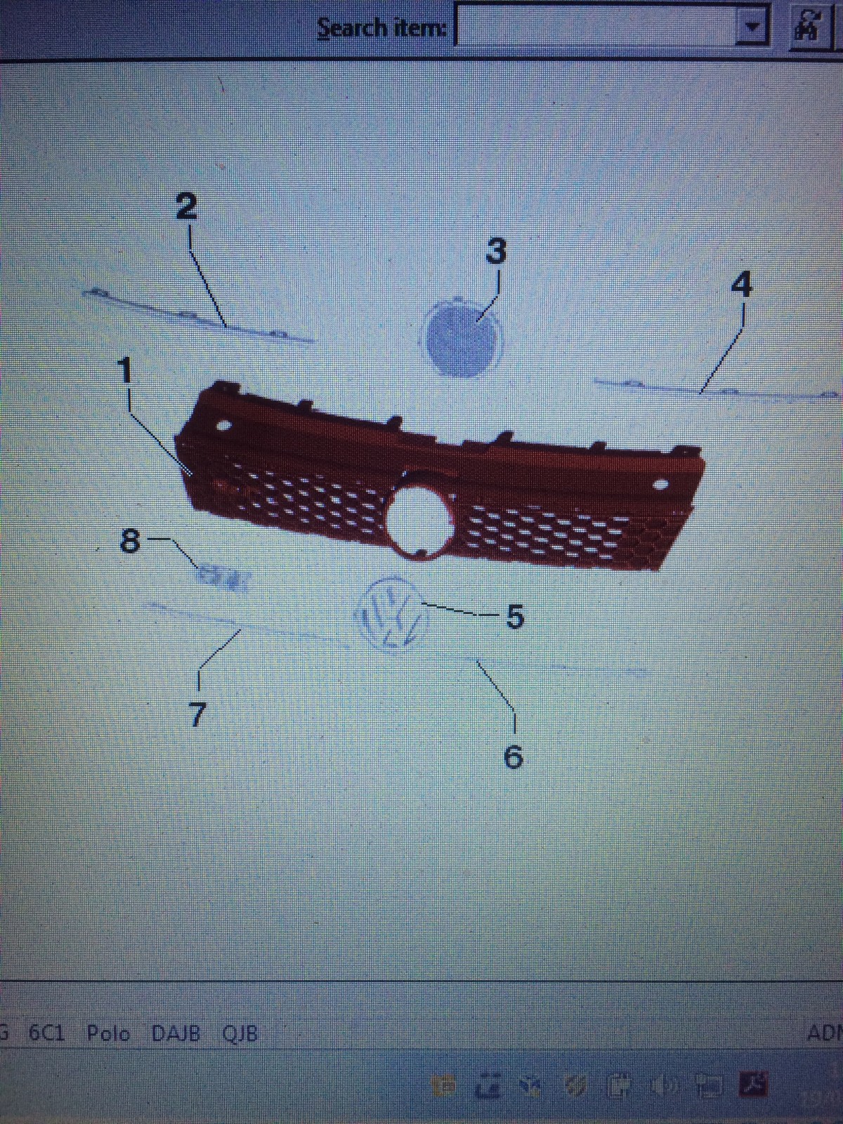

According to the dealers manual, the whole grill does need to come off, two screws on the top and it pulls out, the badge is held in by a screw from the rear

Sorry for the VERY late reply!
Mine looks like the top pic - honeycomb pattern
