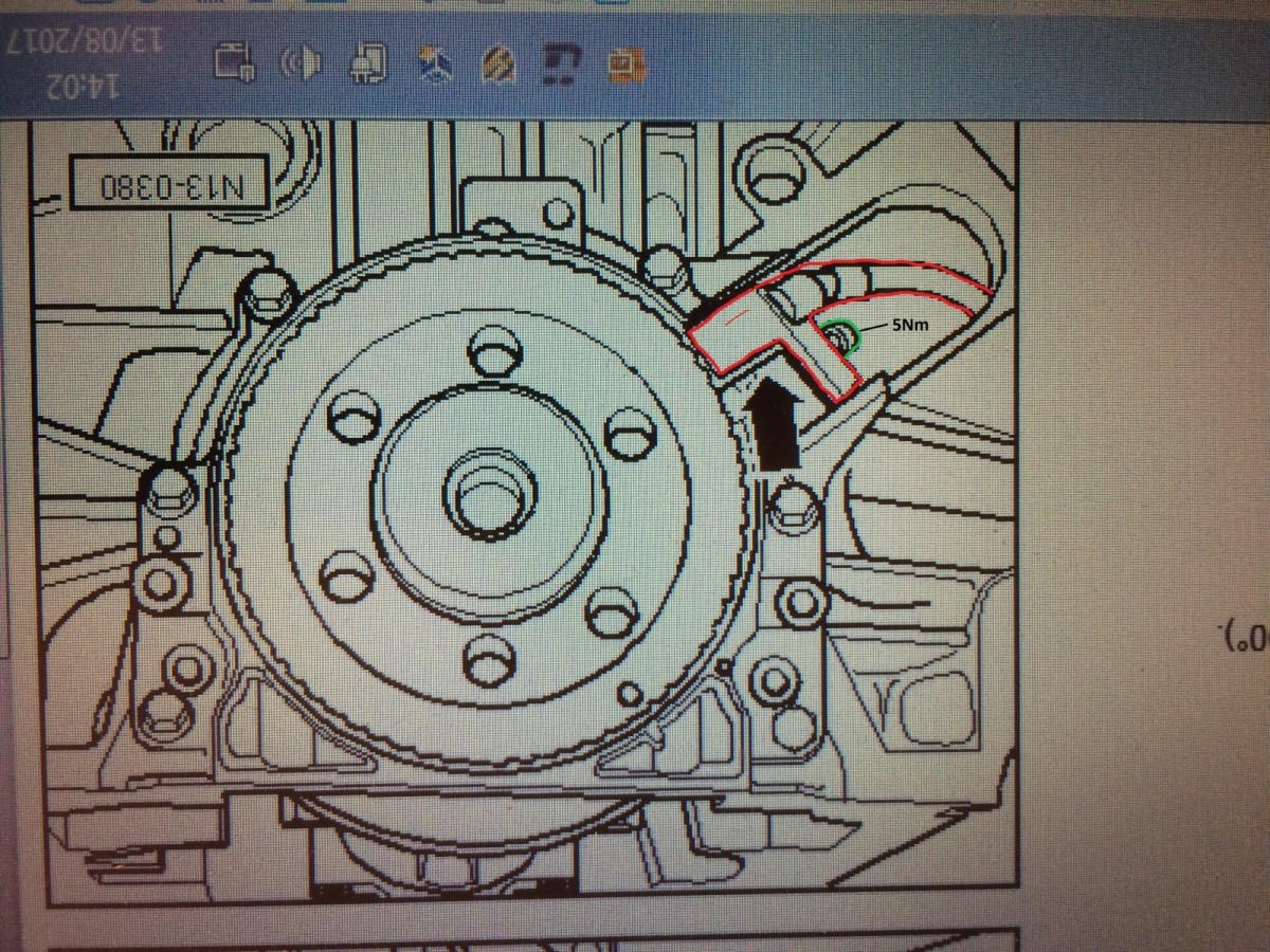

is there a crankshaft sensor? I want to try and clean it - read there could be bits of filings on it?
There is a crankshaft sensor, it's a bit of pig to get at, mounted down where the gearbox and engine bolt together, at the rear of the engine by the starter motor
Here's how to test it 6N2 testing G28CrankSensor.doc  however if it was faulty you would of had a fault code for it and if it's dead the engine shouldn't even start.
