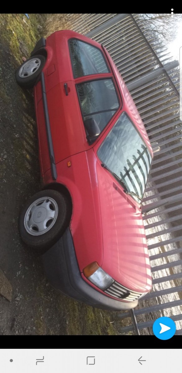

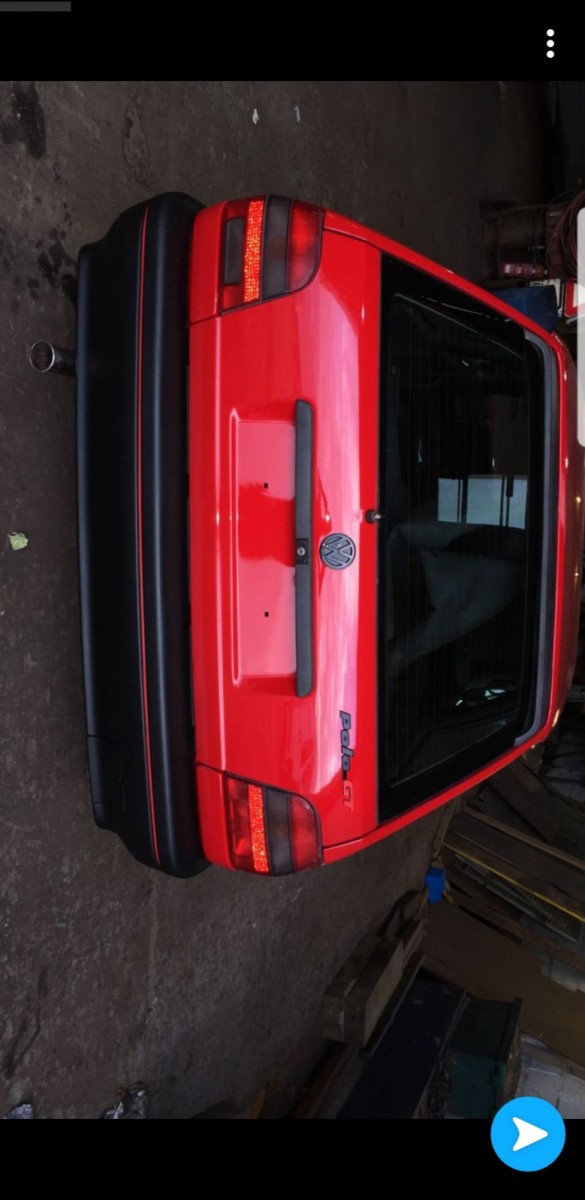

First picture the day I bought it saved from a scrap yard

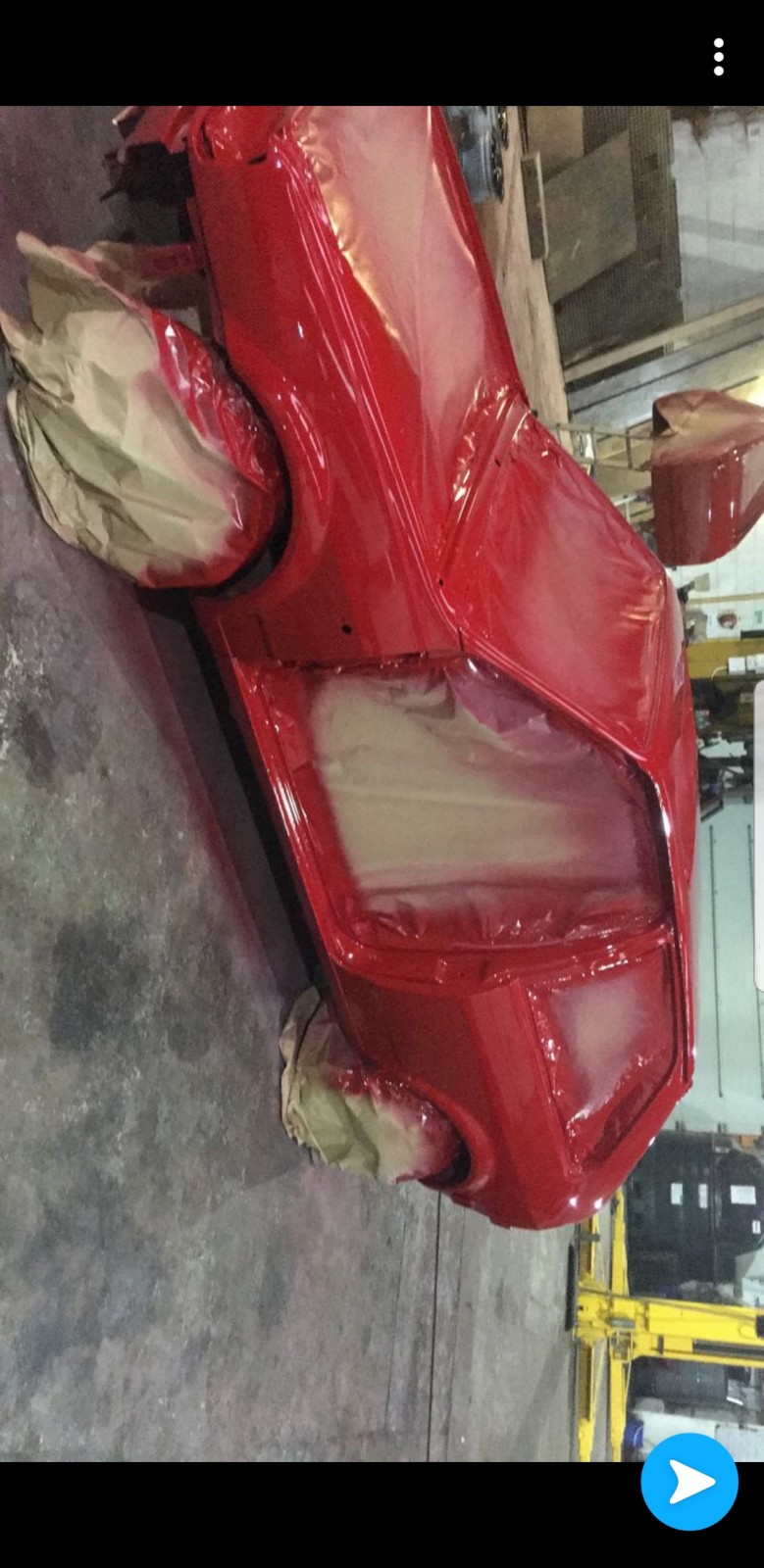

First job was a machine polish to see how well the paint came up, the paint came up very well but was not perfect, so I stripped down car and prepped down for paint and body repairs, a mate that I work with is very good with a spray gun so he resprayed the whole car in the original tornado red (LY3D) this came up very nice and was very pleased with it Screenshot_20181222-061538_Snapchat.thumb.jpg.fbbe08bfa2aaf0735a28f0634fde00f1.jpg

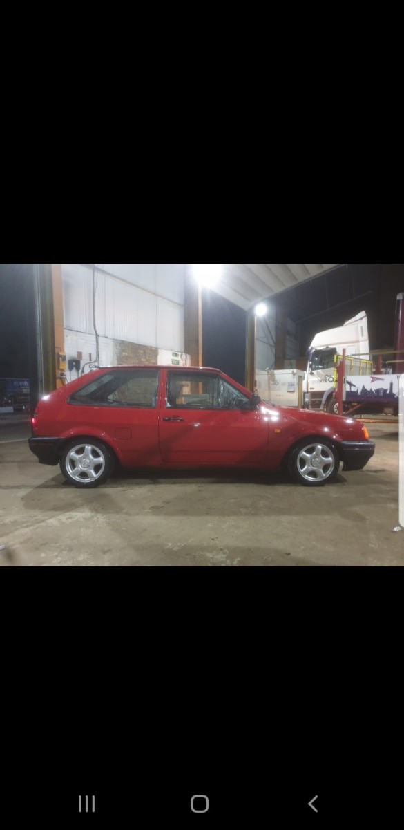

I then built back up car and now definitely looks the part Screenshot_20181115-083800_Snapchat.thumb.jpg.8939c6013a6ab9ecca82f26c030fb2f2.jpg20180817_232111.thumb.jpg.4037178403db9d659afc0308c70c8383.jpg

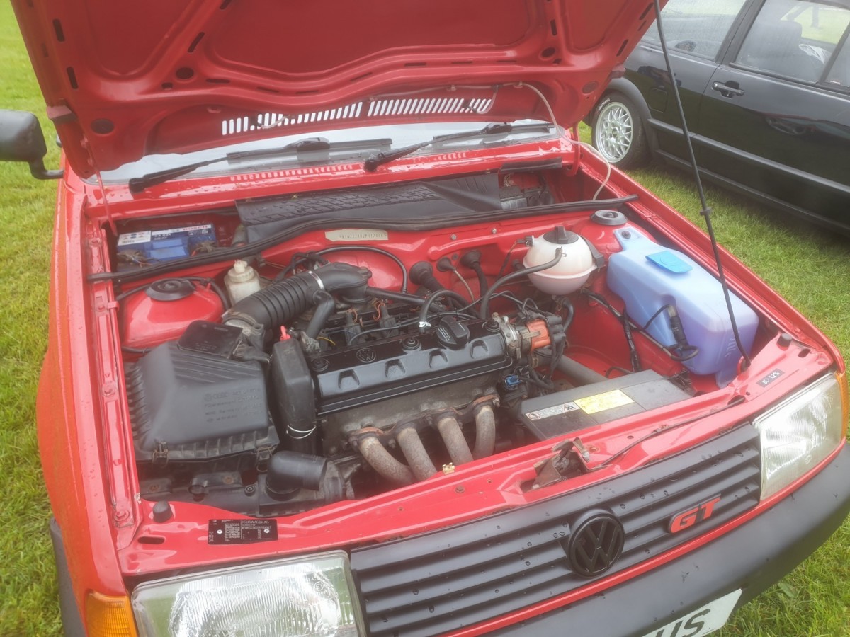

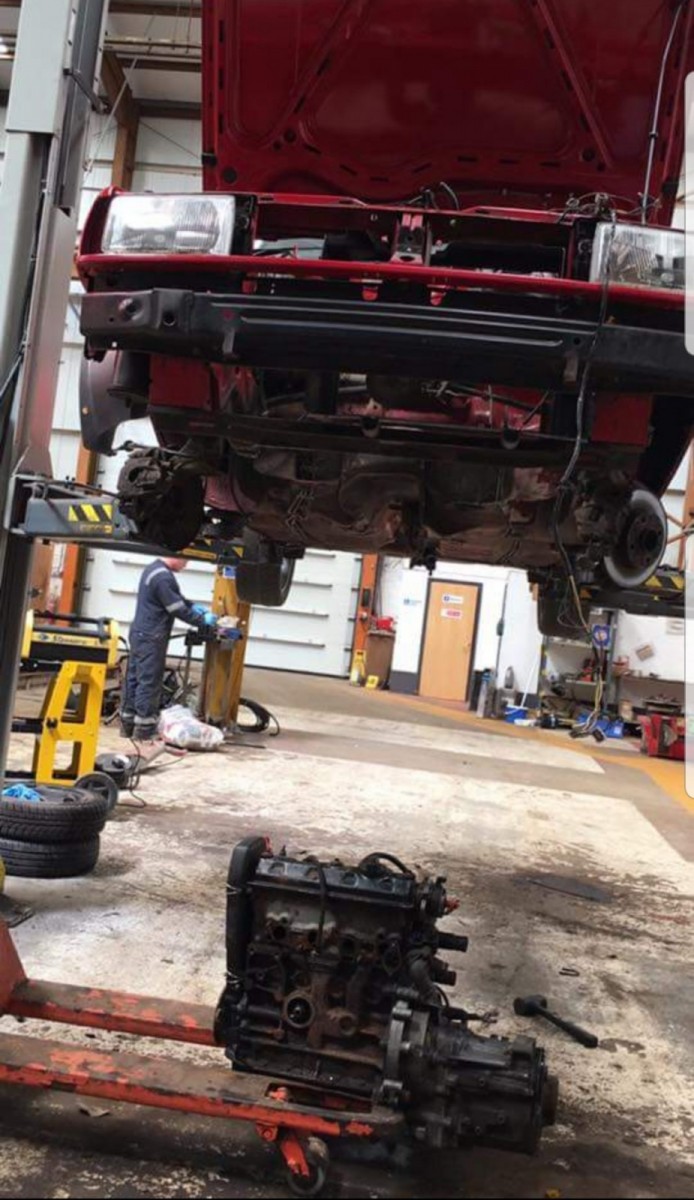

I was then on the hunt for a gt engine and gearbox, I found a mk2 breadvan with them both fitted, paid £600 for the car and came with an ashly 4 branch and a new 5speed antiroll bar,
Got the engine running in my coupe and stripped the rest of breadvan as it was long past it's best, I done the head gasket and timing belt and clutch at same time

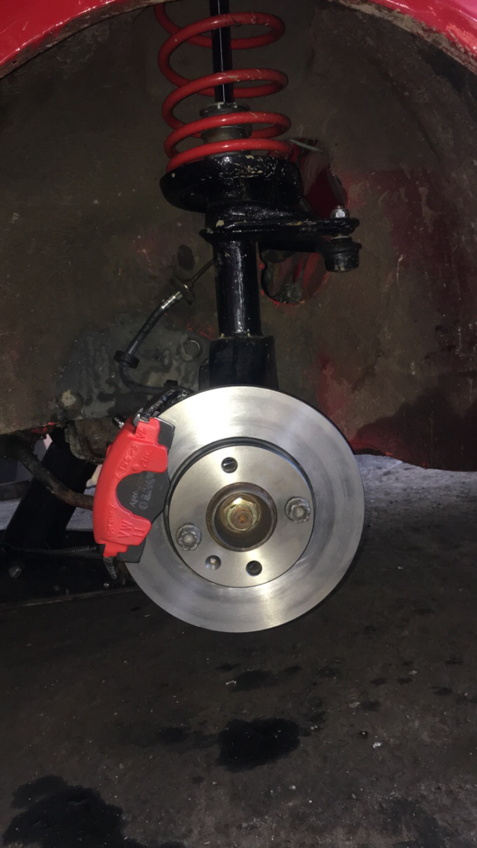

I then decided after upgrading engine it was time to upgrade suspension and brakes as well
I originally went for ta shocks and 60/40 suspension kit shotblasted struts and carriers then painted black, used new vw11 calipers which I painted red and went for g40 pads and  vented discs, wheel bearings were also changed at same time along with steering arms and bottom arms and antiroll bar blocks

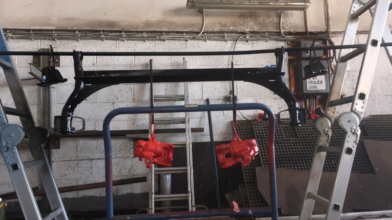

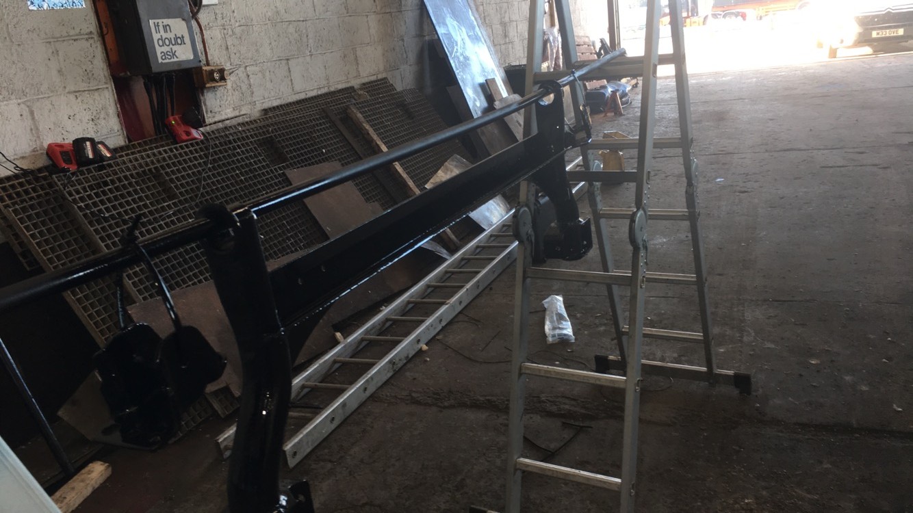

I then fancied putting calipers on the rear as well so removed axel shotblasted and painted it
I went for the mk2 golf GTI rear setup
With the stub axles caliper carriers, calipers, discs and pads, used the normal polo cables with the cable extender on the caliper.

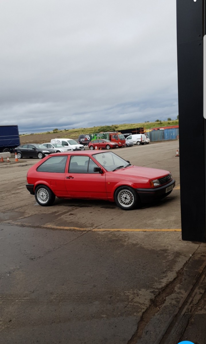

It is now an on going fun project and do small bits every now and then but still alot to do to be perfect.
She now sits on 14 inch mk4 polo GTI 16v wheels and 195/45/14 Falken tyres and love them

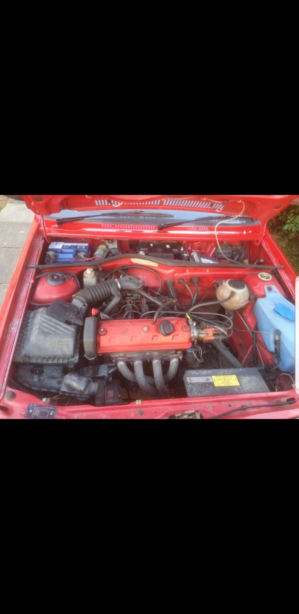

    paid alot of attention to engine bay to get it back to factory standard and very pleased with it now

20190526_124303.thumb.jpg.445fcc249e2b89b1646ec9e7a7a19f91.jpgpaid alot of attention to engine bay to get it back to factory standard and very pleased with it now

Do you have the cold air feed from the grill
Cheers man
Yeah looking around for one
Nope, still looking for one lol

Ive got some under bonnet sound deadening and a cold air feed going
Got any pics ?
