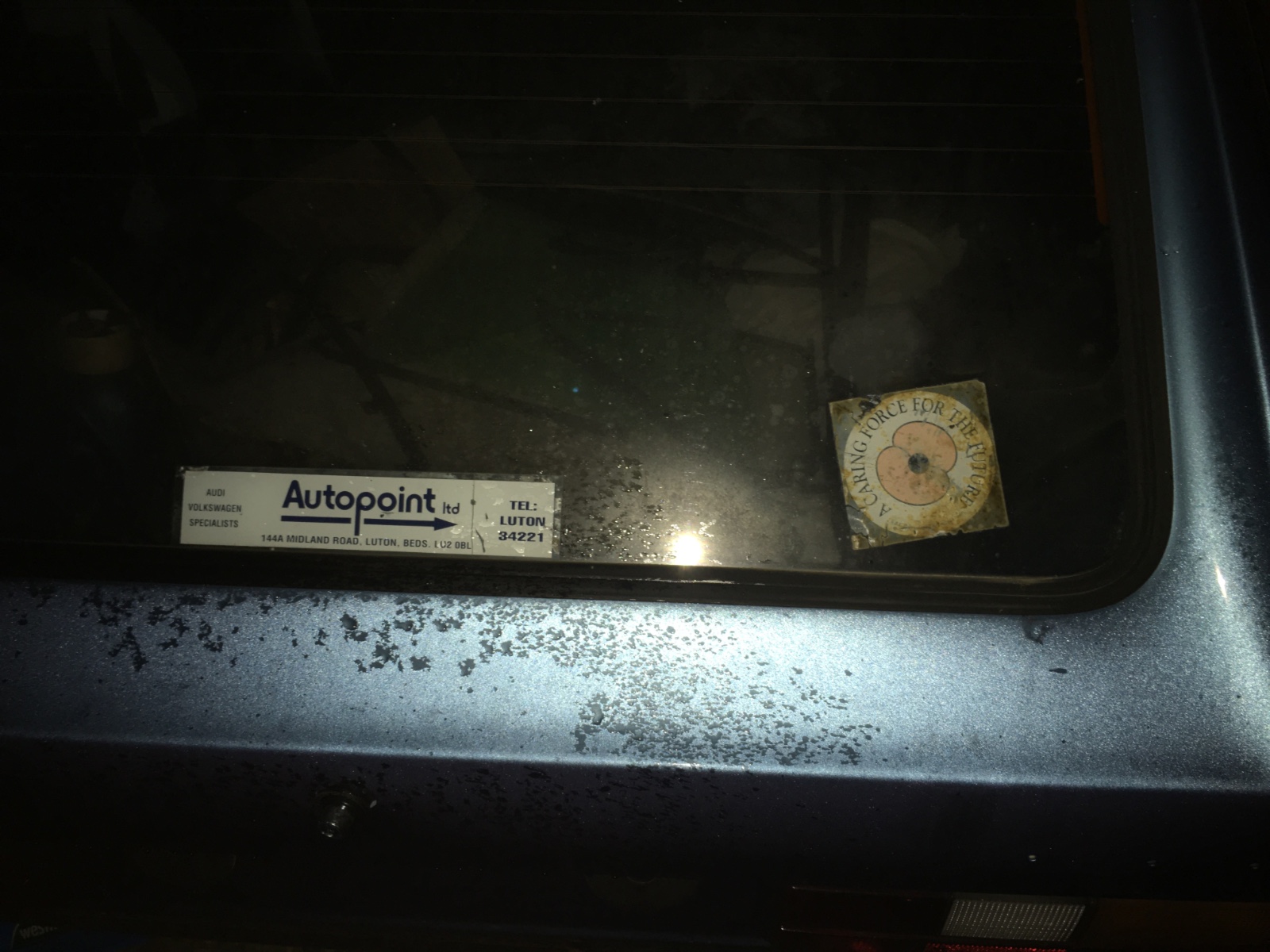

I didn't post it on this thread but it was on my Insta @stuartcturner that back when I was initially stripping the car down in March 2019 found something in the rear inner wing. Reaching down into the wing I pulled out a folded up sticker about 1cm wide by 5cm long. I unraveled it to find most of the old dealership sticker that would have been in the rear window. A lot of the graphic had transferred whist being stuck to itself making it difficult to read and part of the dealer name was missing. I tried to find the full name of the dealer but no joy until last month when I tried cleaning it up with some meths to remove the consfusing transferred lettering. I posted the cleaned up sticker on the Mk1 Golf OC page and someone was able to ID it for me from a period dealer directory. Even better @Lovejoy offered to replicate the design for me so I can have one made by @stickerblimp  and put back in the rear window,
legend!
Edited by foreststu
Nice one! My '82 Mk1 Golf still has the original dealer sticker (Also Luton!). I haven't decided whether to leave it as it is or replicate it as it's quite tired looking. Interested to see how yours comes out
@setch Wow awesome, is it the same as mine, Highway Motors, but with Luton at the bottom instead of Dunstable?
Edited by foreststu
No, mine is autopoint. Also has an old British legion sticker in. I want to leave them in to maintain a bit of originality after the respray but torn whether to refresh as they stand out a bit now
@setch Get a thread up in the non-polo rides and lets see the Golf progress, while you're at it get the Polo up too. I'd definitely keep the dealer sticker but lose the poppy as its a bit far gone and they like you to keep buying new ones don't they, conscience sorted!
