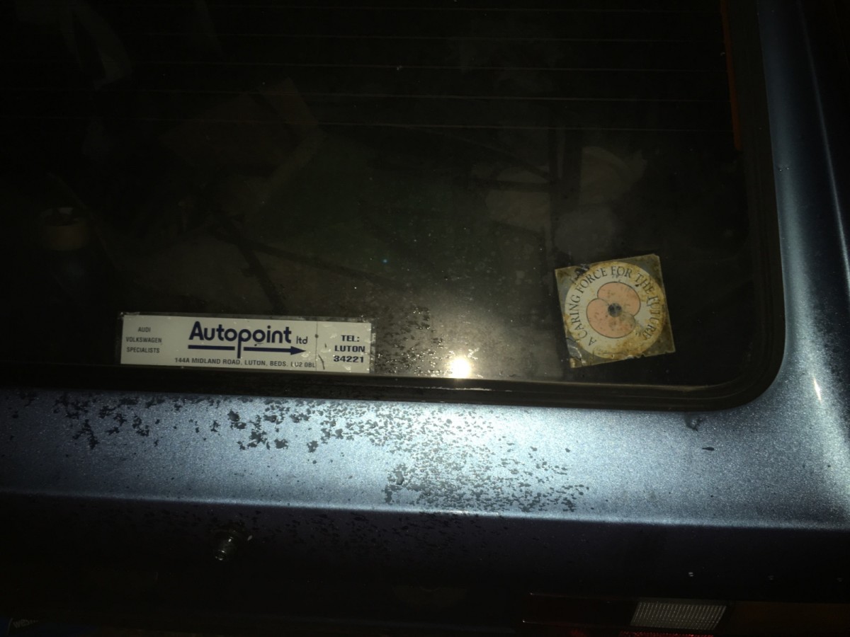

So I managed to get the chrome trim into the front and rear screen seals with plenty of soapy water. I'd also fitted the dealer sticker that @Lovejoy kindly remade for me based on the screwed-up fragment I found in the rear inner wing 2 years ago. Also a Ziebart Rustproofing shield sticker just as a joke considering how rusty this thing was (well it makes me laugh).

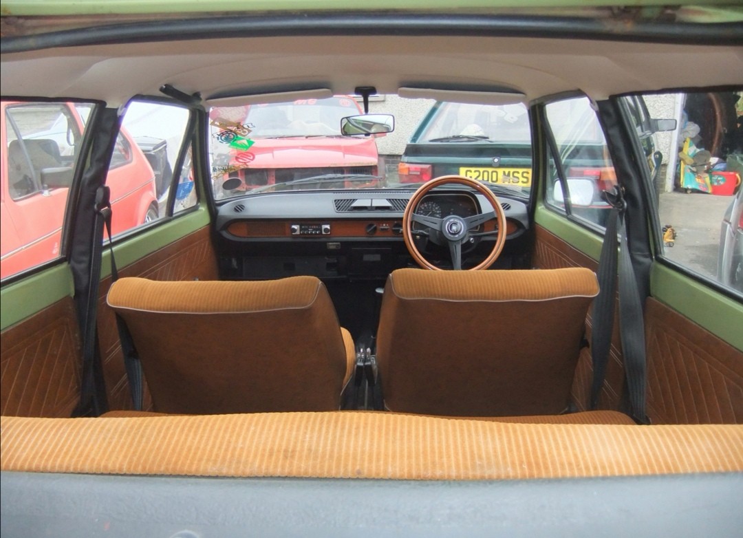

I did a little mid-week job cleaning up the Tobacco corduroy seats with some foam cleaner. Not sure how effective the cleaner was really or if just any cleaning would have had the same effect.
Drivers seat before:
During:
After:
Overall the material is cleaner although that has the effect of making more stubborn/permanent stains stand out!

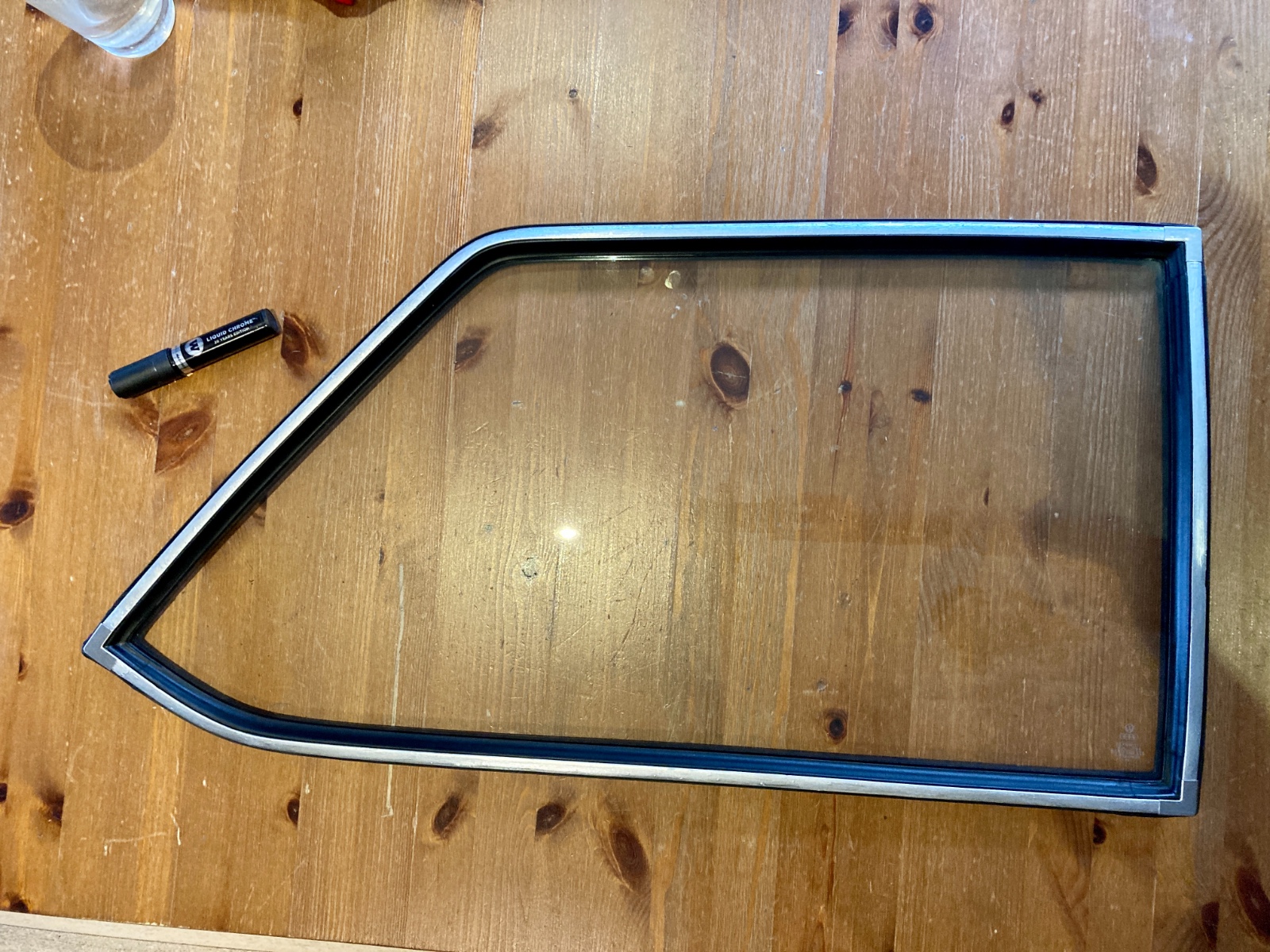

Next up was a lot of hard graft finding. I wasn't happy with the material condition of the rear side window chrome trims which I'd improved using the chrome effect graffiti marker. There are three types of this trims; 1974 Audi 50 ones which are 4 pieces of stainless steel with overlapping corners rather than separate corner pieces, the use of 4 pieces creates a corner at the top which is also present in the rubber seal. The next two types are both 3 piece sets with the top corner replaced by a bend in the trim and the seal plus separate corner pieces. The corner pieces are the same stainless items through out but 1975-1977 trims are themselves also made of stainless whilst 1977-1981 are plastic which suffers from degradation. After 2 months or reasonably intensive searching (mostly the middle 4-week period) I managed to find a set of the 1975-1976 stainless trims to replace my damaged plastic ones and they look much cleaner.
