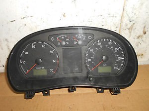

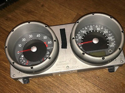

As you have a W reg (2000) it might be one of the last 6N1's or an 6N2 so without that info it's not possible to advise on what the fuse locations are if the door wiring is OK,  the easy way to tell what model you have is the speedo unit, are the water temperature & fuel gauges between the rev counter and the speedo or are they within the rev counter gauge
