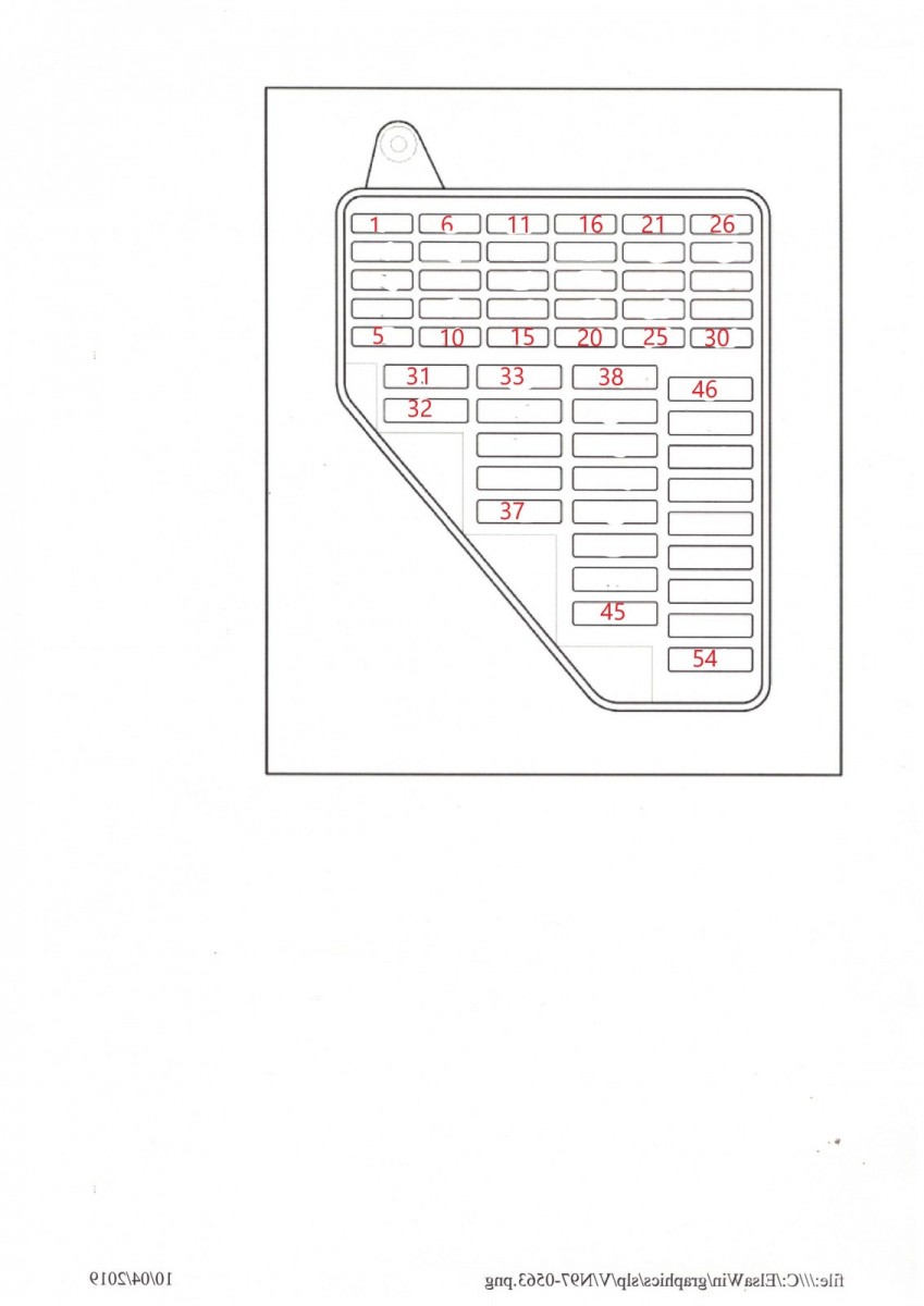

Can you show me a fuse box layout please to enable me to identify fuse No 7 easily,
The Pump and control module are all in the one unit #4 in this picture

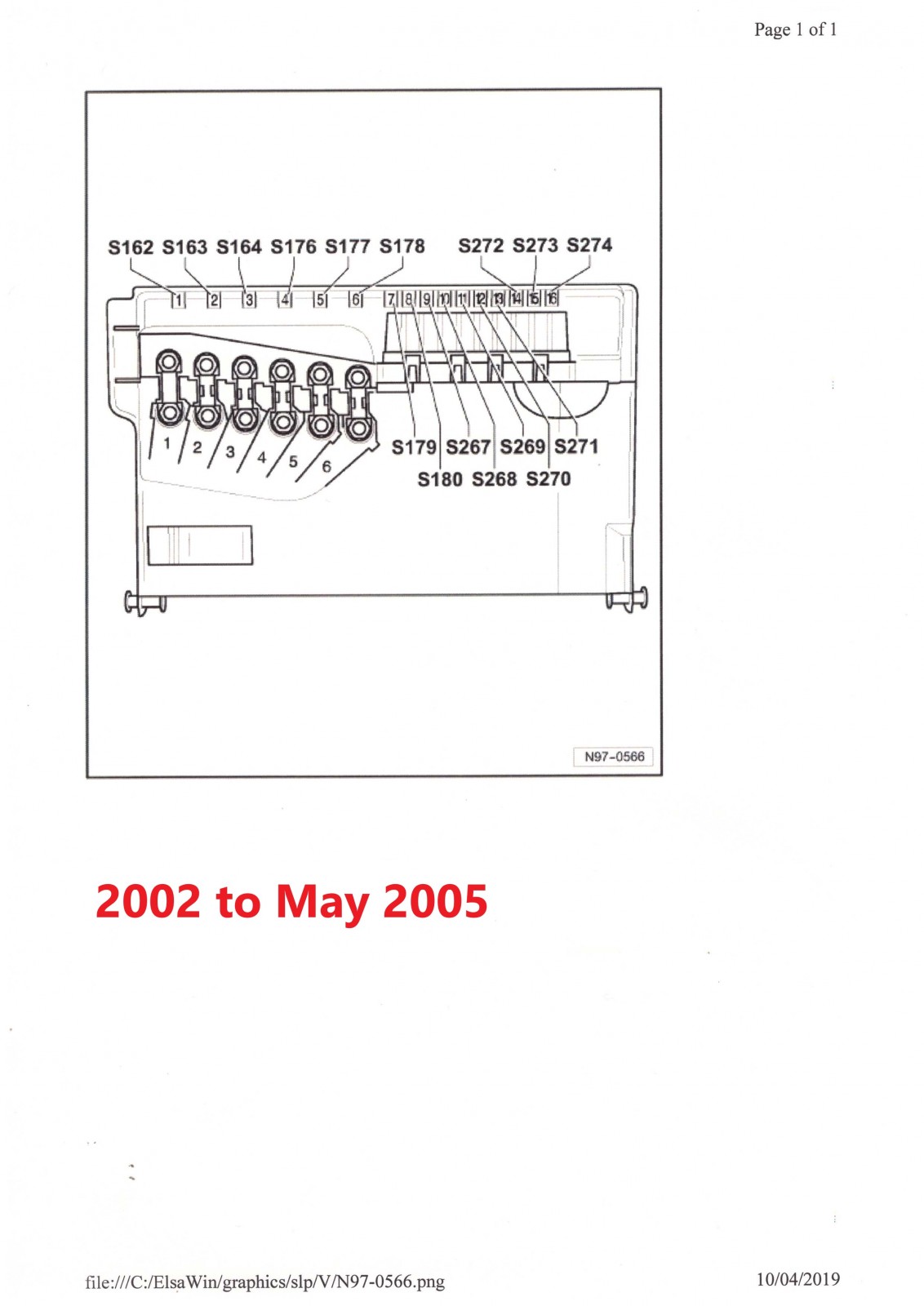

352834272_9N1InteriorFusebox.thumb.jpg.e85e7b8ea4aaff1a5ff9cb19f999ea4c.jpg488949980_9N1BatteryFusestoMay05.thumb.jpg.da8d5937e56544ecde362074e16f5d3c.jpg
On this layout it's fuse S164
1443174317_9N1BatteryFusesMay05toNov05.thumb.jpg.6fe7fe8194103d44b2975143d7658712.jpg
On this layout it's fuse S177
