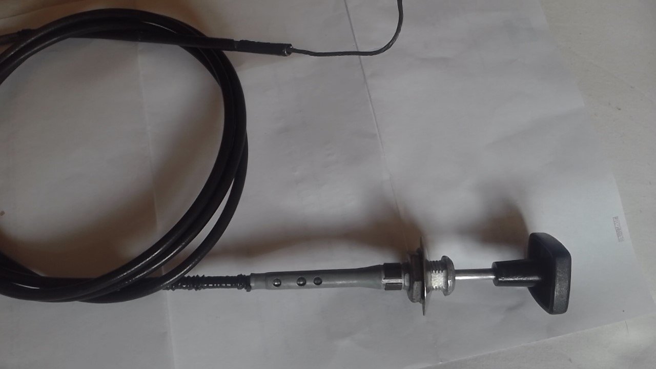

is it long on a lhd ?  ive got a proper vw that operates the dash light , would donate it but suspect its too short
With a Weber it needs 4 feet of cable. With the dellos about 30 inches.
Thanks for the offer. No worries - found one in my box of bits from some Japanese car, with a microswitch.
It's got bullet connectors, so I'll have to bodge something to connect to the 2pin socket with red/brown and brown wire (from reading Haynes)

and its missing the knob
191711503A the knob part number.
1H0711558 and the required clip!
