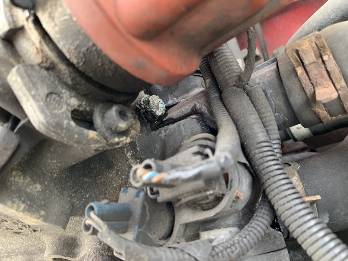

Hi all I have a 1994 MK2F 1.3 Genesis and have noticed this little leak from the engine - what are people’s thoughts on what the cause is?
I think it may be the thermostat housing?
coolant level and temperature are all fine so no overheating issue.

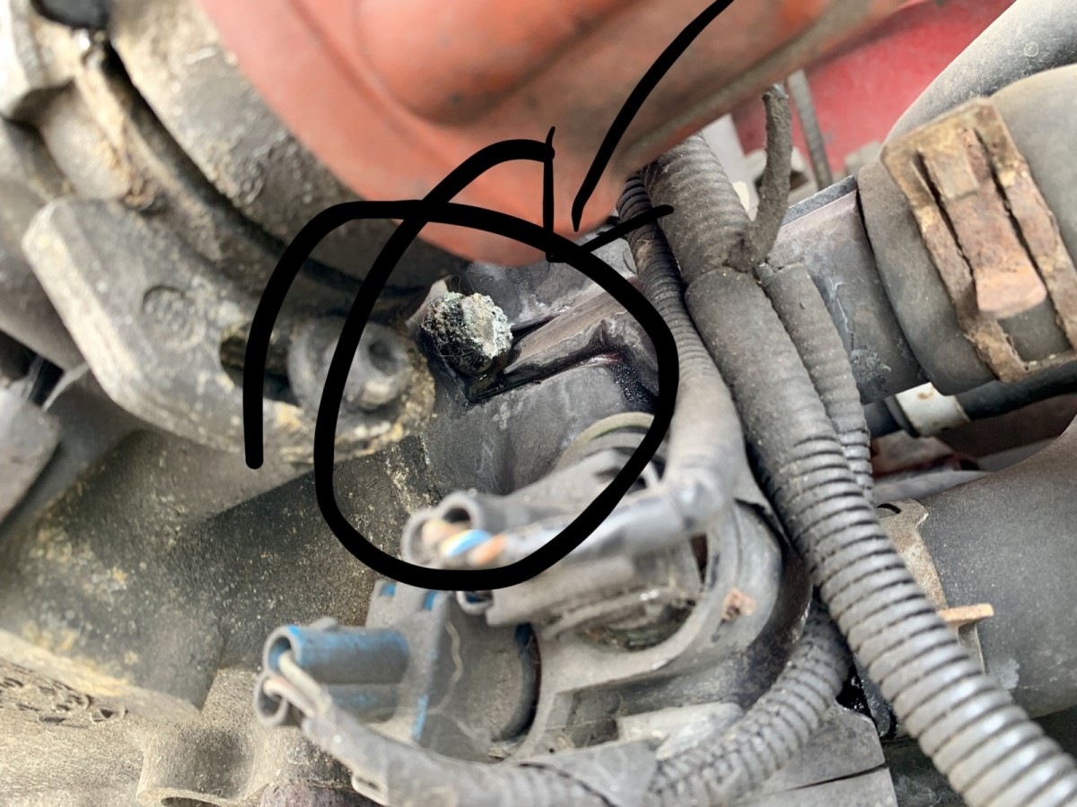

Here’s a better picture!
yeah go for a thermostat housing

Thanks, I’ve got the housing part ready so I’ll drop that in hopefully at the weekend and see.
got the o ring to go with it ?

The gasket? Have got that as well and was going to get a new thermostat if I’m going to be in there anyway?
the gasket is a rubber  O ring ...chances are the 2 sensor seals will need replacing too
id leave the stat personally if its been running ok...aftermarket ones can be terrible quality

Cheers, I’ll have a look at a couple sensor seals.
Seems to be running all okay so will leave the stat as you say.
