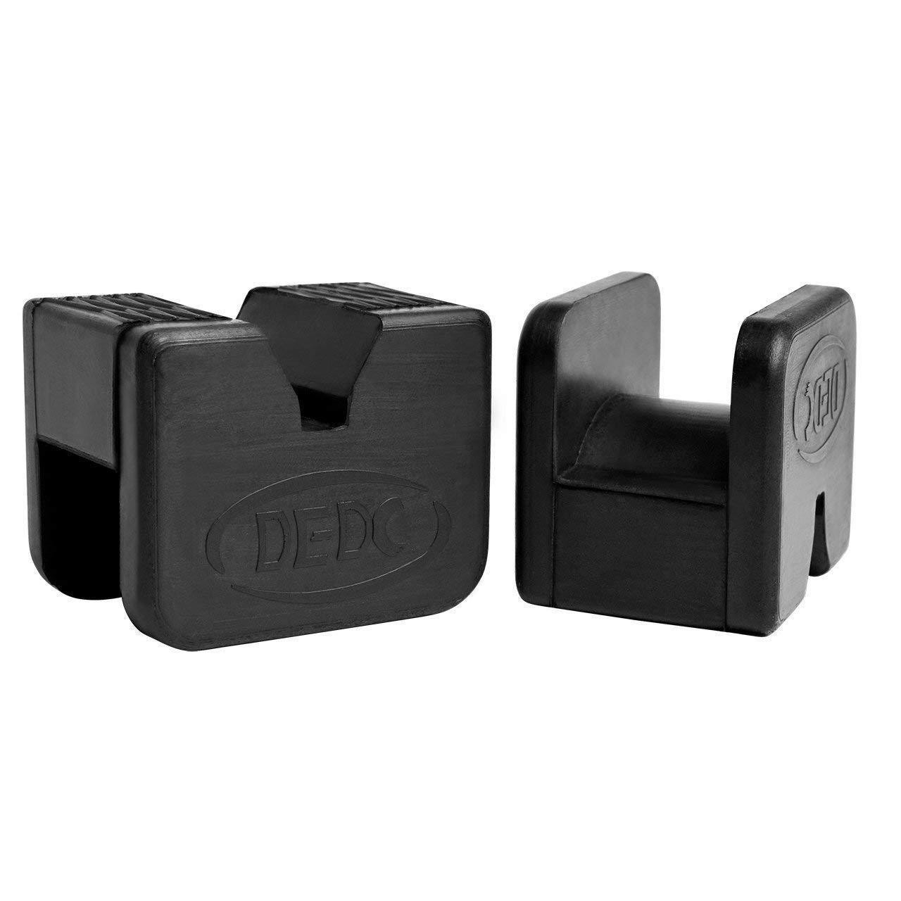

I would recommend NOT jacking on the 'axle' - As it is of 'U' section rather than cylindrical (as it appears to be when viewed from behind the car), there is a risk of distorting it when jacking on it.
I obtained a block of aluminium and cut a cross in one face to fit the jack turntable, then cut a groove in the other side and screwed some plywood strips to it, the object being to avoid the weight of the car resting on the weld of the sills. - The wood providing something of a cushion to avoid damage to paintwork.

i did jack in centre of axle n quickly got the stands on either side of car in thier proper posistion, to avoid sills bending im using these rubber blocks which fit pretty good
