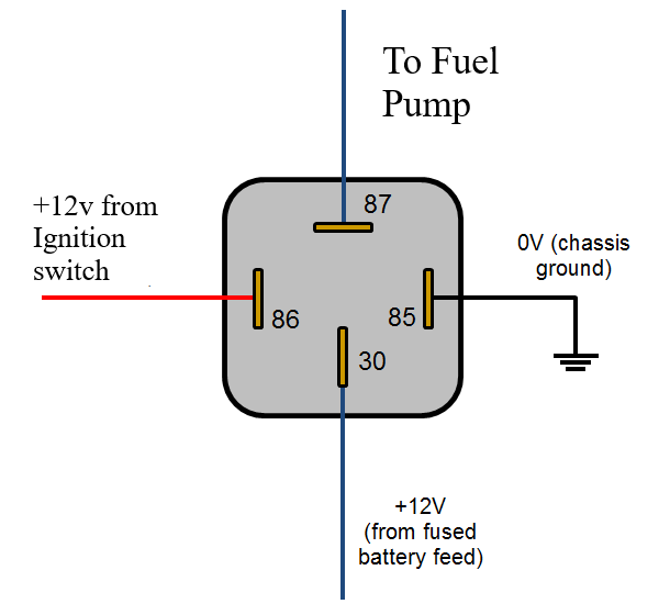

This is the connection layout for a standard relay, and the link wire @steveo3002 mentions would go between the pin 30 and 87
Excellent help much appreciated!

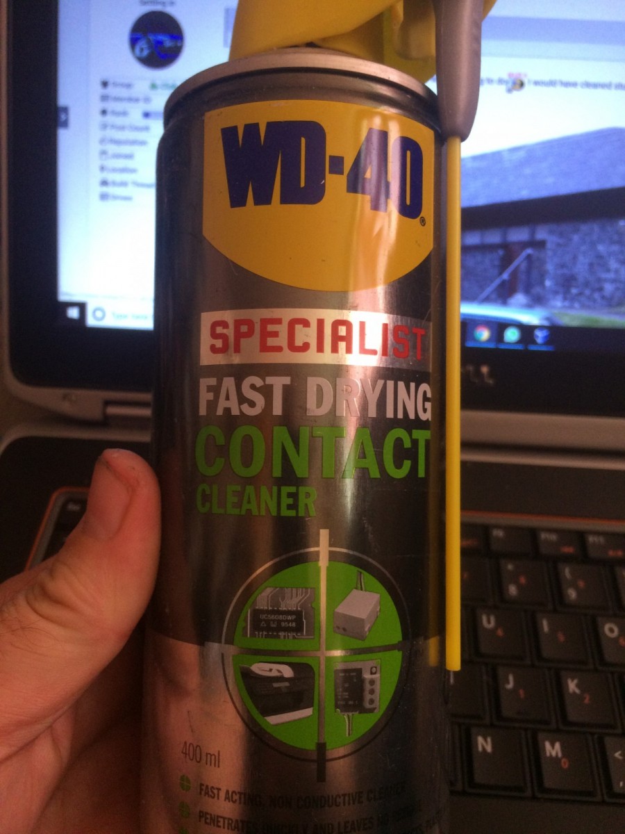

Use something like this to clean the contacts 533A13FD-AB95-40C5-8560-EE736004B973.thumb.jpeg.85e666cf0c329255e755298c9032a114.jpeg
but under no no circumstances use copper grease as the copper particles in it make it conducive and could lead to a short circuit only use something like silicone grease or Vaseline to keep the moisture away
idealy  need to depin the housing so you can see the terminal close up , recrimp on a new one if needed
dielectric grease is the stuff to protect it once its clean , it wont repair a dirty/correded pin though
Cheers dudes!
I've some electrical contact cleaner here was just to protect from moisture again.
