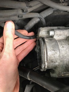

Just discovered a hole in my #2 vacuum pipe. Would that be the problem? throttle actuator seems to be working AOK!
Temporarily fixed this hole, but still no luck - starts but stalls immediately with fuse F14 in with no apparent error codes. Despite the battery previously having died from all the attempted starts, I don’t think it’s the immobiliser (although all the advice online for this fault says it’s this) - there’s no key icon on the dash when I try to start. Feels like I’m running into a dead end and wonder if it’s worth disconnecting and reconnecting the battery (potential fix for immobiliser). Would it be worth putting the old cam sensor back on to see if the new one’s bad / incompatible?

Current status: battery seems to be draining quickly and failing to charge with fuse F14 replaced (drained to almost nothing while left standing, had it on charge over the weekend with barely any power increase). I think the new camshaft position sensor may be causing the immediate stall at startup. Apparently the camshaft position sensor (hall sender?) is also on fuse F14, so may not have required replacement in the first place. Intake manifold seems to be working fine. There is a small nick in #2 vac line, which will need repair - temporary fix didn't last long, but temporary repair didn't seem to help.
