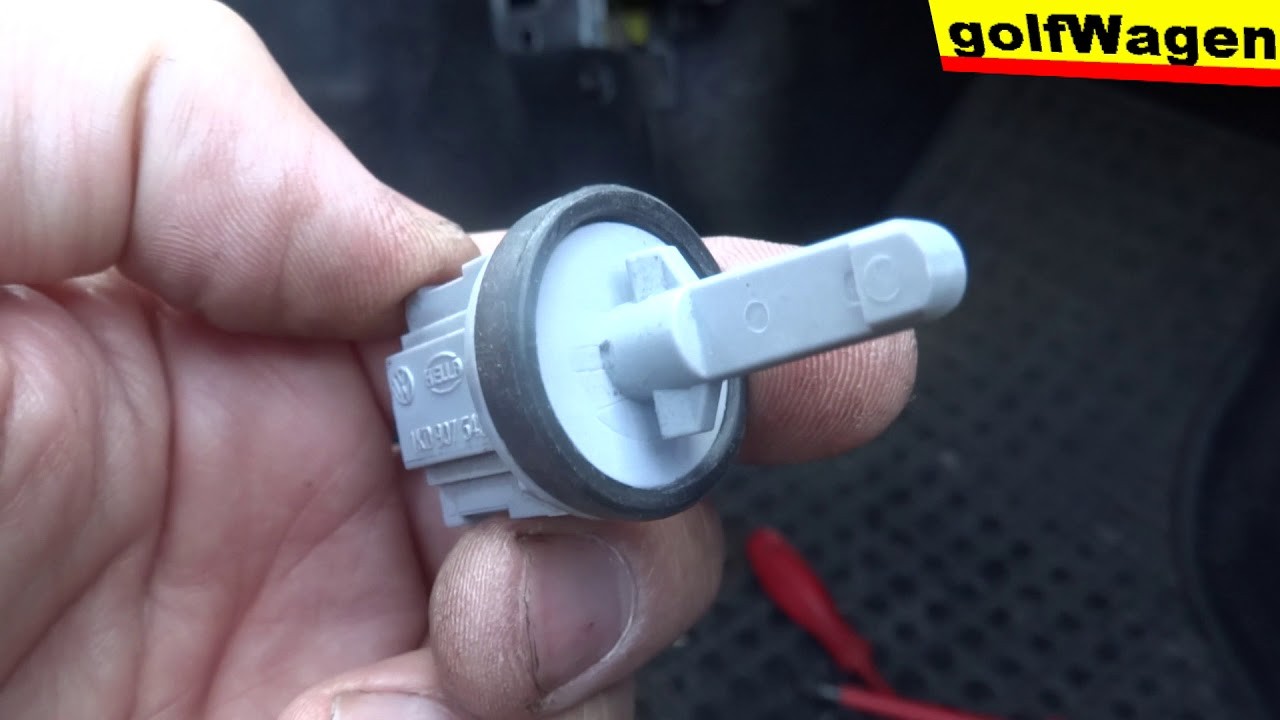

Been looking at the dealer manuals and there is no mention on how to remove it, or exactly where it is mounted, in the wiring diagrams it just says "under the dash" as it's in the inlet, I can only assume it's just below where the polen filter connects to the ducting ??
Okay will have a look in the morning, do you know the part number?
Looking at the google images of it
It appears to be a simple twist to remove/refit
