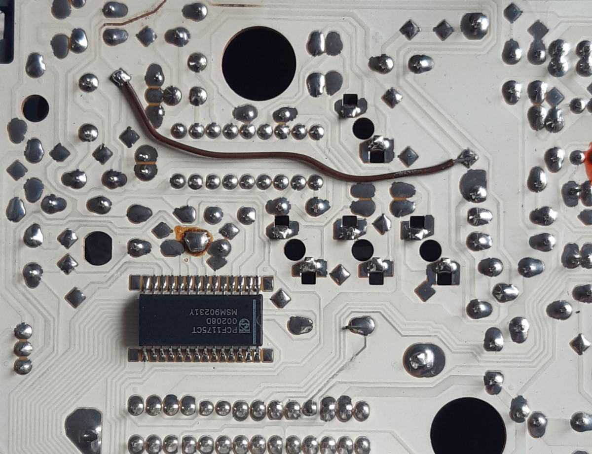

OK so here's what to do if you have my problem- ideally nothing, just live with it. The clocks have a motherboard into which each dial inserts by way of a header; this is the most likely site of my poor connection. To get to the voltage regulator you have to completely strip the motherboard of all the dials and remove it from the housing, which is a very delicate job, some of the tracks are tiny. When you take it to the car to power it up and test the regulator you get no voltage readings, then the tracks start to fry off the board and smoke rises. You spend the next hour replacing the tracks for which you will need:
Telephone wire cores
Craft knife to trim the blown tracks
Low wattage soldering iron with pointed tip
Small gauge solder
Acrylic lacquer to tropicalise the board afterwards
I was fortunate to have a usable set of clocks left at the end. It might not fry with the dials fitted, best option is a new motherboard if it doesn't work after you have inspected the headers; like i said they are a likely point of a hi-resistance connection.

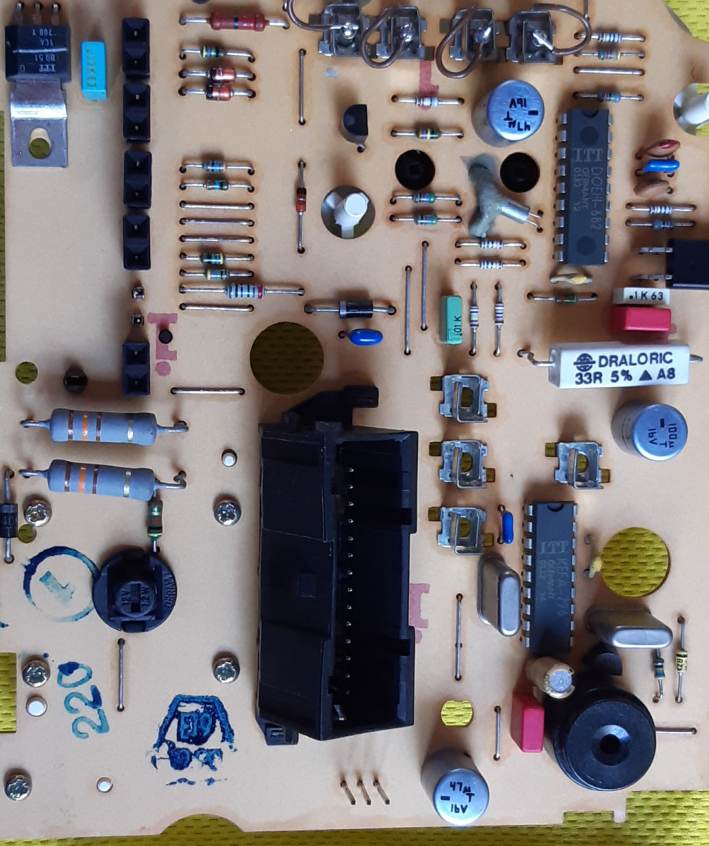

No I didn't change it in the end. I was trying to test it with the meter when the tracks started blowing off. The burnt track can be seen in the image, I think its related to the warning buzzer. I wanted to test everything first before fitting so I could verify which way up the new regulator from brickwerks needs to go.

Replacing the electrolytic capacitor* next to the ITT chip might be a useful thing to do, and any other similar caps. Little chance of them still being anywhere near in spec after all these years, I'd guess. Respect polarisation.
*47u 16V written on top of it.

Stripped it out again tonight to make a shopping list. 47uf 16v x 2, 100uf 16v x 1. I already have the regulator.
The regulator cannot go upside down, the heat sink will not contact properly and the whole assembly will be too fat with the spacer bush fitted. It has to go the right way up and be wired accordingly.

Pete is that the -ve symbol I can see printed on top of them?

Measure physical dimensions including space between leads/pads, and choose ones that are going to fit without too much bodgery.
