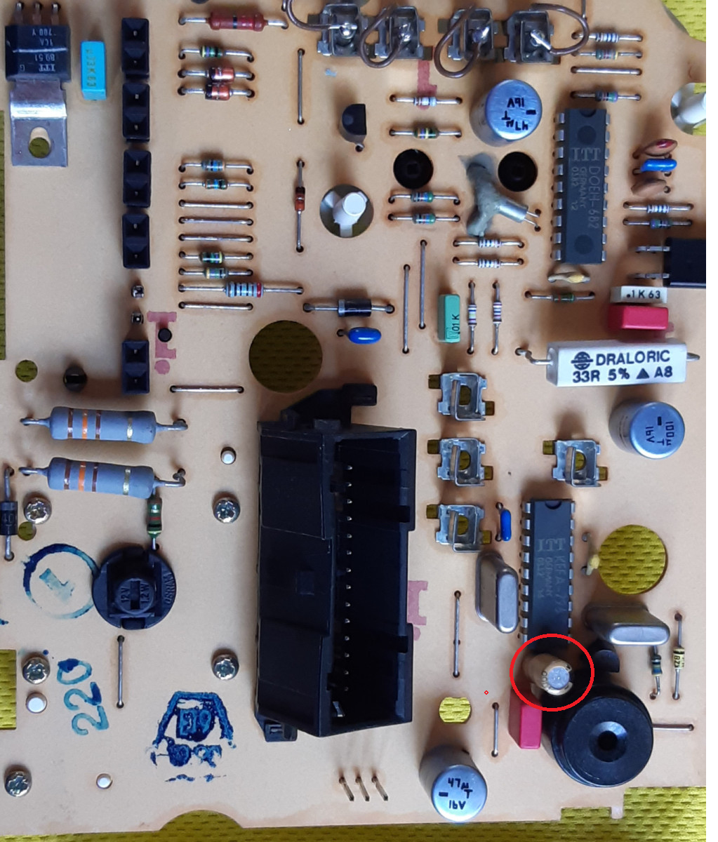

Found a selection of a few options for you.
All are around 11mm tall. There are some 47uF 50V 105°C rated ones that are about 6mm diameter, 2.5mm lead pitch. There are some 100uf 35V , same temp rating same physical dims. Also found some 100uF 50v that are 8mm dia and 3.5mm lead pitch that may fit existing holes easier for the 100uF 'full metal jacket' one. (Must admit, those are unfamiliar in appearance, looking very olde-worlde).
What value is this one, in the red circle, I didn't spot it earlier?:
Edited by Pete1
I don't really know what is and isn't suitable, but if you think they will be my best bet then i'll have them. Just give me what you think will suit.
I don't know the size of the circled one. It's perilously close to other things so i'll leave it for now.

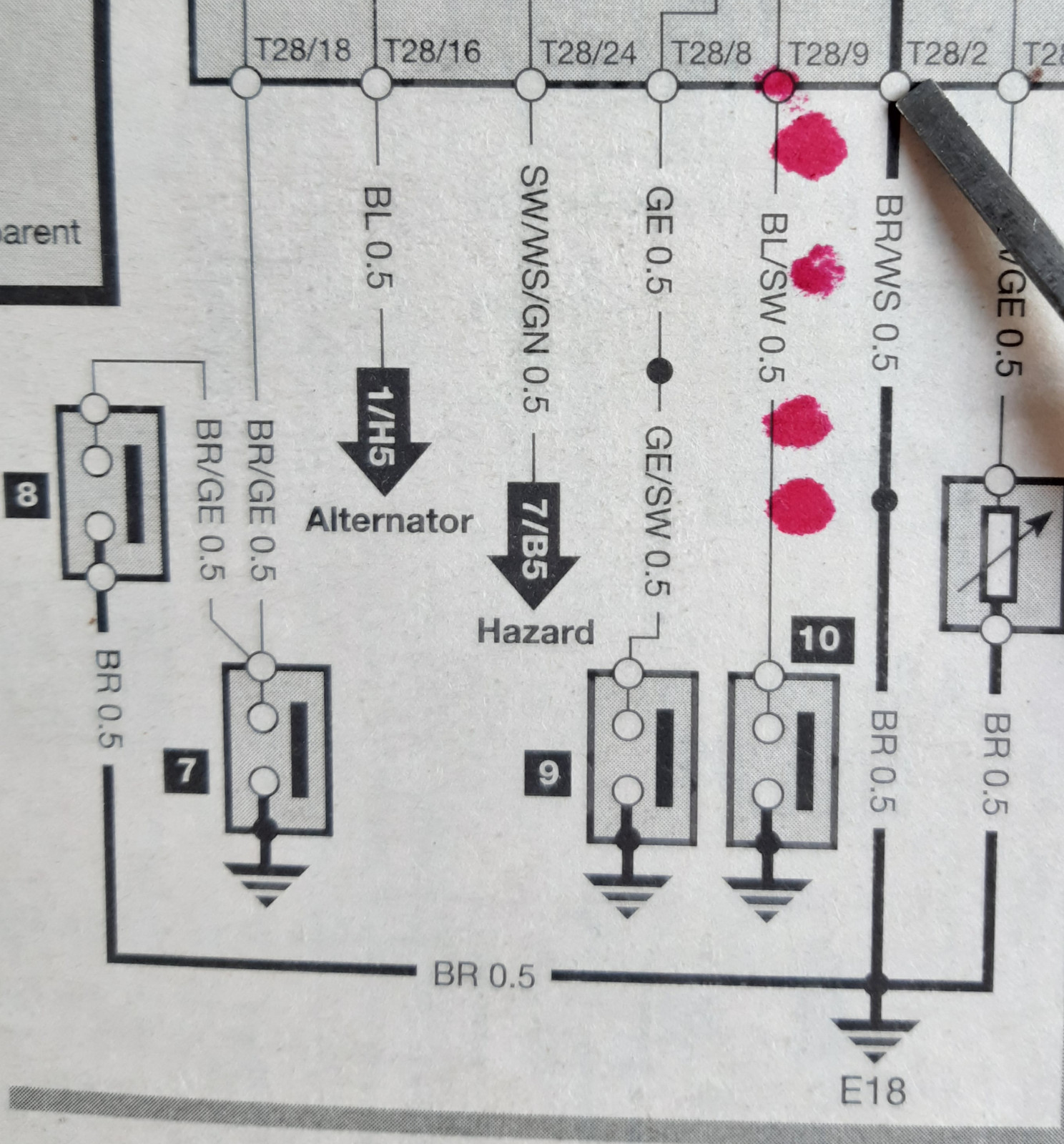

The wire pointed to by the driver is a cluster earth, mine has 2Mohm to earth. This should be tested!
There's a few more pics to upload, but the upload limit is dropping lower every time. Can this be sorted?
So spent hours trying to find the fault that was causing the high resistance to earth on bn/we wire t28/2, never found it. The wire enters the main dash loom going to the bulkhead sockets, it's not possible to test reliably. I may have found it at the sockets, or it may have been a circuit backfeeding through something else. Without removing the dash you can't be sure.

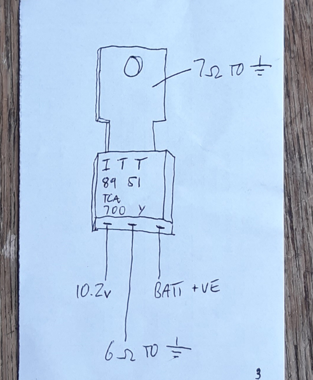

I changed the caps on the cluster board and, following petes advice, just redoldered the legs on the existing regulator. It's important to note, the cluster board has to have the regulator heat sink bolted through the board for it to power up out of its housing, see photo.
The voltages I got from the regulator were satisfactory, see the diagram for what ought to be there. There is an engine bay factory earth crimping point buried in the loom behind the digifant unit, about 6" before the bulkhead sockets in the scuttle sump. This needs redoing as a matter of ticking all the boxes. I cut the t28/2 wire behind the cluster and grounded it locally, it was the only option left.
The temperature gauge is now reading much better, however the big shock is that the tickover is now completely stable and it doesn't run very rich when it's stone cold any more. There is no hunting, no stalling, and the idle is perfect. This means that the digifant is affected adversely by the loss of a clean earth on this t28/2 at the cluster.
