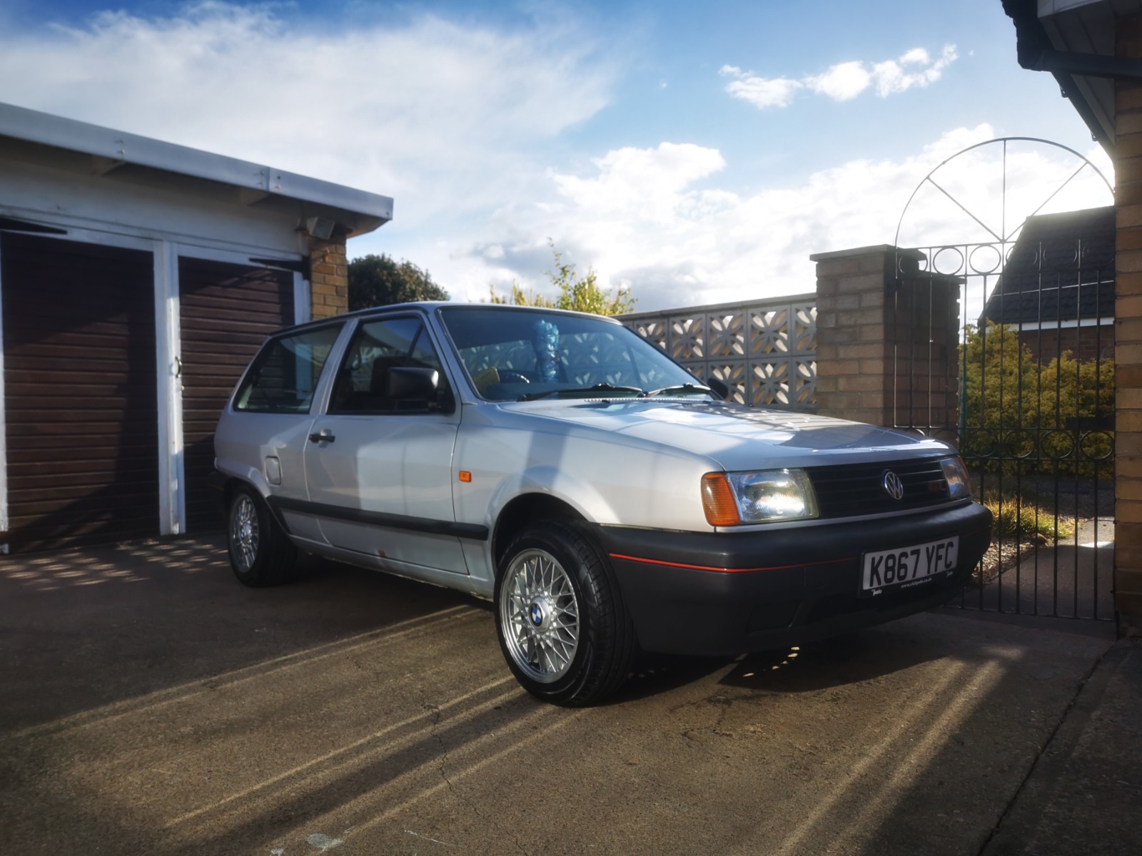

Alright guys, not sure how many people check the forums these days? As opposed to facebook etc. Anyway im gonna give this a go and do a build thread ... bare with me!

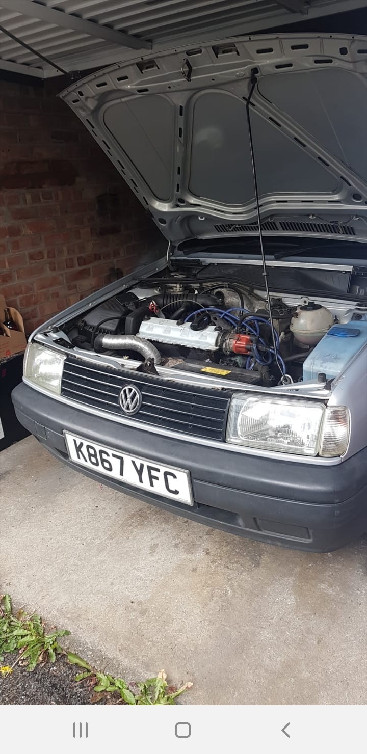

So i picked up this GT swapped bready a couple weeks a go now, its a pretty basic/ standard set up at the mo, only running a non gt 5 speed box. The car was originally a 1l genesis (still registered as). Engine and box swapped in by the lad i got it from. Its far from perfect and needs a fair amount of work doing. I was wanting another weekend car for drives out after i sold my 1.3 genesis a few months a go, and i couldnt resist this as a project for the price i paid.
First jobs im tackling are gearbox issues, oil & coolant leaks to hopefully get it into a more driveable state in the next few weeks.
Ill aim to keep this thread updated as often as i can or at least as often as i get stuff done on the car. Hopefully at least a few people can find interest in it.

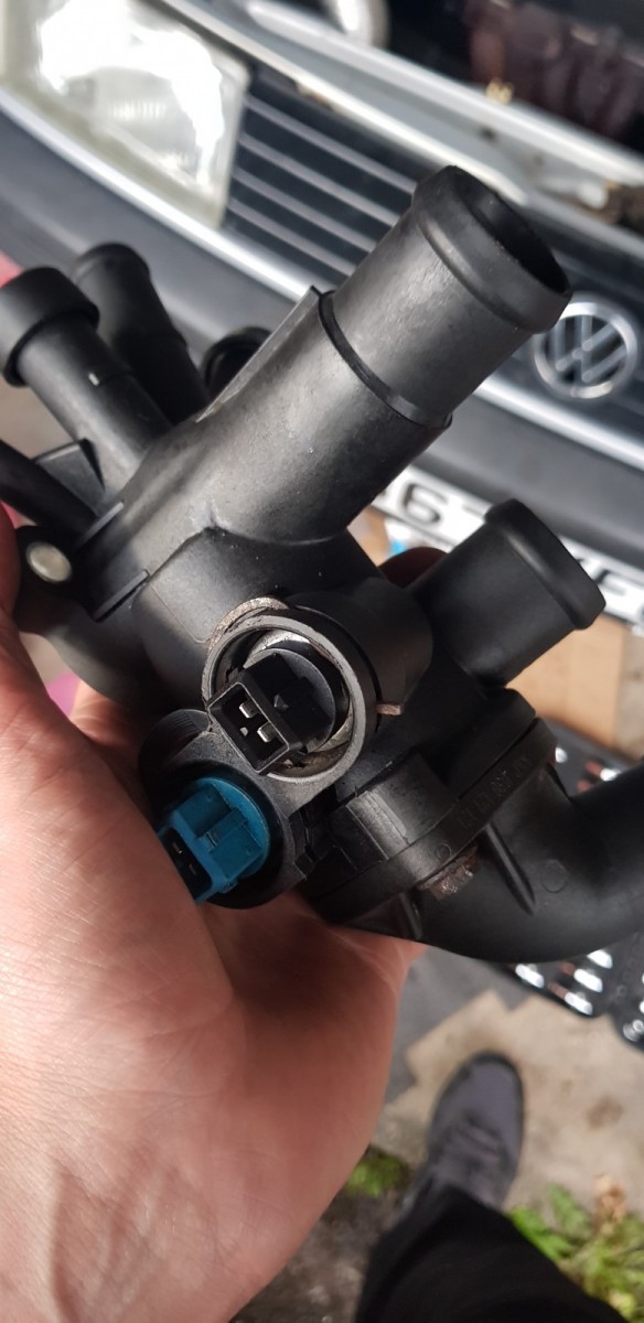

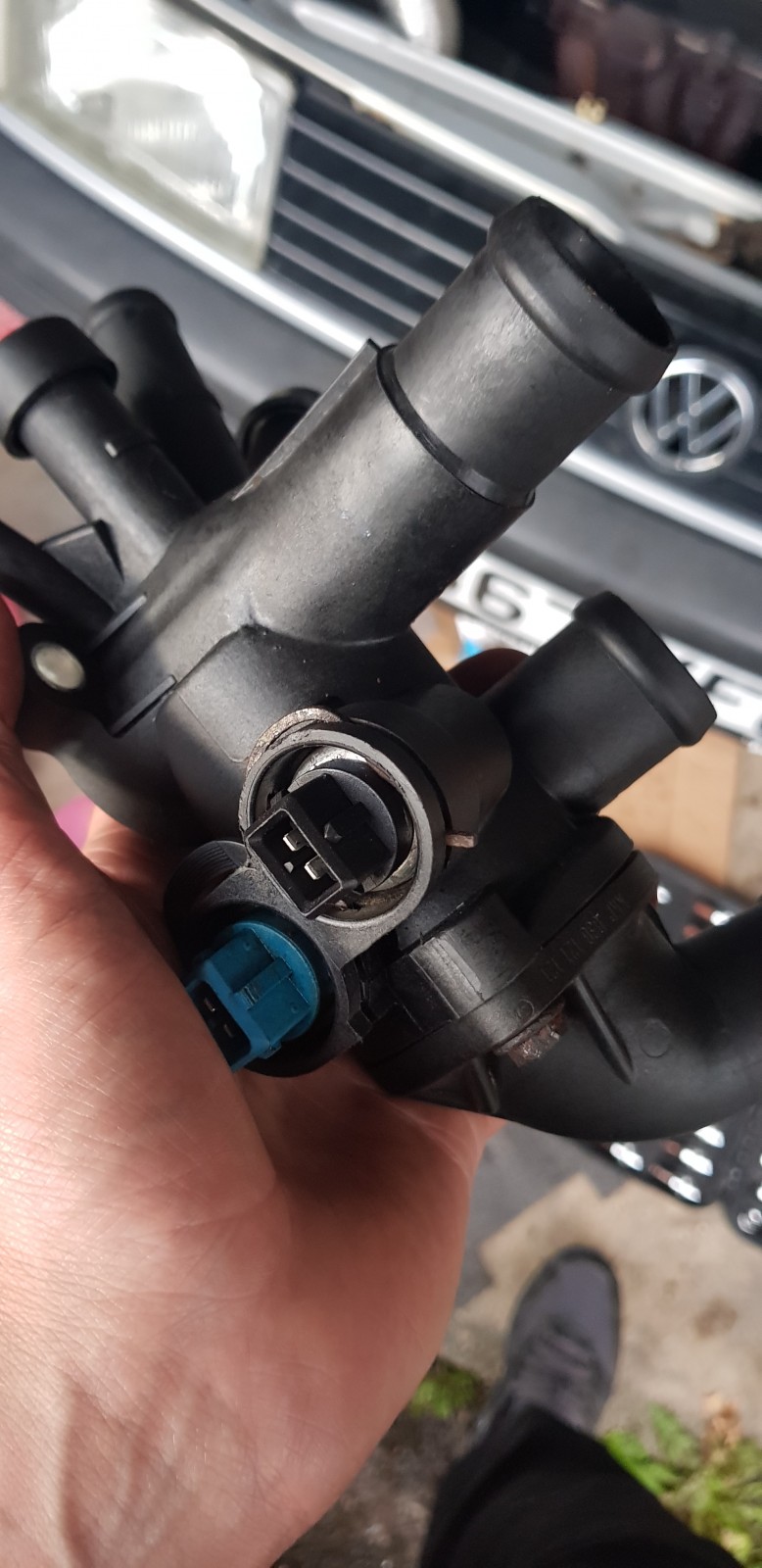

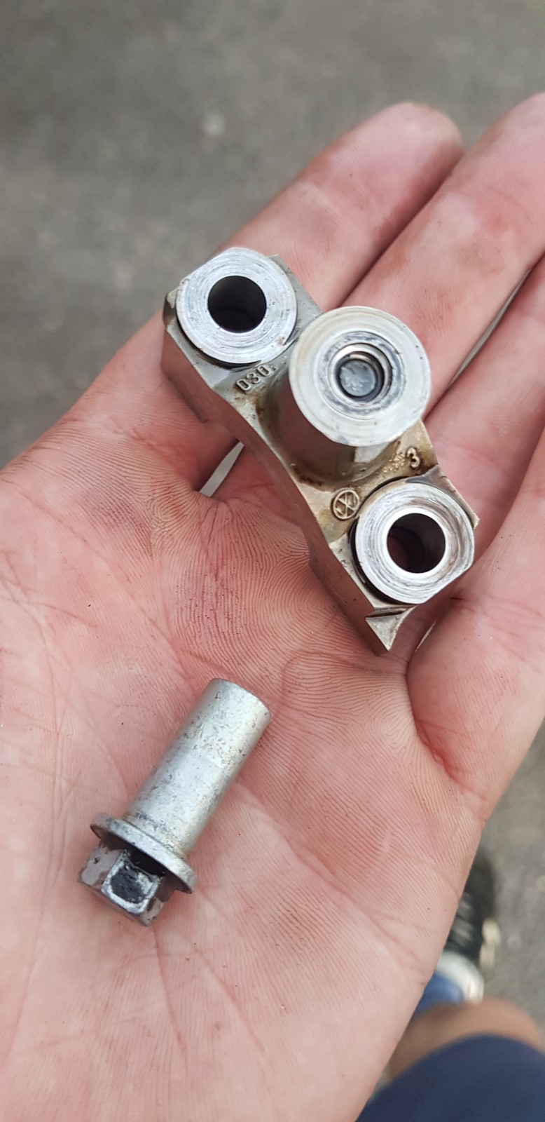

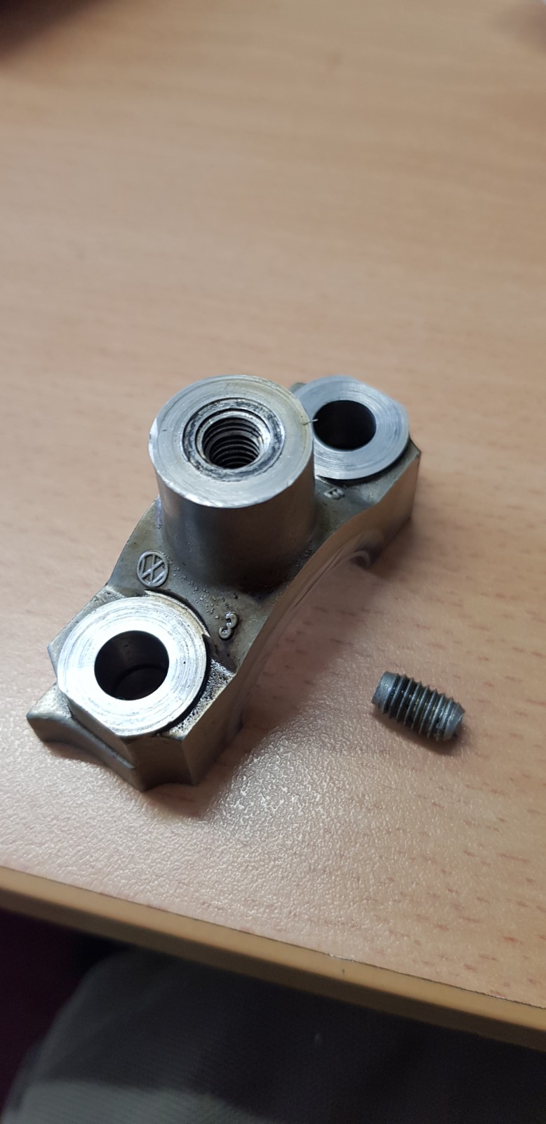

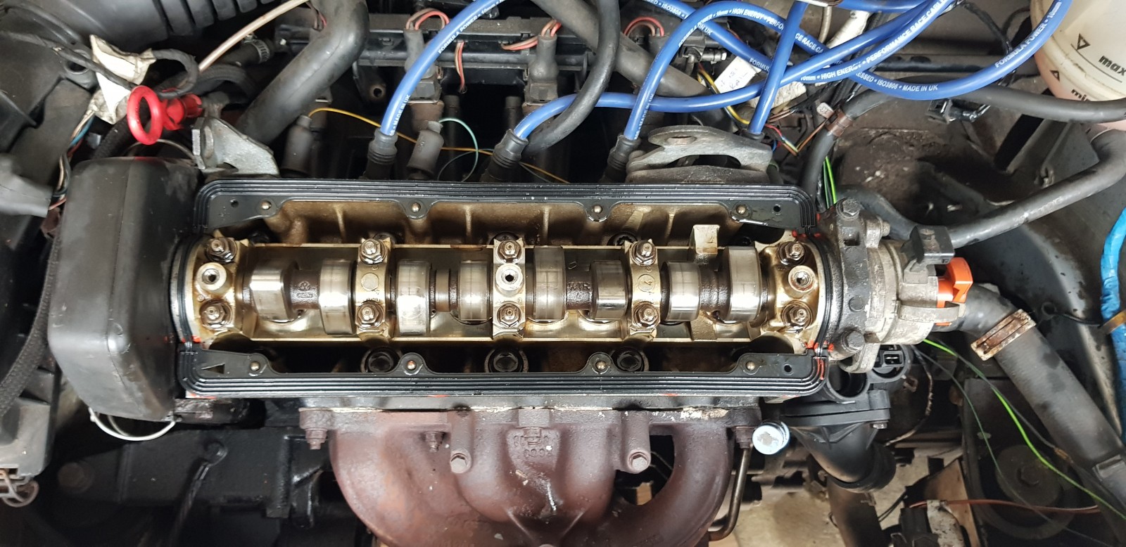

I bought the car knowing it possibly needed a head gasket, however on further inspection i am hopeful that it might not ... when i bought the car the block and just about everything underneath was covered in oil & there was a coolant leak from the thermostat housing. There was an obvious oil leak from the rocker cover on the corners where these always go. So my thinking was to clean the engine up, replace rocker gasket and then see where the oil next appears from. There is no oil and water mixed so im hopeful of not needing a head gasket doing.
Ive fitted a new rocker gasket and sealed it with gasket sealant (after snapping one of the 6m bolts holding the rocker cover on 🙄). I have also replaced the thermostat, temp sensors & thermostat housing to hopefully solve the coolant leak issue.

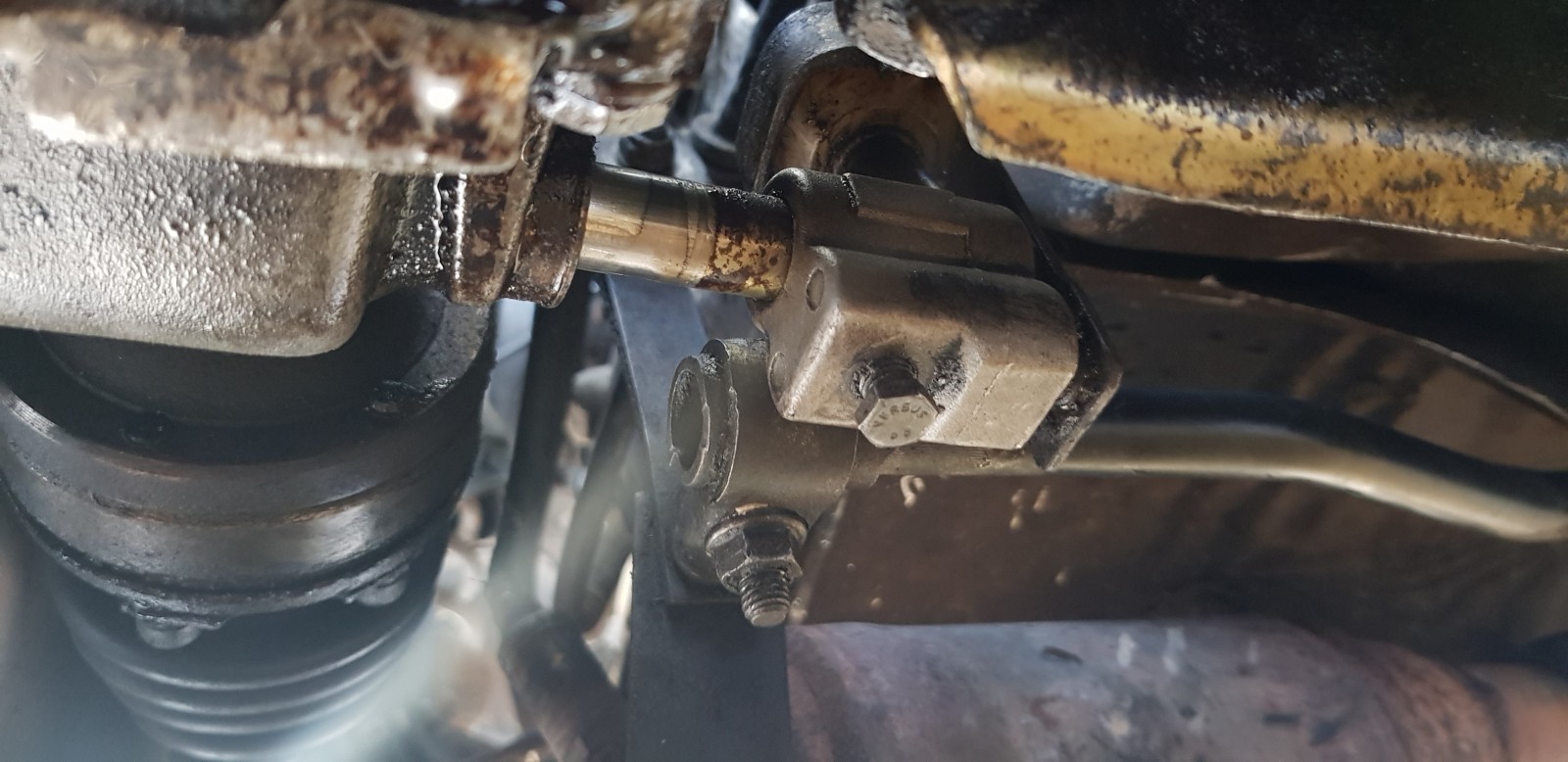

Anyway, ive managed to get a few other bits done on the car over the last month or so. One of my main issues to fix was a gearbox problem ... when driving on the motorway cruising about 60mph i lost 5th gear, it just popped out and then wouldnt stay in 5th for any longer than 20 seconds or so. After limping the car home and doing some research into what it could be, I began by draining the box to find there was barely 200ml of oil in (box should take 3.2L i believe!). Luckily there was no cr*p came out with the oil. I refilled it and had a mess around with the linkage to try get selection just right (not fun!). And since then it has been spot on. It is however still leaking oil from the box. I think its coming from the selector seal? (If anyone can shed any light on that some info would be gratefully received 🙂 ). Theres not loads of oil, maybe a few drips each time i come back to the car after a week or so.

I think my gearbox has same problem popping out of 5th and when filling hardly anything came out. I’ve put 1ltr back in but didn’t think it needed like 3 litres, mine seems to have leak from underneath also possibly coming from the gear link seal aswell.
do you know if new seals can be bought and keep us updated on how you fix problem. I’ve got a perfect gearbox on shelf but I’d much rather save that and try fixing this one.

Its a classic problem with these boxes - everyone seems to go through it at some point! If you can live with the drops of gear oil on your drive/the street then you can live with it for ages - it won't loose oil very fast. I'd be more concerned that the box was running so low on oil for potentially a very long time as once the damage is done it can't be un-done by refilling the sump unfortunately.
However for the seal change its a fiddle but nothing major - get hold of an OEM VW seal (they're all over the place - pat number 085301227). You supposedly can change the seal out with oil in the box (jacking the car to push the oil to the other end) but if you don't want a face full of gear oil I'd recommend dumping the oil. Jack the front up and suppot on axle stands and remove the gear link from the selector rod and push out of the way. Now the tricky bit - you need to pry out the old seal (which is mostly metal inside - the rubber is just for sealing) without scoring the selector shaft. The usual advice is to use a couple of self tapping screws to get some purchase with some mole grips - I couldn't get the scres in (no drill) so went at it with a screwdriver until I demolished one side of it and levered the lot out.
Next you want to thoroughly clean the shaft and the brass case. I would also recommend polishing the input shaft where it would slide through the new seal - use a polishing grit wet-and-dry paper and get it good and shiny. when installing the new seal you'll need to fill the back of the seal with some grease - VW used a blue sealing grease (G052128A1, find it on ebay a lot or maybe someone has a tube you can borrow), you could probably get away with a little lithium grease - its just to hold the oil in.
And thats it! Well worth doing but remember that the tiniest hairline scores in the input shaft can wear down the new seal prematurely and you'll have a drip again eventually.

This is fantastic, thankyou mate. Very helpful. Ill see how I go on with it & see how long it lasts. Ill be looking for a gt box anyway hopefully

Hi mate when you fill the box just fill until it starts to overflow. Better to have plenty in... have a read of zobs reply too!
