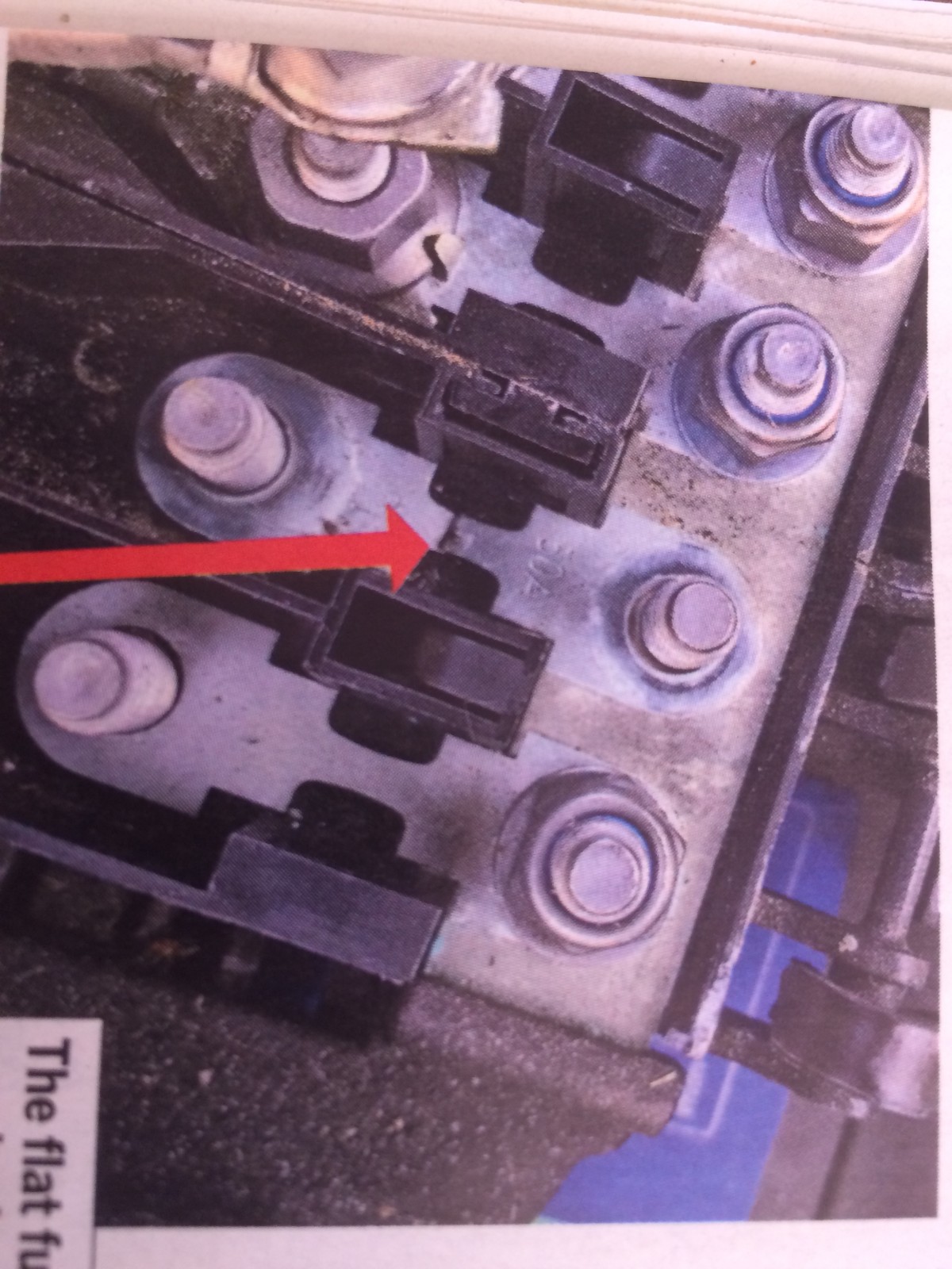

This is an example of the flat fuses
This one has obviously failed, but they can crack on the underside, so just looking across them might not reveal the crack, the only way is to remove them and inspect and on refitting torque the nuts to 6Nm
