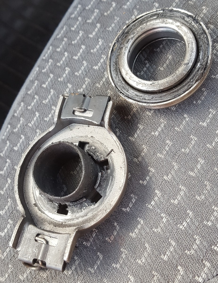

Hey, ive finally got a photo of it.

Is that broken off guide tube inside the bottom piece?
Can you post a picture of the outsides too?
I'd be looking for whether the clip spring is mangled or any uneven wear at the contact point of the pressure plate fingers.
Ill get a pic later. Yes thst he guide tube snapped in half. I have a picuure of the other bearing with me now.
This one has had 100miles on it haha
Looks fairly even where the pressure plate fingers touch (any worn circles I can see are not ovals or gapped).
So it's not the spring but the metal plate that locates the spring that smashed to pieces, bearing went diagonal and ripped the tube out of the flange.
Maybe. That's a guess. Needs an eye witness inside the box.
Flange is not bent so it's not likely that one or two of three bolts worked loose.
I'll have to look at a gearbox for how the stirrup pushes/pulls the release bearing.
Could the stirrup be worn on one side?
Is the stirrup the arm the pushes the bearing. If so i believe its been replaced last time it went.
So that kind of rules out pressure plate.  Ive now done about 350 miles on the latest bearing and still bit jerky but no strqnge crunchy pedal or odd noises. But im dricing in constant fear of it crapping its3lf qgain 😭

I called it stirrup. Part A, release lever.  Was it checked to be worn/damaged/twisted
by the failed bearing's destruction?
I could imagine that the small groove that spring clips onto ( almost exactly at the end of line from A in the picture)
is damaged/worn and the release bearing is gradually becoming diagonal not parallel to the flywheel as it is only held
tightly on one side.
As the lever is operated from rest the release bearing is pushed, its rotating part should touch the pressure plate fingers
and spin. May be slight whirring noise, until fully disengaged clutch. But if an edge of the bearing is touching, that would
surely scrape/squeal.
