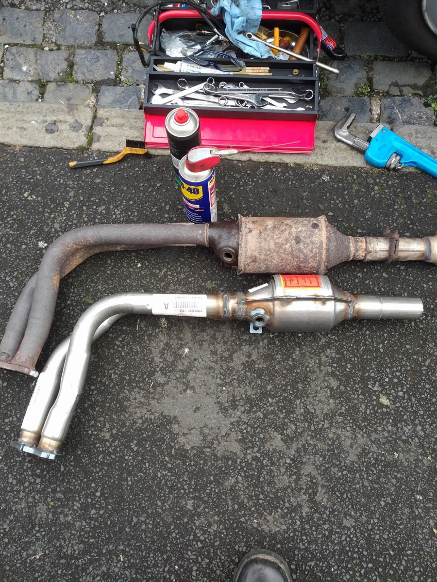

  • Had a bit of time today so finished off installing the new cat and joining it up with the rest of the exhaust. As per their instructions I 'ran it in' on idle for 10 minutes and then went for a normal

    athe broken earth made the car think it was freezing outside , car ran overly rich and ruined the o2 sensor and cat by running so rich   the blue temp sender and its wiring are key to these

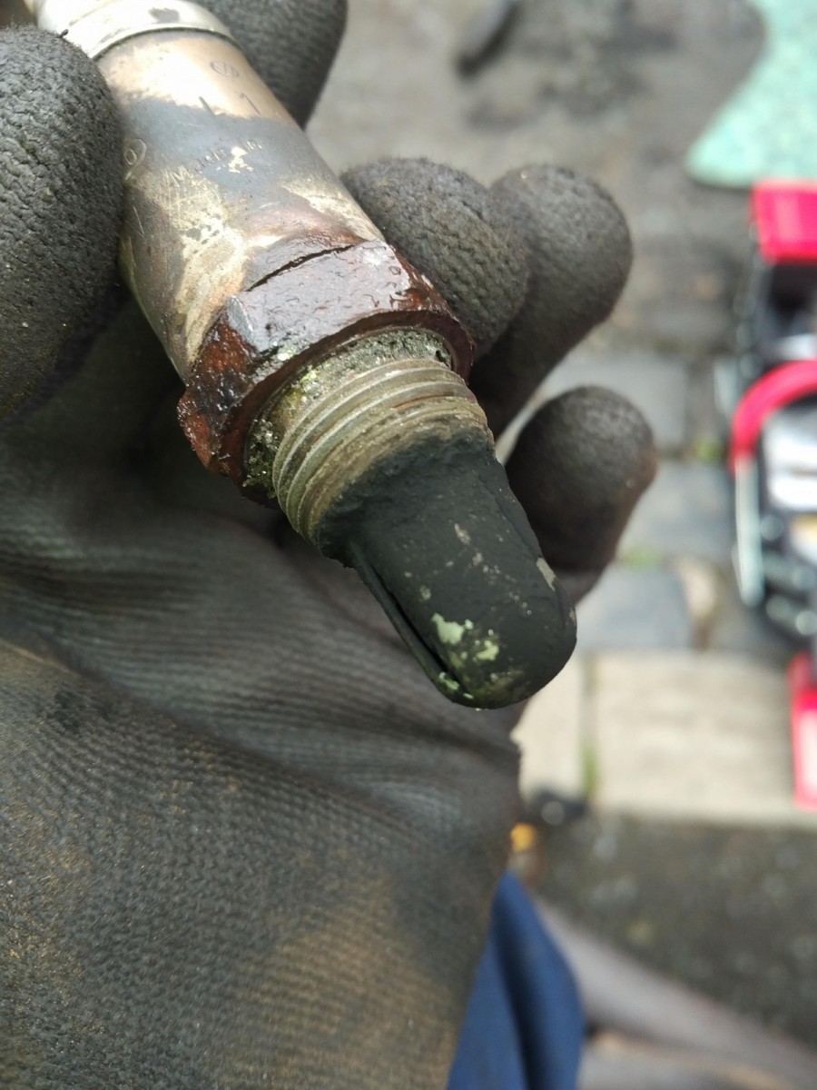

Aye, I'll replace the wire properly rather than jury rig on a new earth, for now I'll just make sure it does its job to get through the MOT.
The idle isn't particularly steady when warm now - I wouldn't be surprised if the lambda sensor is coked right up or on its way out. Got another one coming in the post which I'll pop on the new cat and install both of them if the next emission test is a pass (or a much closer fail).
