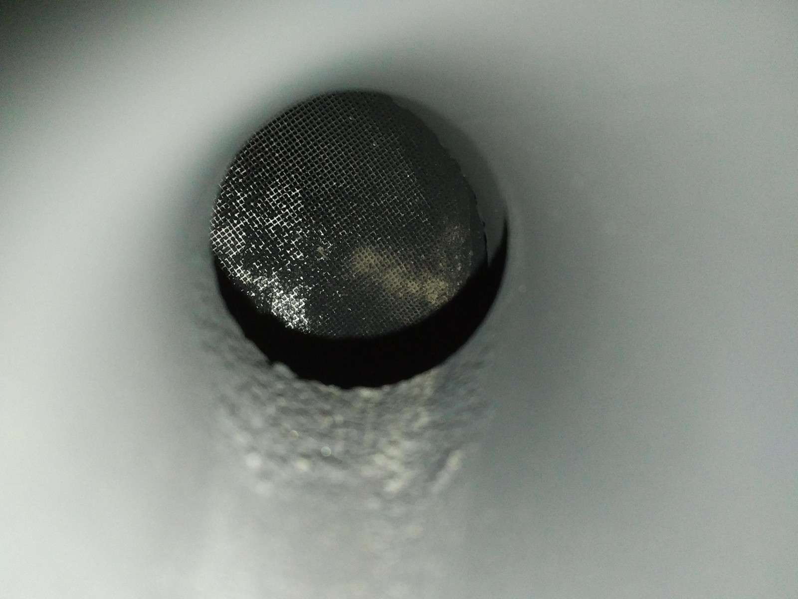

Cat monolith wasn't melted but doesn't look particularly good. Hard to tell but I can see various hues and some shiny parts which I assume isn't fab:

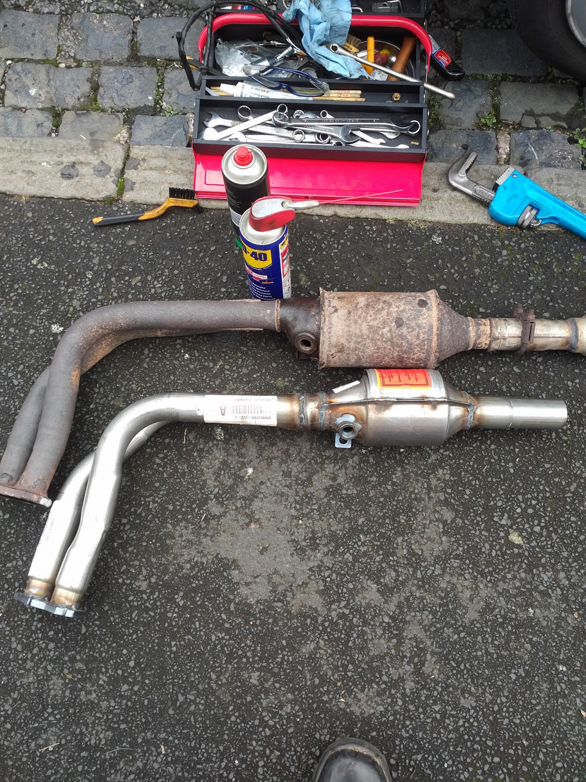

New cat next to old cat. The old one has a VW part number stamped on it, might even be the original?IMG_20190925_1459163.thumb.jpg.59cf456a7c9d9fd14616abad1cbdf9d2.jpg
