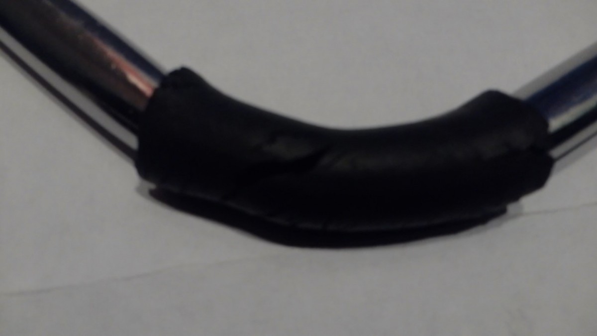

The old hose had split where bent at tighter angle I think. I'll try to post a pic.
Edited by dvderlm
bit of a poor picture but rubber inner was split.
Almost looks torn by twisting , maybe the swage and clip distorted it.
If I roll it between my fingers it is quite cracked on outside of rubber tube.
So not ethanol as that would attack the inside?
