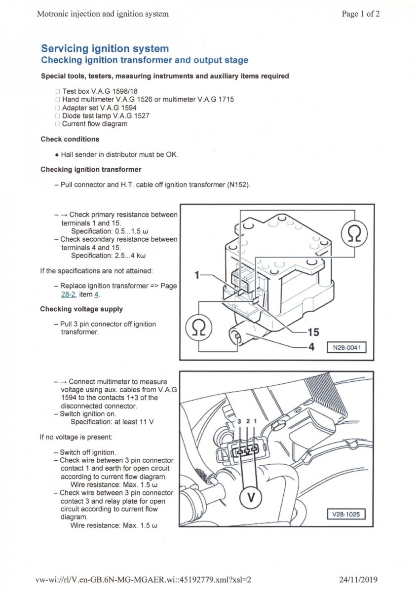

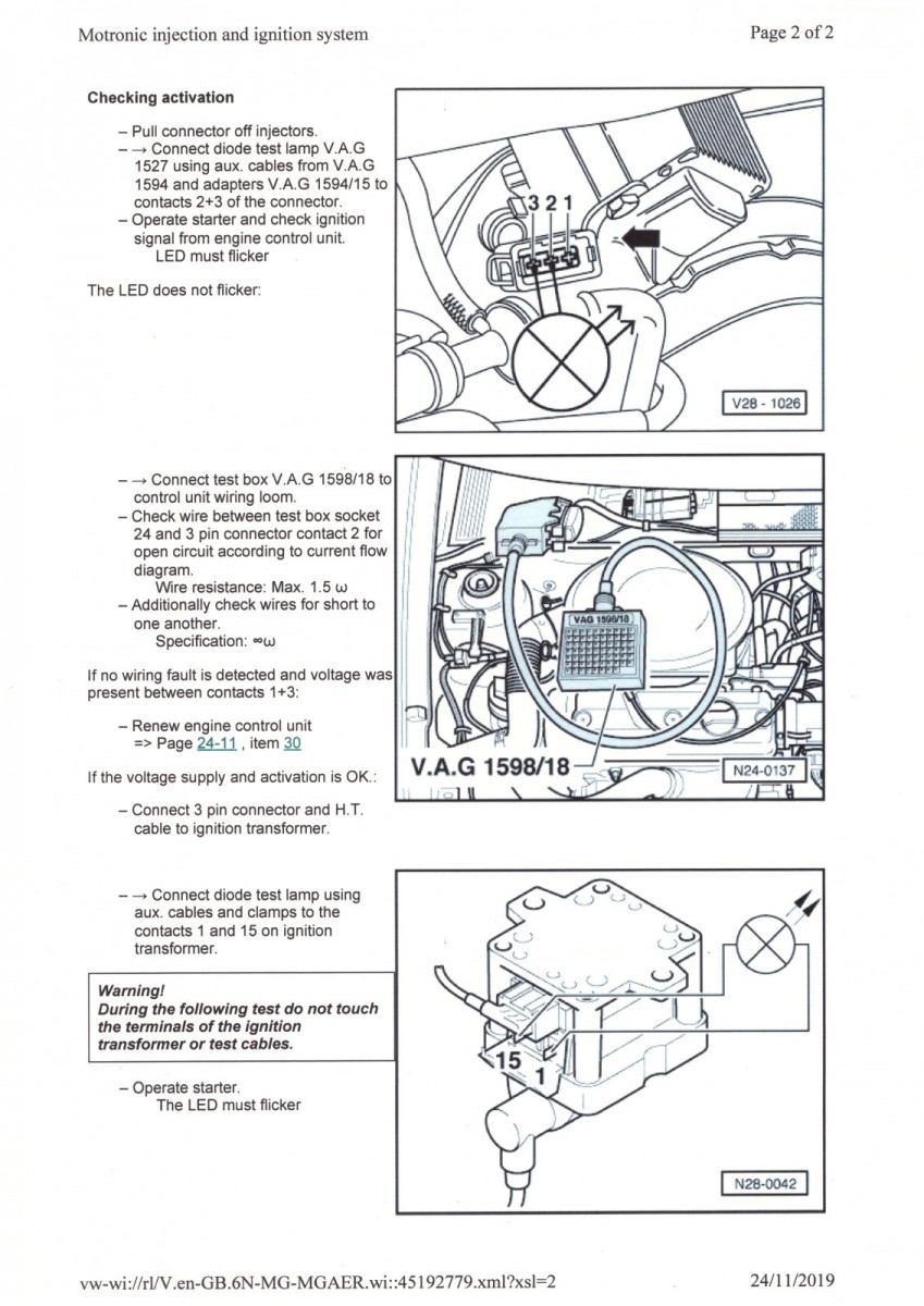

Here's the info from the dealer manual
Coil Tests.pdf

So the coil had a little fold down door to get at the terminals. Using the 3 pin connector at the top gives a different (and out of spec) reading. Must be some additional circuitry.
So I have ran the tests -
Bridging 1 to 15 = 0.07 Ohms - In spec (0.5 to 1.5 Ohms)
Bridging 15 to 4 = 3.08 Ohms - In spec (2.5 to 4.0 K Ohms)
So the coil is good and the ignition leads are reasonably good.
I just need to check the outputs to the coil on the car when its light.
Thanks again for the info.
The three pin connector goes to the ignition amp that is part of the coil unit, so that is why you initially had some strange readings
Quite, It wasn't until I studied the pictures you sent that I saw the cover over the terminals.
