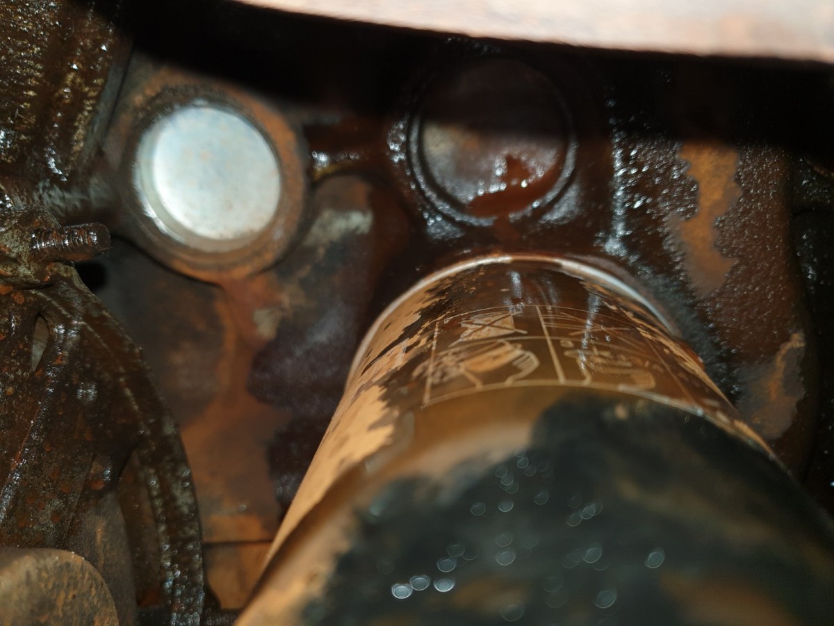

Found it!!! Core plug leak!! Again!!!!!! One obove the oil filter. Would that have leaked the oil as well?
no wont leak both
Could the two be connected in any way at all or do i got two different issues that i need to sort out?

I've had that core plug replaced earlier this year already, and one other blew, (not sure which one,) when it was fired up after that one was done. Is this a sign of a bigger issue that i can get on top of or just a crappy coincidence?

The core plugs are nothing to do with the oil system, as you have already replaced at least one already, I would take the belt and braces approach and just replace them all, as if you just replace this one it will just find the next weakest one and pop that, it's most likely to been caused by a previous owner not running with decent anti-freeze and the core plugs are cheap steel so tend to rust easy.

The one that is currently leaking is the first one i had replaced earlier this year. It had rusted through.
I'll see if i can get a full set. Are they standard size or all different?

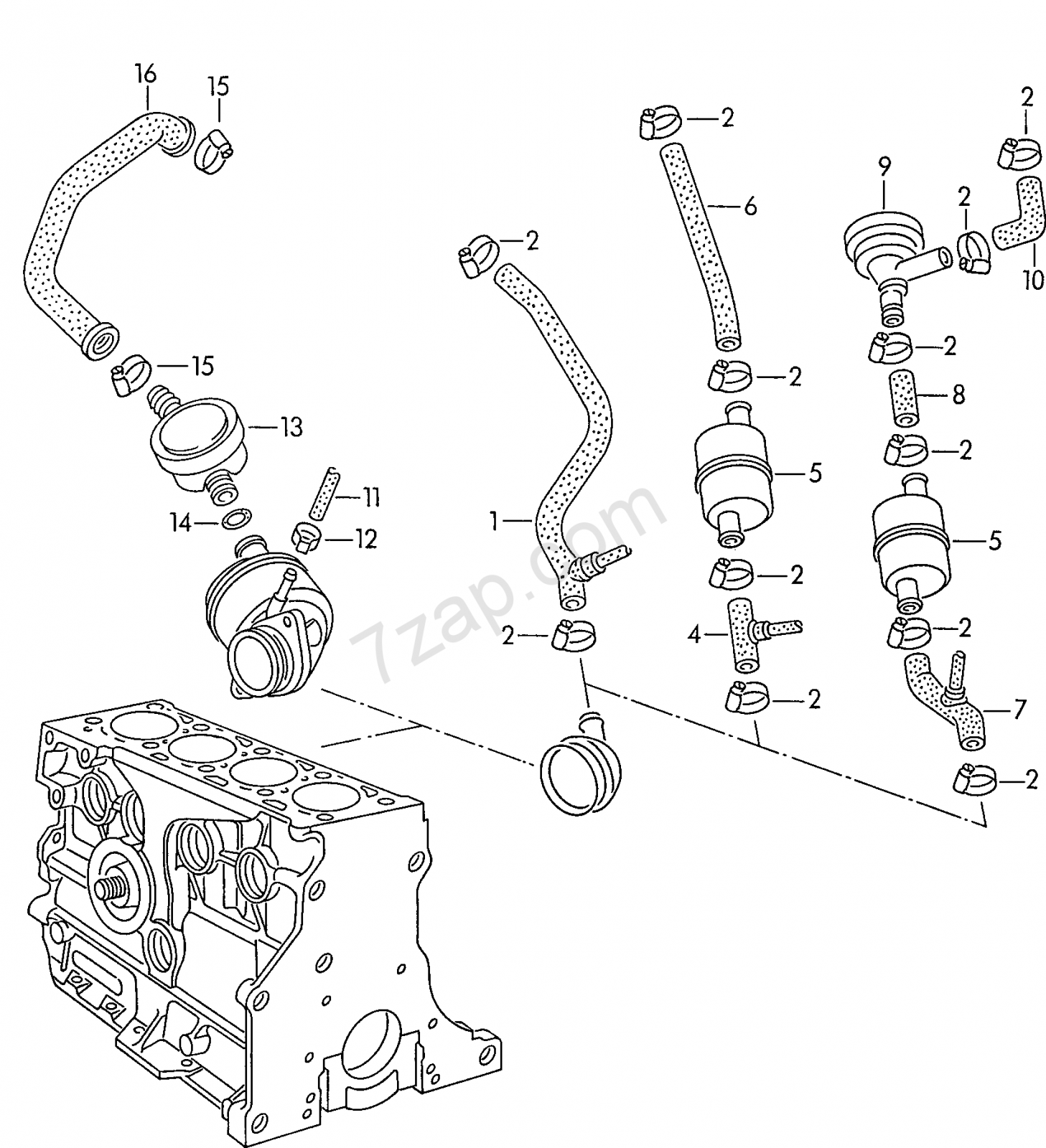

The crankcase breather is the box on the back of the engine under the inlet manifold, if that is blocked it will pressurise the sump and force the oil out from the weakest point, but with the amount you have lost I would of thought the area would of been drenched in oil

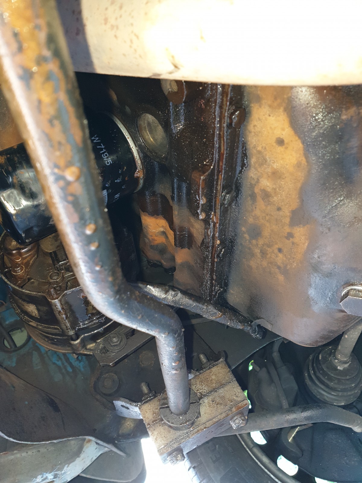

I lookee at the bottom of the sump pan and to me, it looks like the steering rack goes right across underneath the back of it. Does it just move out of the way if i turn the steering wheel?

I will degrease and see if i can spot anything.

As said higher in the thread check the crank case ventilation pipe / oil separator. Your crankcase needs to vent excess gas pressure (created by 'blow-by' past the pistons), if it can't then it'll force oil out of whatever seal gives way first. There'll be a breather pipe going from the block via a plastic contraption (the oil separator) to your air filer housing. This all needs to be checked for blockage - you can clean the separator by swilling it in a bucket of petrol (its a little labyrinth so will take a while to loosen all the gunk). Number 5 on the image below. If its blocked its likely the pipes attached to it are pretty gunked up too.
