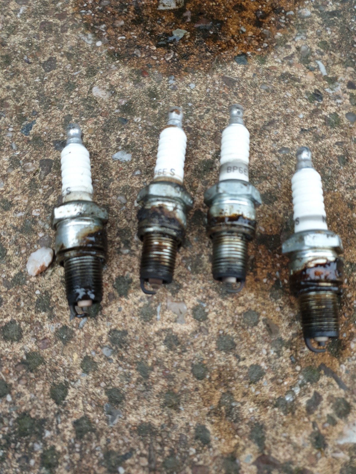

FINALLY got chance to get plugs out!
Not lookin good. I have a spare set which i'm gonna gap and fit.
I can't see an external oil seperator. The exhaust recirculation hose goes straight from the crank case to the air filter housing with nothing else fitted between the two. The crank case end of the hose seems fine. No splits or stress.

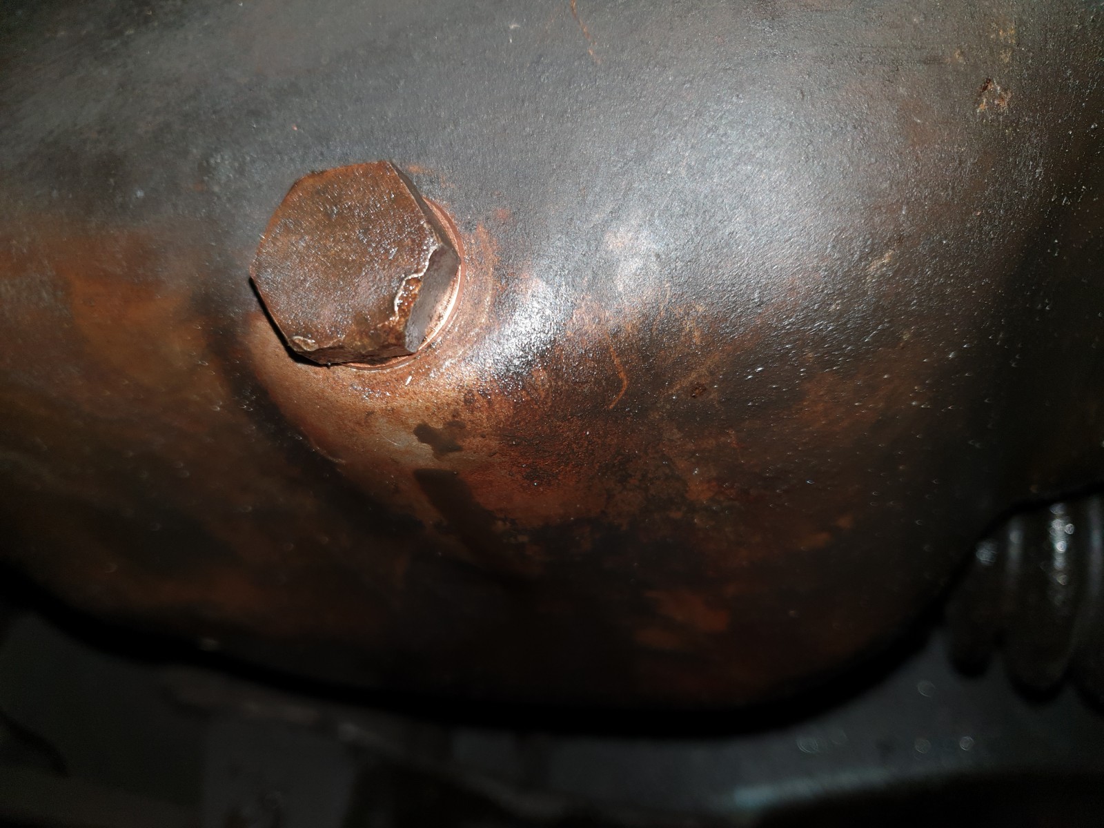

Would i be on the right track in thinkin that the oil could have gone past the plugs and possibly past the sump plug, as i used the wrong kind of washer, which meant an improper seal?

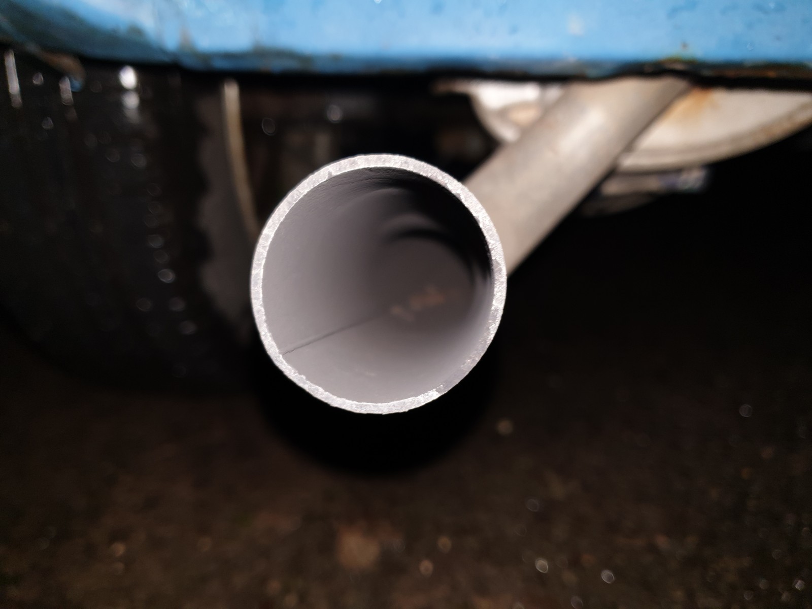

  • kinda sounds to me like maybe you never filled it up    if it dripped or burned over 3 ltrs of oil you would know about it , oily tail pipe , oil stains all over the place

if its dropped 3 ltrs of oil past the sump washer you would see it ...whole underside would be coated with oil

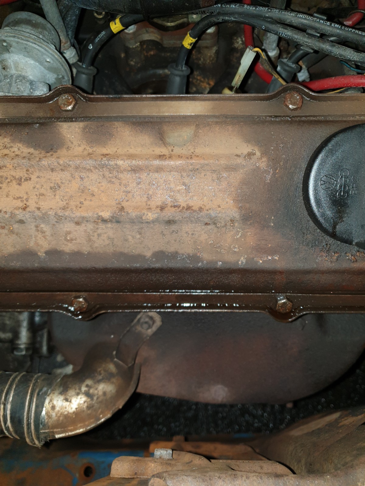

 very strange , its not dumped 3 litres of oil out that rocker gasket so id hold fire on that

Oil above the washers on the sparkplugs...
What are the new plugs like?

Rocker cover gasket only lost small amounts but was nearly MOT fail once.

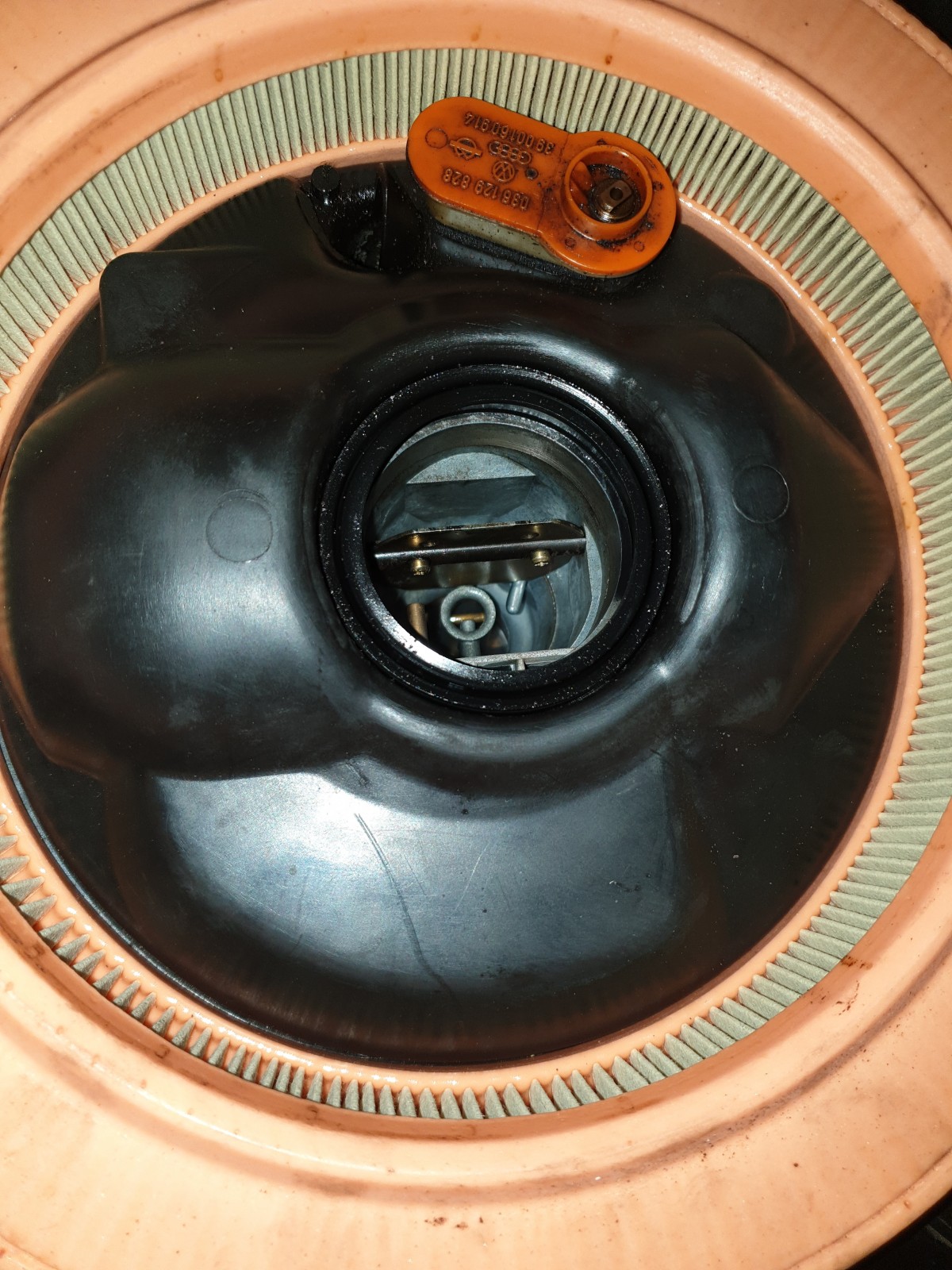

whats it like if you pop the air cleaner lid off
My own fault for takin it for a run before checking for oil seperator.
Inside air cleaner looks fine. If i look down into where the egr hose is connected, looks a bit grubby in there. Need to take my jack and plug puller tomorrow and see what i can find with those. Check oil seperator, crankcase breather, egr hose and plugs.

If the inside of the air cleaner looks ok then a lack of oil separator isn't the main problem - you'd see heaps of oil all over the inlet if that were the case.

does it stink ?  youd think if its burnt or spilled that much it would smell , just doesnt make sense if burning more oil than fuel then there would be a smoke screen behind it

Air filter housing is clean as a whistle inside. Even the filter isn't very grubby.

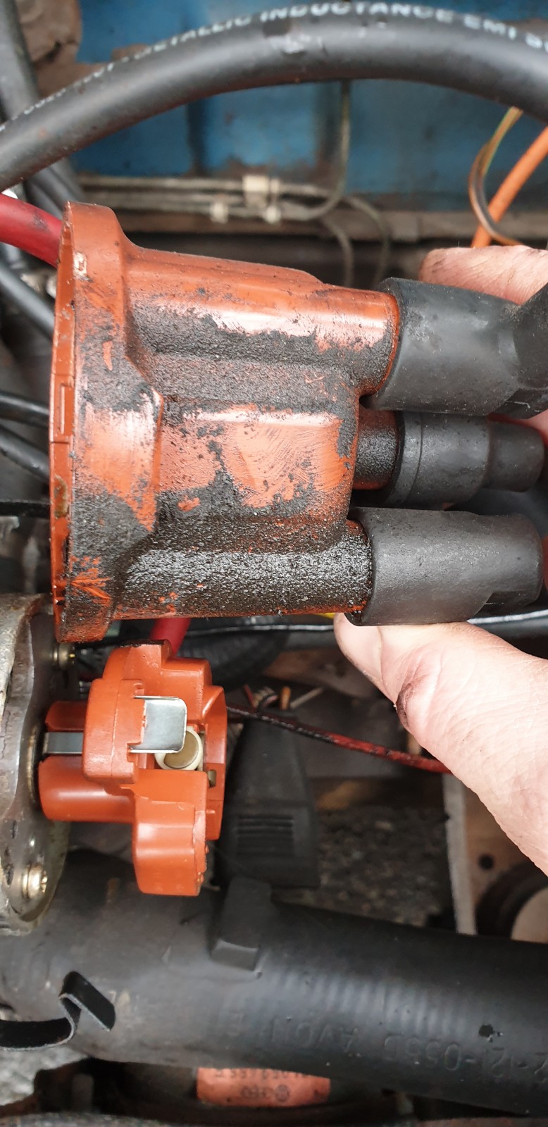

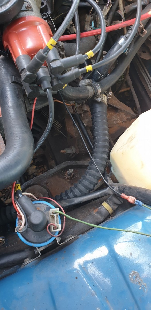

Underside of the dizzy cap. That end of the engine is caked in oil. Think cam seal may have gone. I haven't taken the rotor arm and checked inside the dizzy yet, but looking at that, think i may have found it. Or at least part of it anyway.

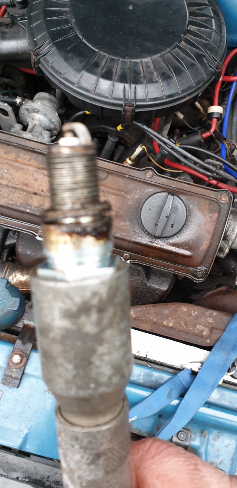

This is plug #1, brand new set last week.
