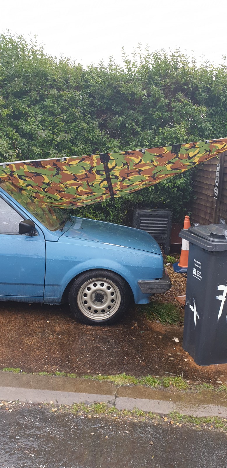

Have to wait for dizzy seal to arrive to do that one. Also, weather is grim today and i got no garage/shelter. Had to make one with a tarpaulin and some rope then sat in my shed to clean the cam cover.

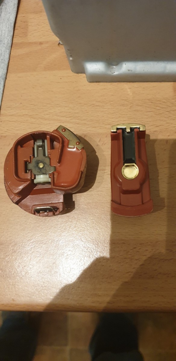

The first pic is of the old and new rotor arms. Larger one on left is the old/og, unbranded, not even a part number on it, right is new, Beru part. Openings on the back are exactly the same. Am i okay to use the Beru one or do i need all those little gubbins that are on the old one?

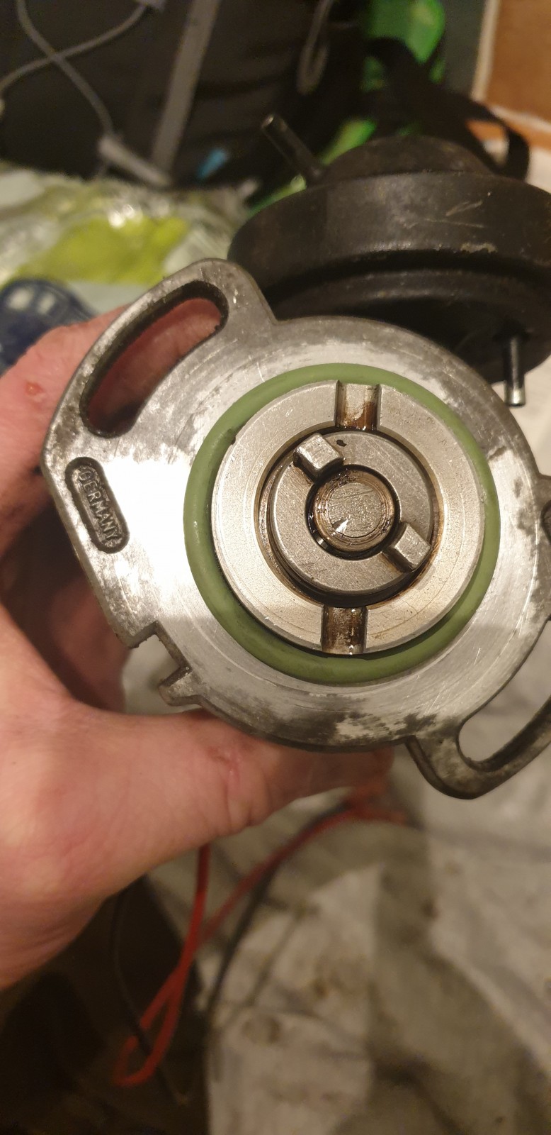

Other thing, the green O ring is the new one. Is it meant to go where i've placed it in the picture, if so, it's too dang big. There's one under it, but it's kind of a flat one and a little smaller.
Hoping to get the flange off the side of the engine tomorrow and check the seal.
Don't you need to remove the old o-ring? It gets flattened over time.
