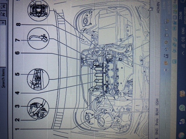

I'm trying to fix a fault on a 1400 Polo (2008) indicated by a Fault Code P 0444. ( Evap Emission on system purge control Valve Circuit Open)   My first line of investigation is with the Purge Control Valve, but need some help in locating this item.  Any Leads on my initial search would be much appreciated.

The evap valve is #5 in this picture
Assuming you have engine code BLM ?

Found the valve, removed it and tested it. It all seemed ok and was in the normally closed position.
Replaced the valve, cleared the fault code and everything appears to be functioning ok with no codes now displayed.
Thanks for your help in locating the valve
