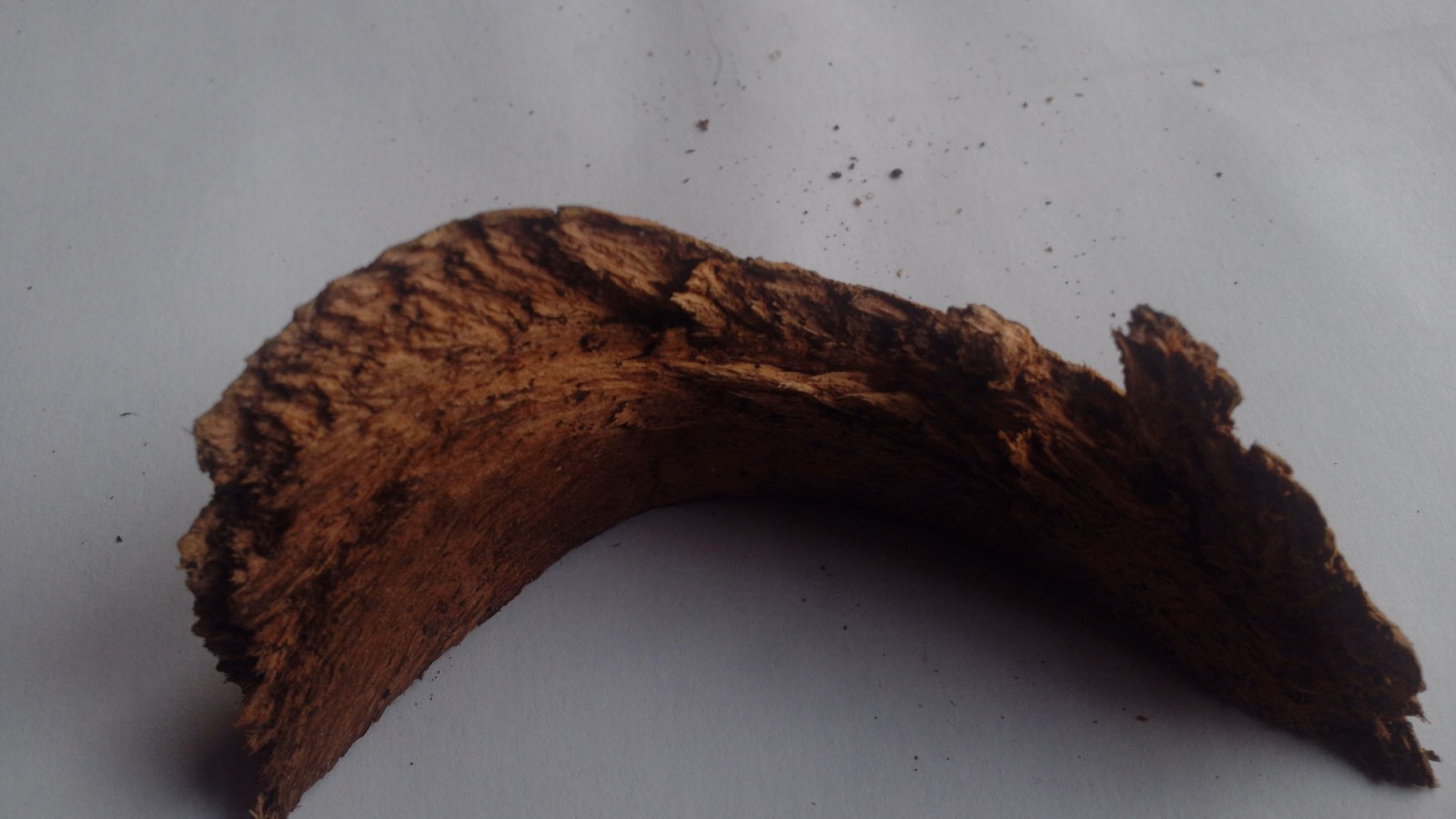

Drove about 10 miles home. jacked car up this morning to check the bearing and this fell to the ground.
Piece of wood road debris trapped between coil spring and tyre tread?
Bearing has a bit of play, so I'll tighten it and see if the noise has gone.

Tightened the bearing so washer below the castle nut on hub nut and split pin barely moves left/right levered with a screwdriver. Wheel spins with just a slight scrape from the shoes on the drum.  Will give it a test drive tomorrow.
That looks like part of an old ship or boat - are you sure it was a SHALLOW pot hole 😊
It was dark and raining... aaaaarrr, shiver me timbers.
