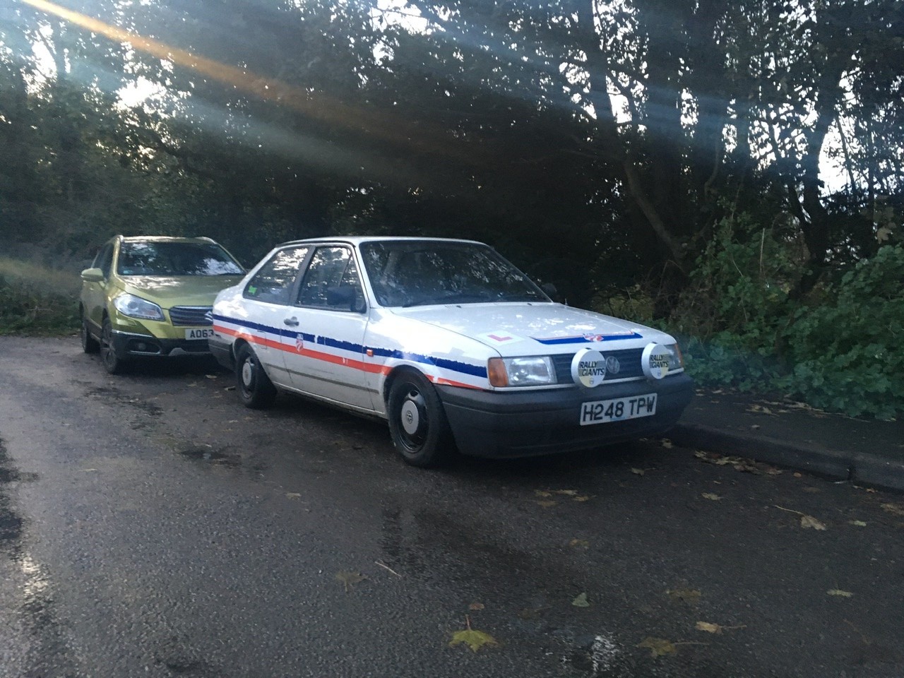

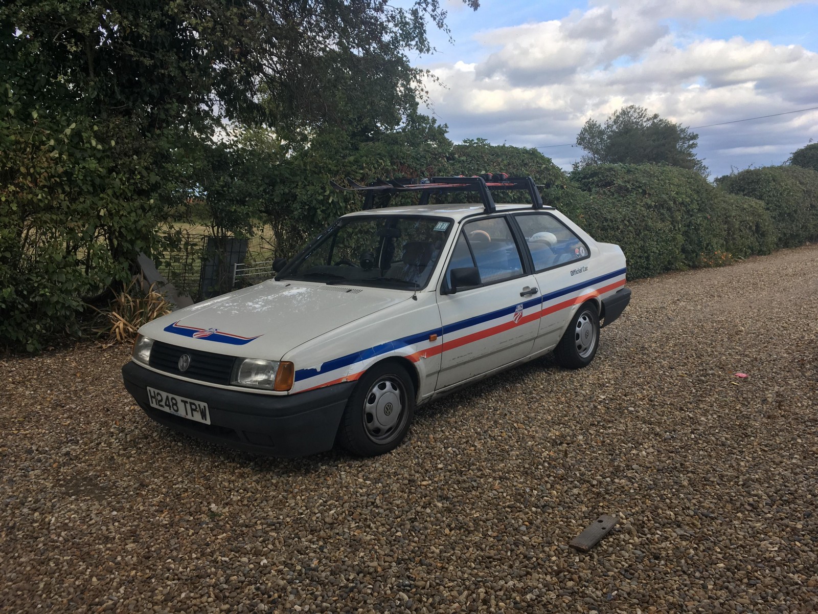

I bought a mk2f saloon last september, previously modified by the person i bought it from in the style of the US ski team (i dont know why... but it was fun)
Anyway since buying it i have done a number of things, namely taking the skis off of the roof and replacing the ski pole gear stick (hahaha) for a normal one.
Things i've also done:
Changed petrol tank, fixed gear linkage, filled rust hole underneath battery (my foot got wet while driving in the rain), service (new plugs and filters all round), fitted rally fog lights

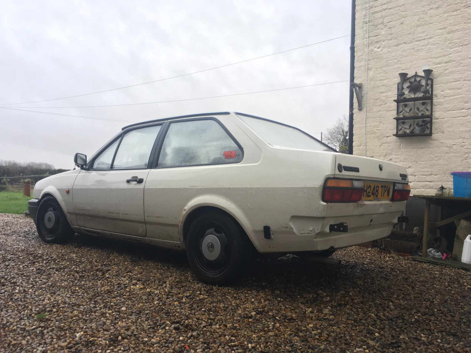

Just an update on the general progress with the car, i've taken the horrible faded stickers off (with a heat gun) and while i was at it took the rear bumper off too.. i like the way it looks! Currently looking into getting a piece of steel tubing to act as a rear bumper as it looks like its missing something
