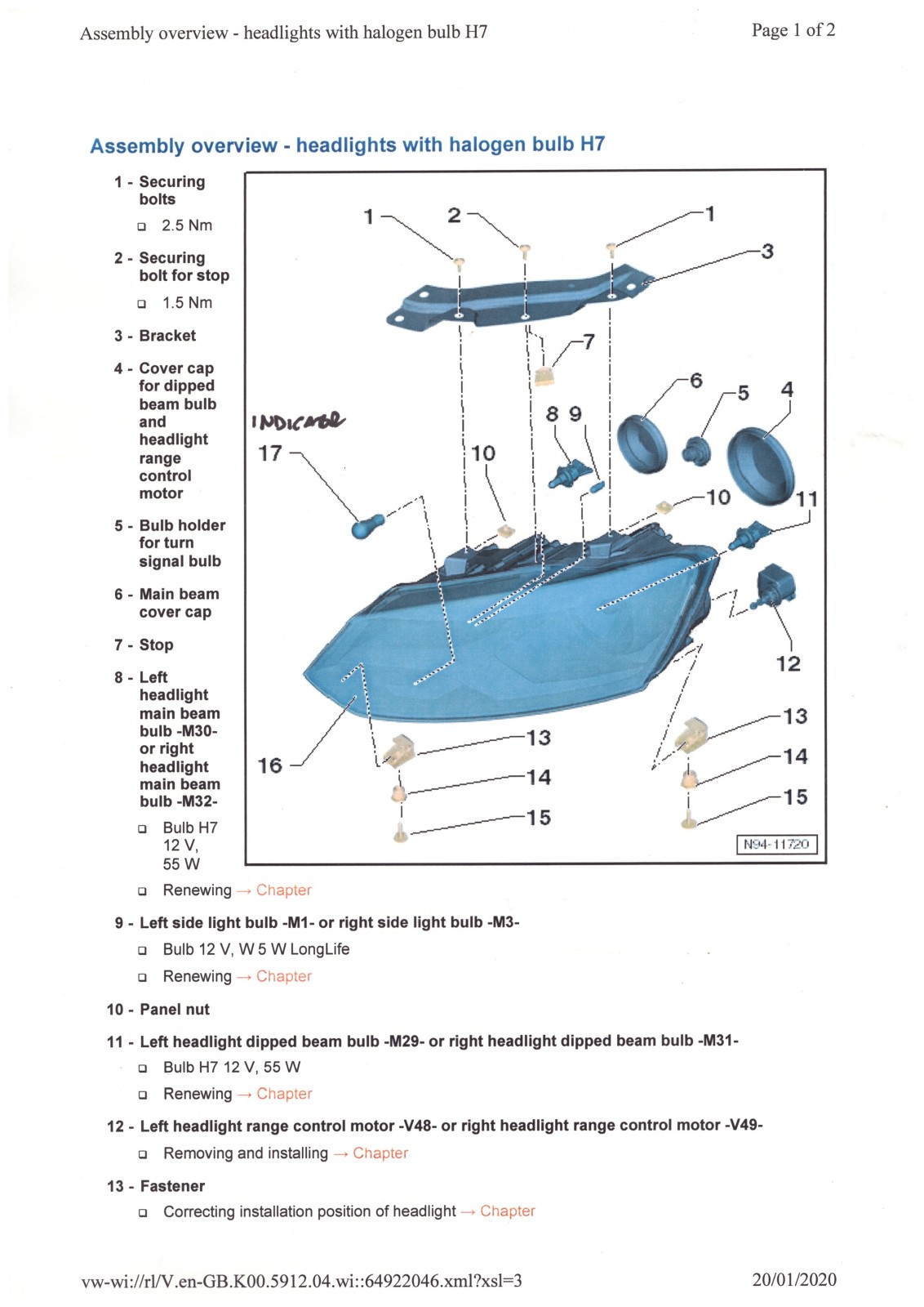

its not the sidelight one, it’s the main headlight, please see image.
I changed the large bulb, the H7 one, the W5W is working fine
Thanks [again]!
As you can see there are two H7 bulbs #'s 8 & 11
nige8021,
You’re a star, I didn’t even realise there were 2 H7’s [DOH!] must be my eyes! I took the bulb out & it looks fine, no sign of it being blown, but nevertheless, thanks so much, sorted now
