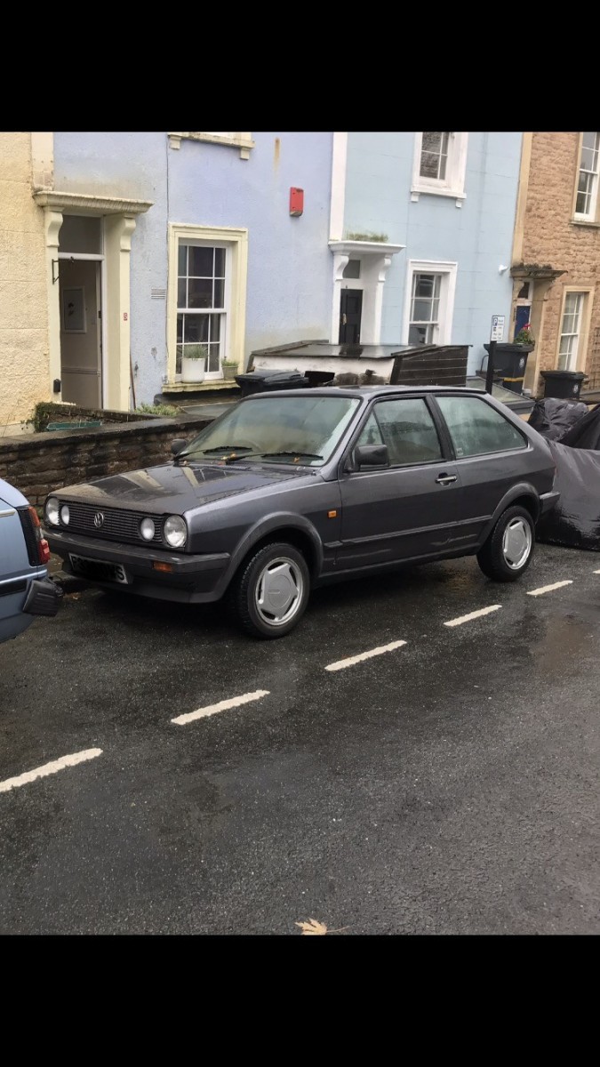

Willysmiles
Been staring at peoples build threads for months now, so I decided to give my own a go.
bought a completely standard 1988 coupe s with only 60k miles on the clock! One old couple owner from new, it’s a true standard gem; however I’ve now got my hands on it...
my plan is to keep it looking mostly original looking but underneath have some nice mods to bring it to fast road spec,    well as fast as a 1.3 can be.

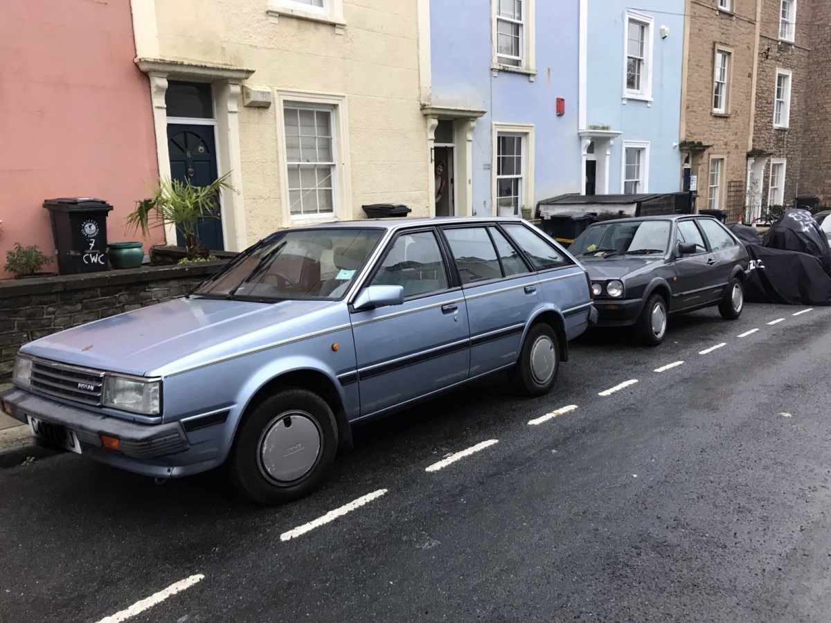

Great looking coupe dude, keep the pics coming!   That an 86ish Sunny estate I can see peaking into first pic?
Love that!! A neighbour had one that was identical to that other than the wheeltrims. My dad has driven Datsun/Nissan since the 70s so I've a huge soft spot for them.

Willysmiles
Changed the wheels to a set of ATS cups, fully refurbished with a new set of tyres. These are the 14” size and cost my £200 without the tyres
bumpers only off for some light paint as someone scraped it while they were parking.

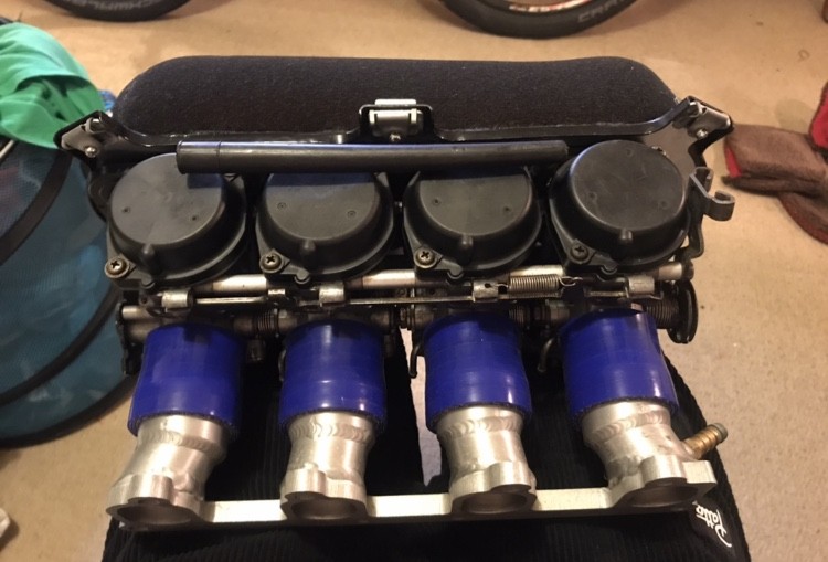

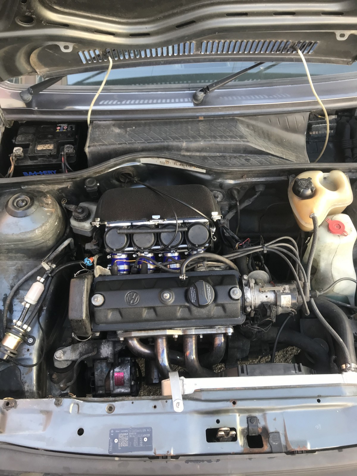

Willysmiles
Scored a full danstengineering Zx6r bike carb conversion kit from eBay for only £200, hopefully will be fitting that in the next month or so. I will need it give it all a good run down and check it’s all there before I start to fit it.  I’m going to convert to an electric fuel pump as the carbs will be easier to tune with correct fuel pressure at all times.  Will keep you all posted on how the full install goes when I get round to it

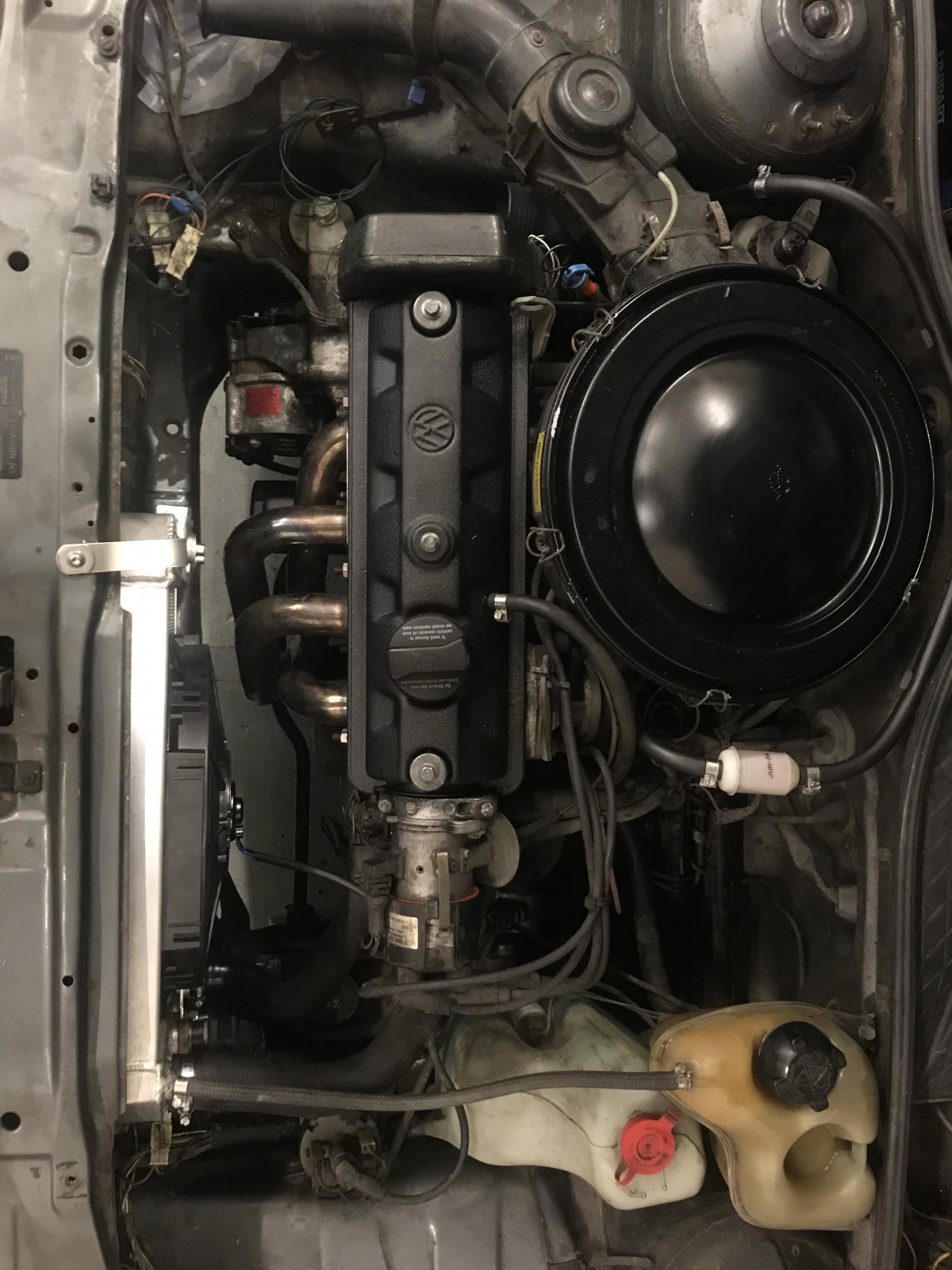

Willysmiles
Pain in the ass cheap stainless header fitted, I’ve had to chop and weld the exhaust flexi to get it to not foul up on the gear change linkage.  Also fitted a full stainless system with a centre box delete. I have kept the original back box as I like the ‘pea shooter’ end can, it also keeps the original look.

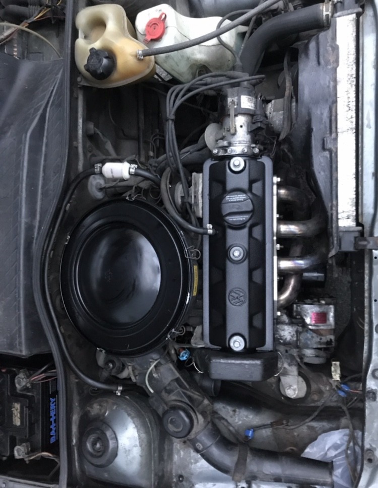

Willysmiles
Crinkle finish powder coat on the rocker cover, I’ve now bought a 40mm core aluminium radiator and 12” fan to fit at a later date.

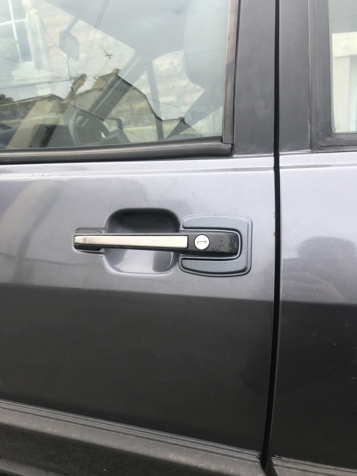

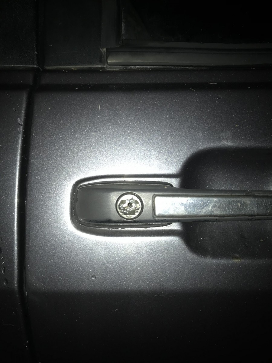

Willysmiles
Someone bust all my locks in last night didn’t manage to get into the car though.  😖 now I’m having to get in via the boot.

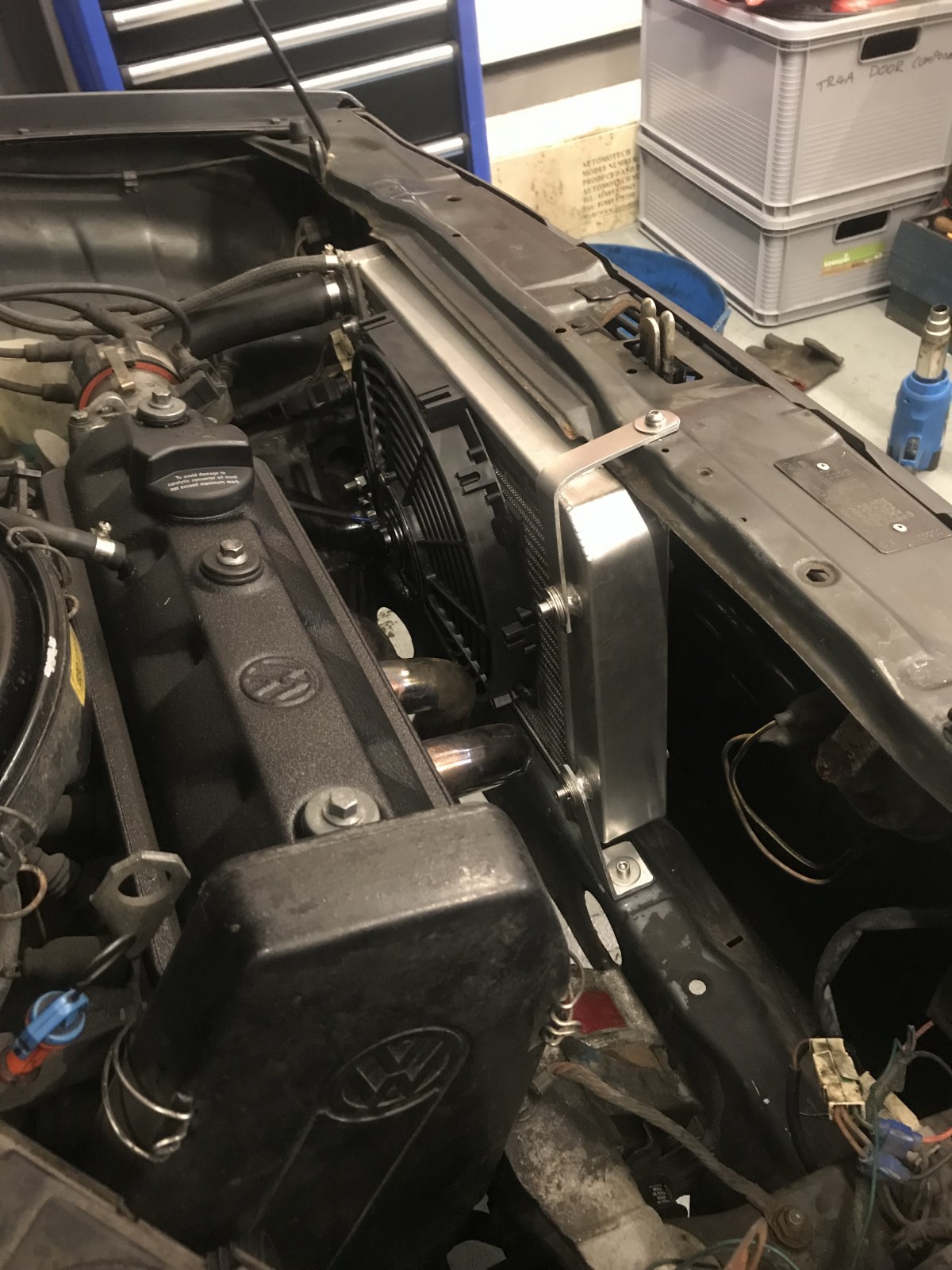

Willysmiles
40mm aluminium radiator fitted with 12” fan.  Surprising amount of room between the manifold and fan. I’m not happy with any of the mounting brackets yet so I will remake them all much neater.

Willysmiles
1 hour ago, Jim1500 said:
That looks well smart!
Cheers buddy,  I’ll upload some more pictures when I sort the brackets out

Willysmiles
http://www.coolexperts.co.uk/product/vw-polo-derived-westfield-aluminium-race-radiator/ It’s a coolex radiator,  I managed to get it second hand for £60 from Facebook.  Coolex can supply the fan also. Don’t worry about the fan switch as the original fits this radiator.    Brackets will have to be made to fit it but there not hard as it’s all accessible.

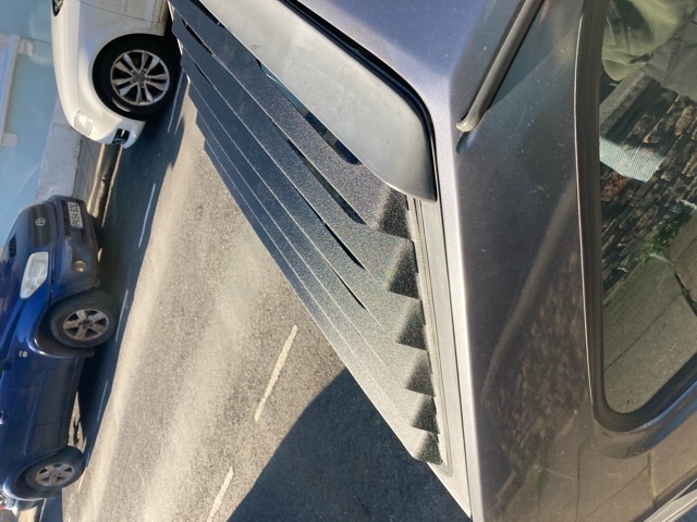

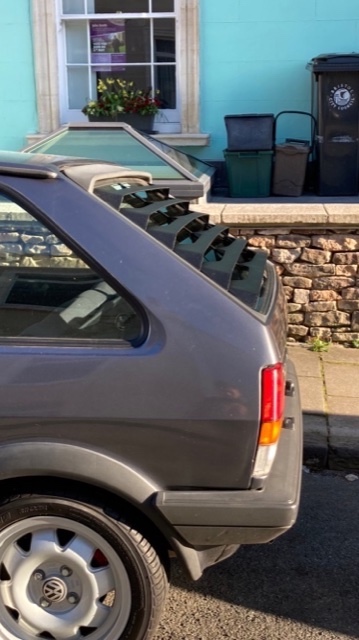

Willysmiles
Armour plates fitted, sprayed them in body colour so they don’t stick out as much.   Thanks for the suggestion guys!

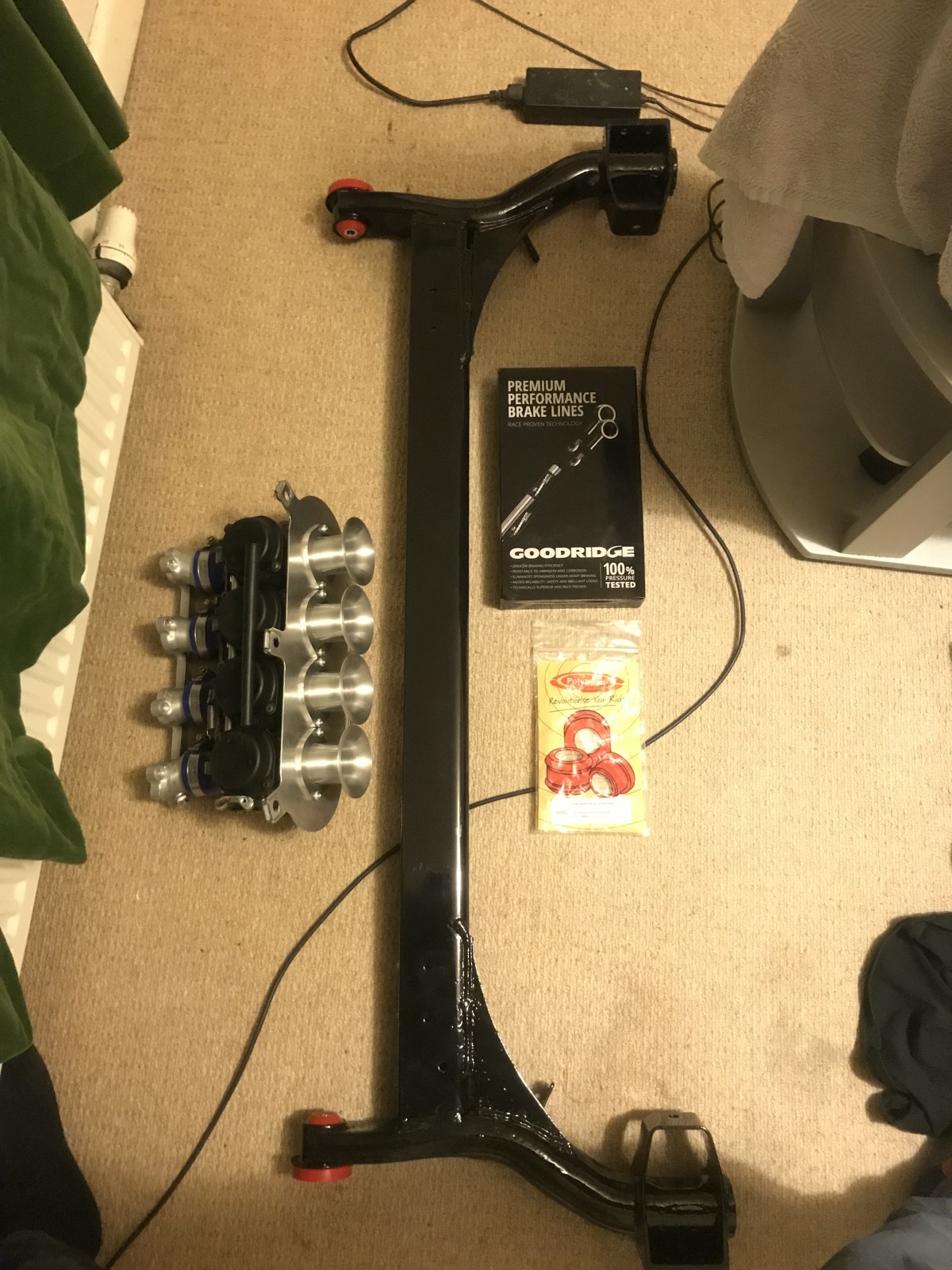

Willysmiles
Ok I panic bought for this Covid-19 ‘lock down’  purchases include:
.powder coated rear beam
.full car polybush kit
.velocity stacks makes the carbs look amazing!
.stainless braided hoses
.vw11 front Calipers and vented disks
.6n2 gti full rear disk brake setup
.newman 264 camshaft and followers.
Plus many stainless fixings and things to bring the car back to life.
Ill take some more photos once I’ve cleaned and painted the Calipers and scrubbed the engine bay.
