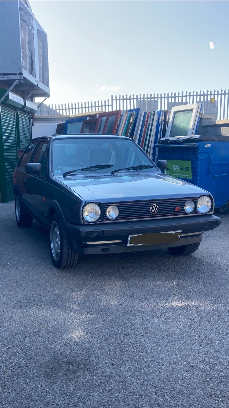

  • Great looking coupe dude, keep the pics coming!   That an 86ish Sunny estate I can see peaking into first pic?
  • Love that!! A neighbour had one that was identical to that other than the wheeltrims. My dad has driven Datsun/Nissan since the 70s so I've a huge soft spot for them.

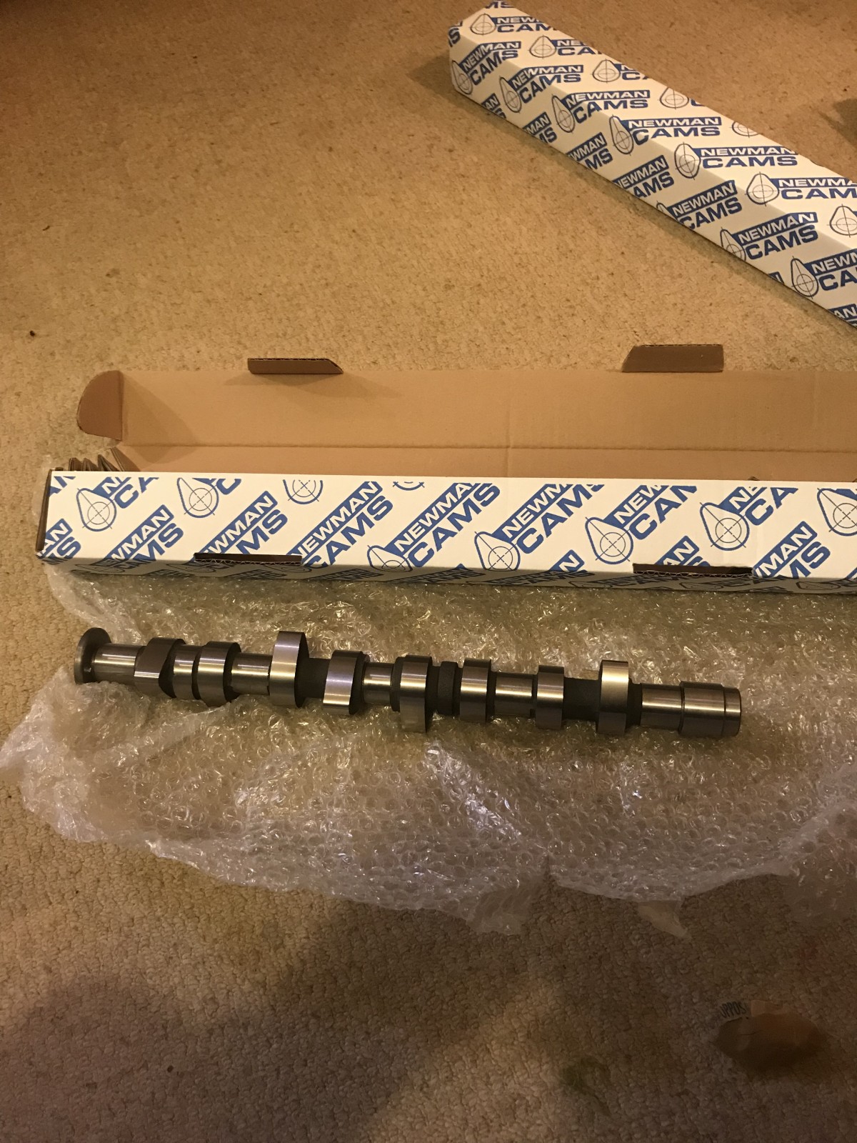

264 cam has arrived today, I went for the 264 as it maintains good low end torque and idle, my car is for fun road use so it still needs to be useable as a daily.

Already bought an INA set along with a seal for the end 🙃 cheers for the heads up
pre-fill hydraluic tappets with oil

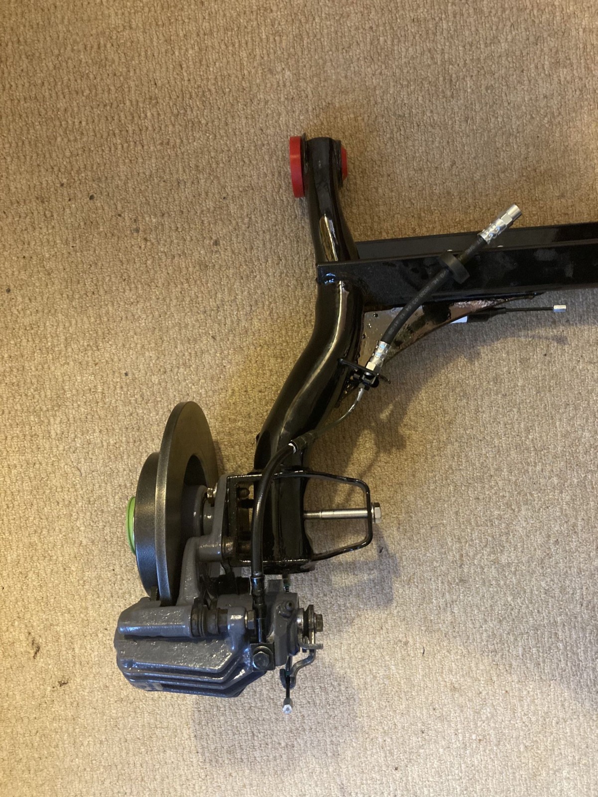

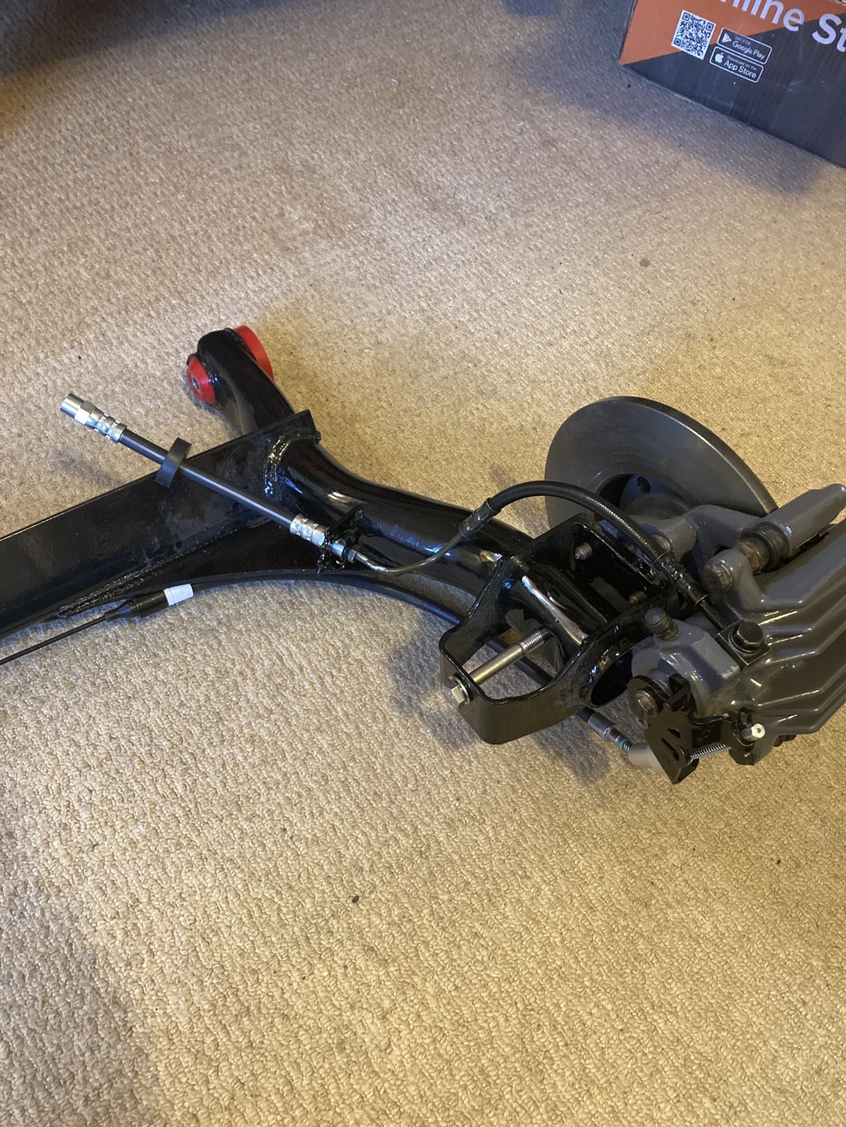

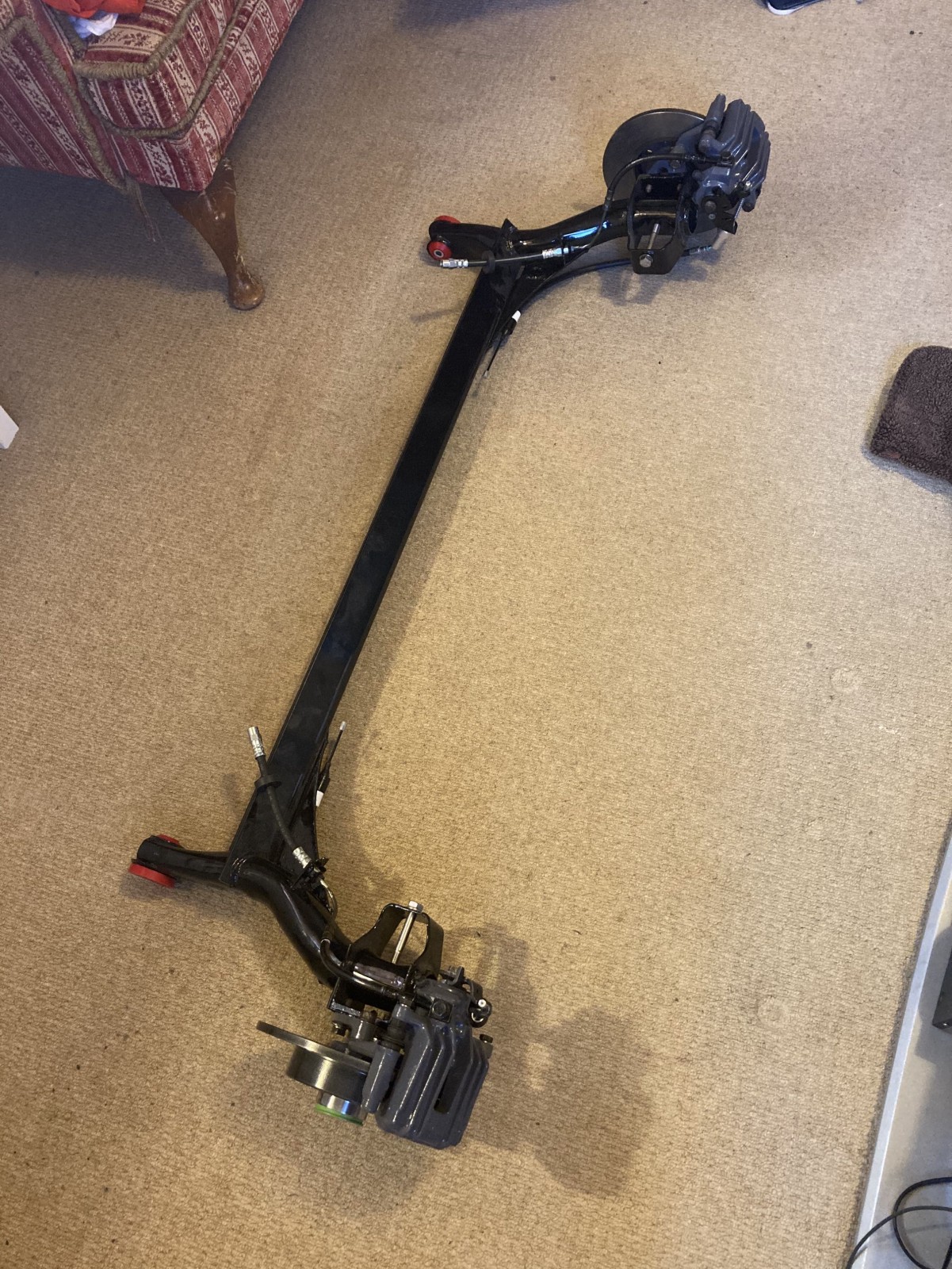

6n2 gti rear brakes, axles ect.
front VW2 callipers with black diamond drilled and grooves disks.     All painted up (before&after) ready to build onto the powder coated beam.

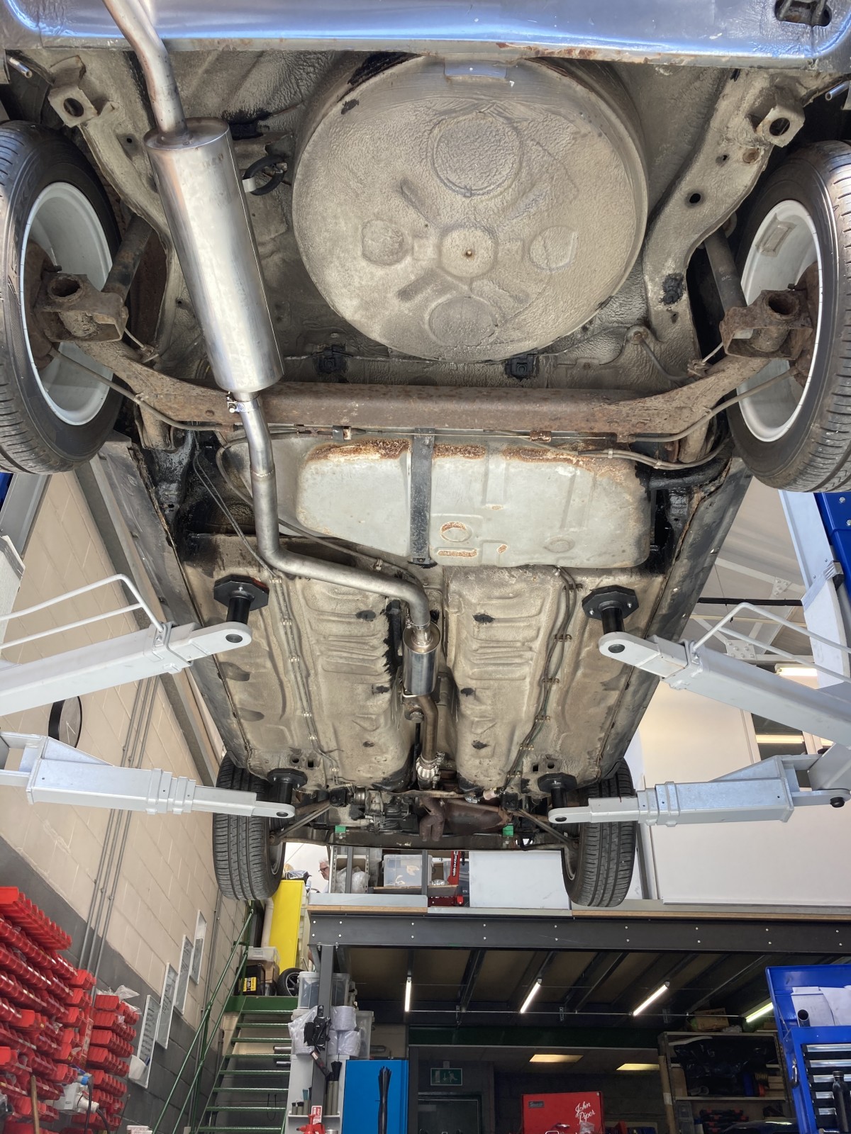

Red pinstripe grill, coupe S badge and blacked out indicator lenses fitted to the front.    Also managed to knock up a full stainless exhaust made from scraps around the workshop from other cars.  Mgb back box and an eBay resonator, sounds amazing and isn’t obnoxiously loud.

ive also done rear brake conversion with the 6n2 gear. rears run hot though. ive got the brake disc dust shields on them so there is no air flow to them
Disk conversion ready, all new parts brembo/febi.
beautiful nice beam. thats one thing i regret not doing but i did so much cudnt be bothered. rear beam and front subframe change would be brill.

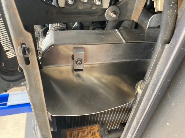

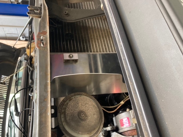

Finally got round to making an aluminium radiator shroud to replace the mouldy cardboard one
Edited by Willysmiles
And remade the radiator brackets much neater

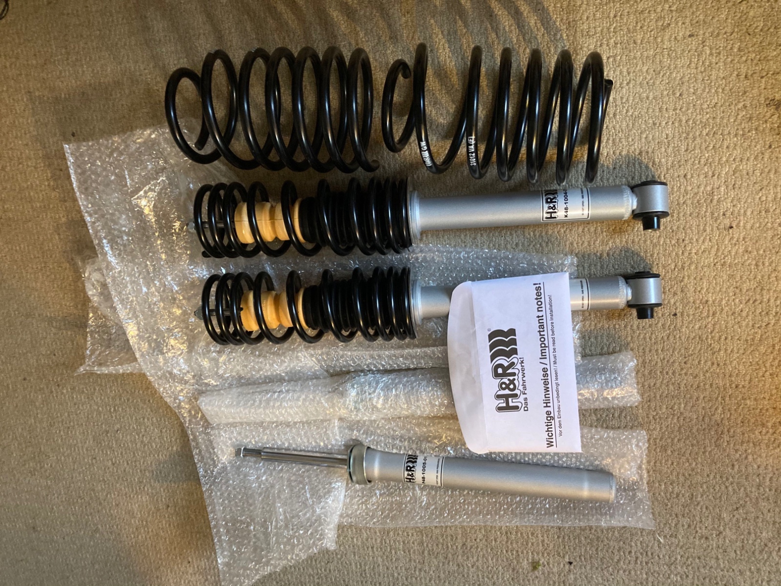

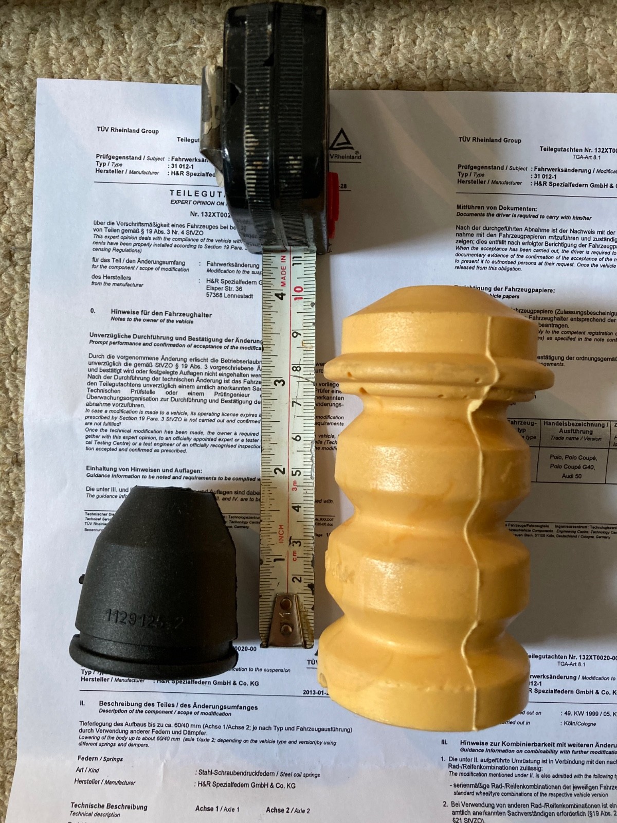

Purchased the H&R cup kit 60/40.   Instructions state 40mm to be removed off the front bump stops,  that’s a little tricky when there only  45mm long.  Chopped them by 30mm and left the rears standard.     Going to be running the 15mm spring spacers on the rear so the car will sit slightly higher than full drop.

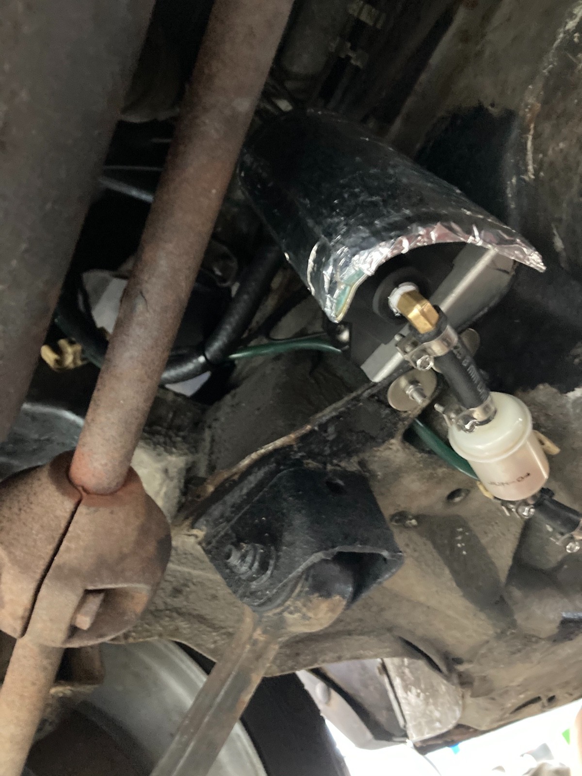

How did you fit the fuel pump ?
It’s mounted off an aluminium bracket just above the front right tca mount.    It’s about inline with the tank so the pumps not working too hard.  Silver thing in the photo is an exhaust heat shield.

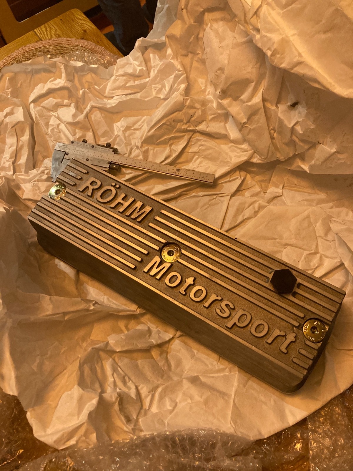

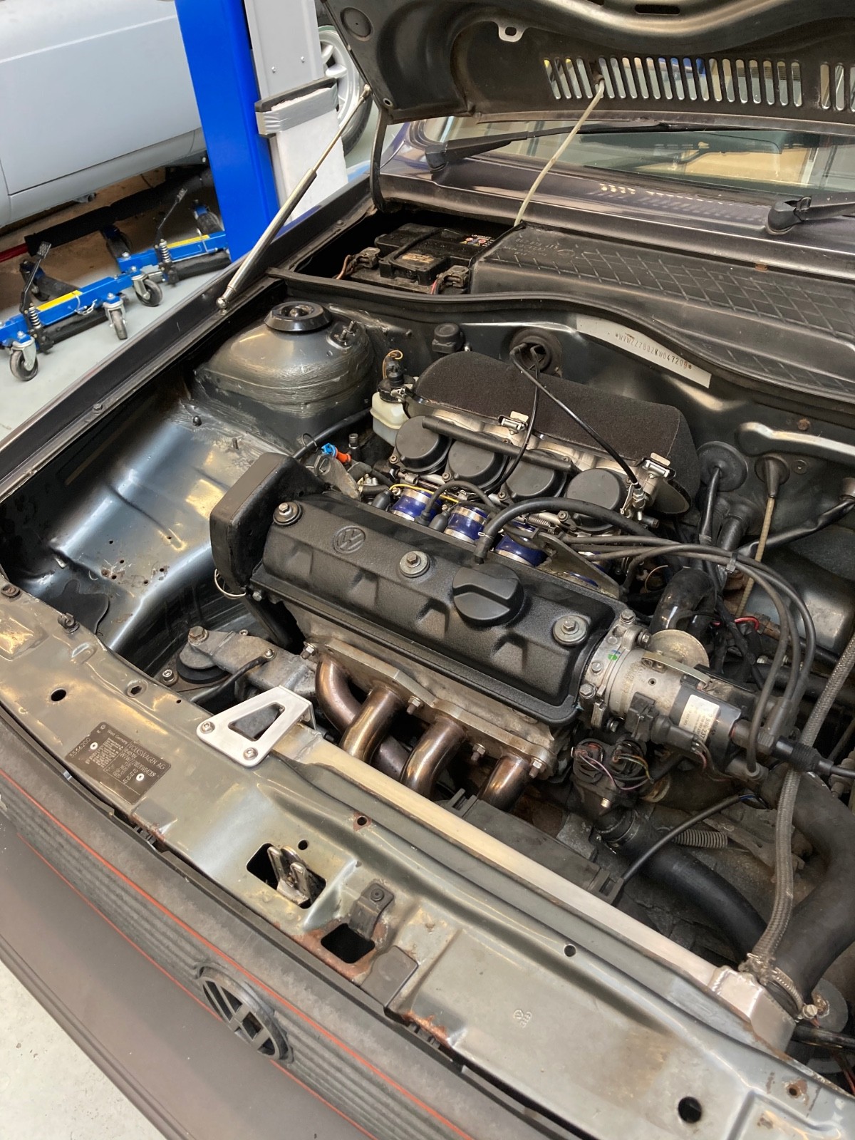

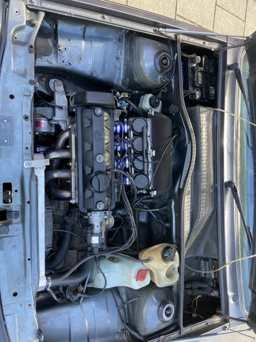

Engine plans coming up, pretty set on an Eaton charged 1.4 ABD on bike carbs. Managed to get this Röhm motorsport rocker cover for the build.
Willy smiles thanks for that . Did you leave the original pump in the tank and just disconnect the power to it ? Also what pump are you using ?
It’s a Mk2 so the fuel pump was mechanical off the camshaft.   I just made a blank plate and took it out.     Facet posi flow 4psi and a Malpassi regulator.
