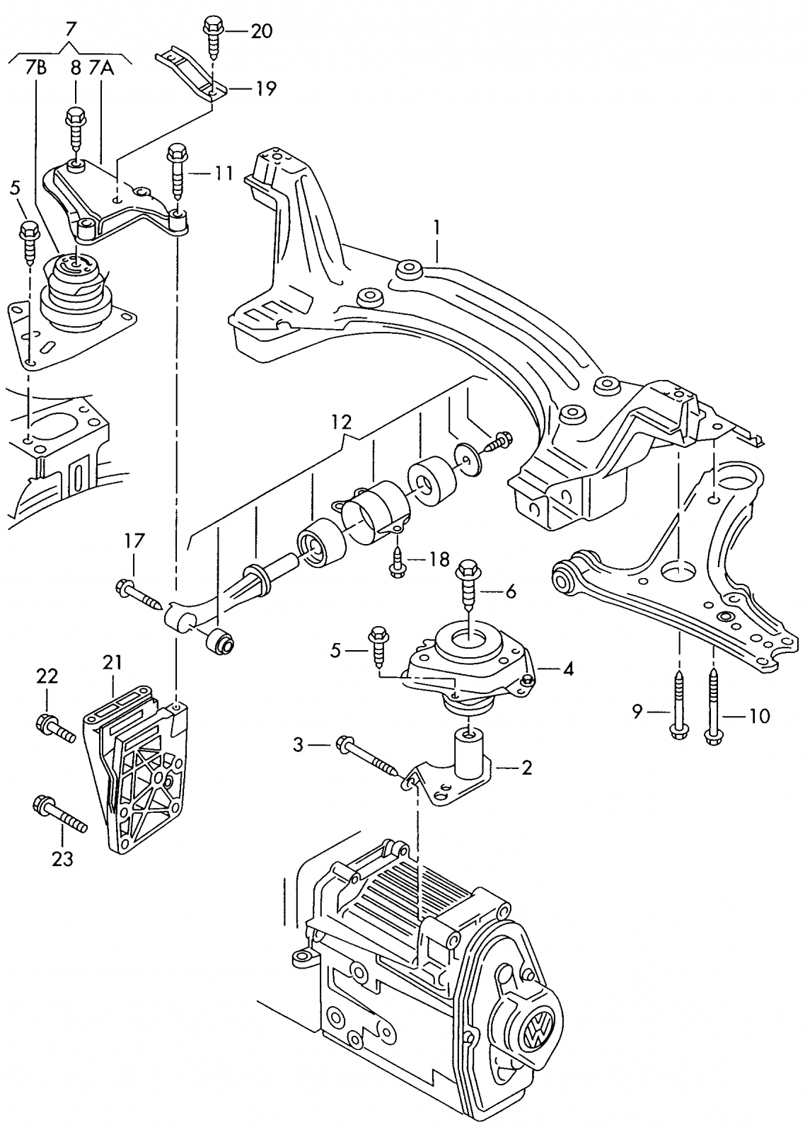

  • Check the "dogbone" mount on the underside of the gearbox #12 in this picture part number 6N0 199 851
  • Get underneath with a bar and recheck your last job. Make sure nothing has worked loose.  Depending on the quality of the part the wishbone bushes may not have lasted.   My suspicion would b
My suspicion would be the rear bush on the wishbone, or as nige says, the rear engine mount, or its link bar.
