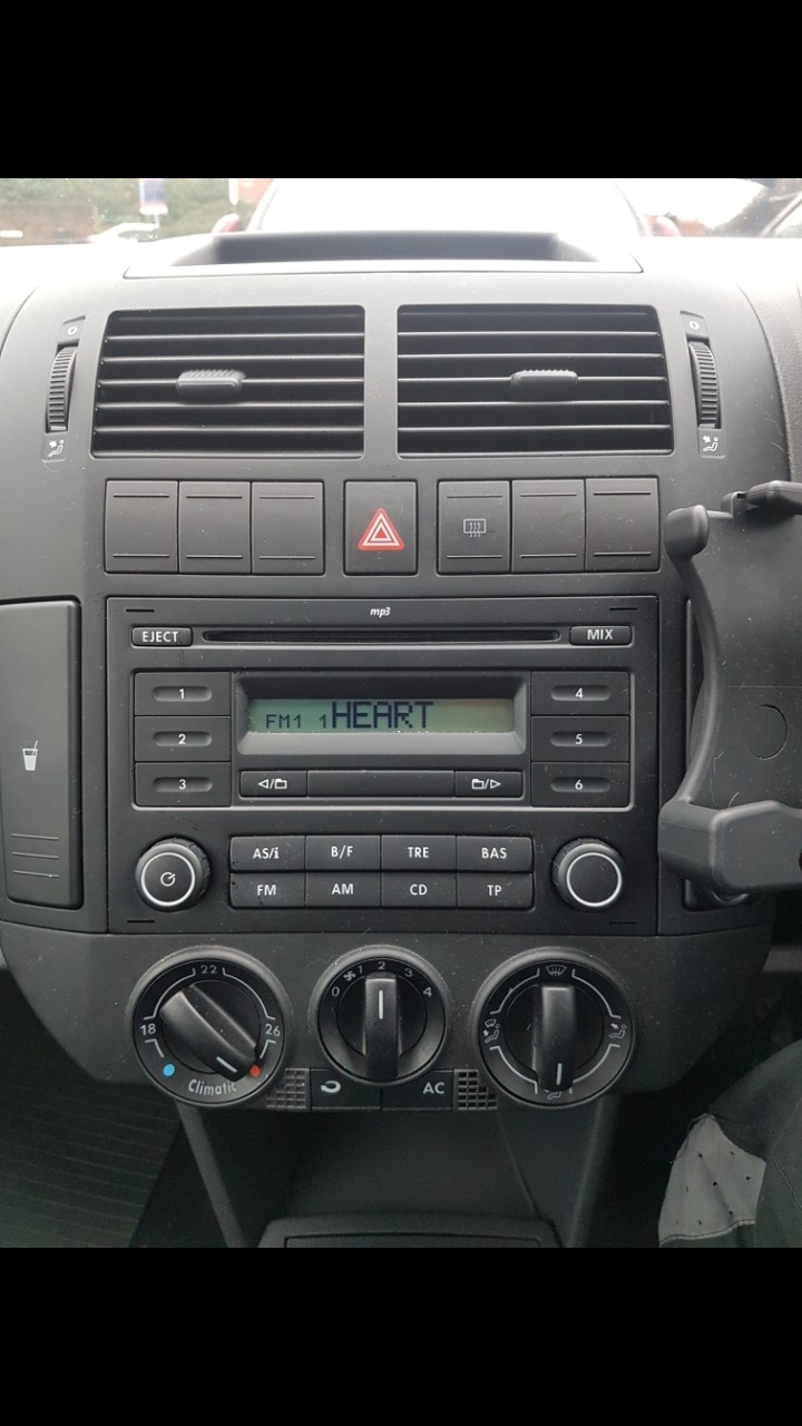

Here's a pic of my dash.
I have updated my radio since I took this pic. Thanks Nige
Edited by RoyTheBoy
How would I know if I only need the sensor fitted in the bumper, wouldn't of thought would display on my dash.

Depending on your speedo some did have an OAT display on them, the sensor is mounted behind the bumper cover on the passenger side

I'd have thought if you have air con you'd already have the external temp sensor. Does your car have the two buttons in the end of the wiper stalk for stepping through displays on the clocks?
I'm 90% sure that the mirrors don't heat unless the heated rear screen is on on my Fabia, and that has it's own 10 minute timer. Can't imagine it being different on the Polo. I think the 2k Caddy is the same as well.
Mine has no button on the stalk just the reset Mileage button where the speedos are that you can turn left and right to set the clock, deffinatelly not got the oat function, I thought Nige meant that the manufacturer left the display part there on some models.

The OAT display would of been standard on some versions like if you have climatronic AC not the manual version you have
