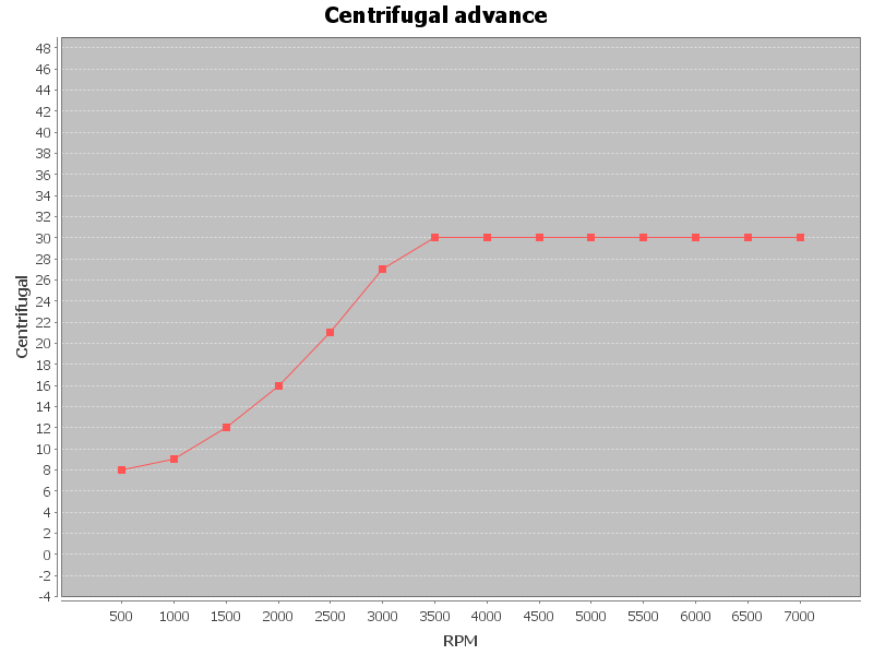

Here's the "centrifugal" advance curve if anyone is using another programmable ignition.
Edited by dvderlm
The graph does not show the +1 offset...
or the 5 static
or the vacuum related extra advance which is quite crude as this is the turbo Amethyst.
One day...
