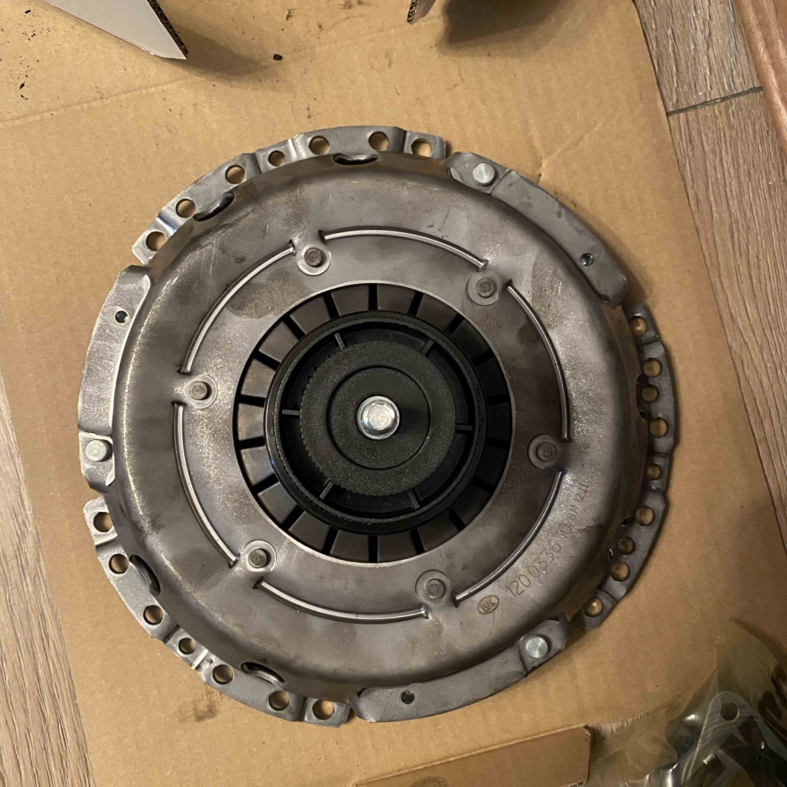

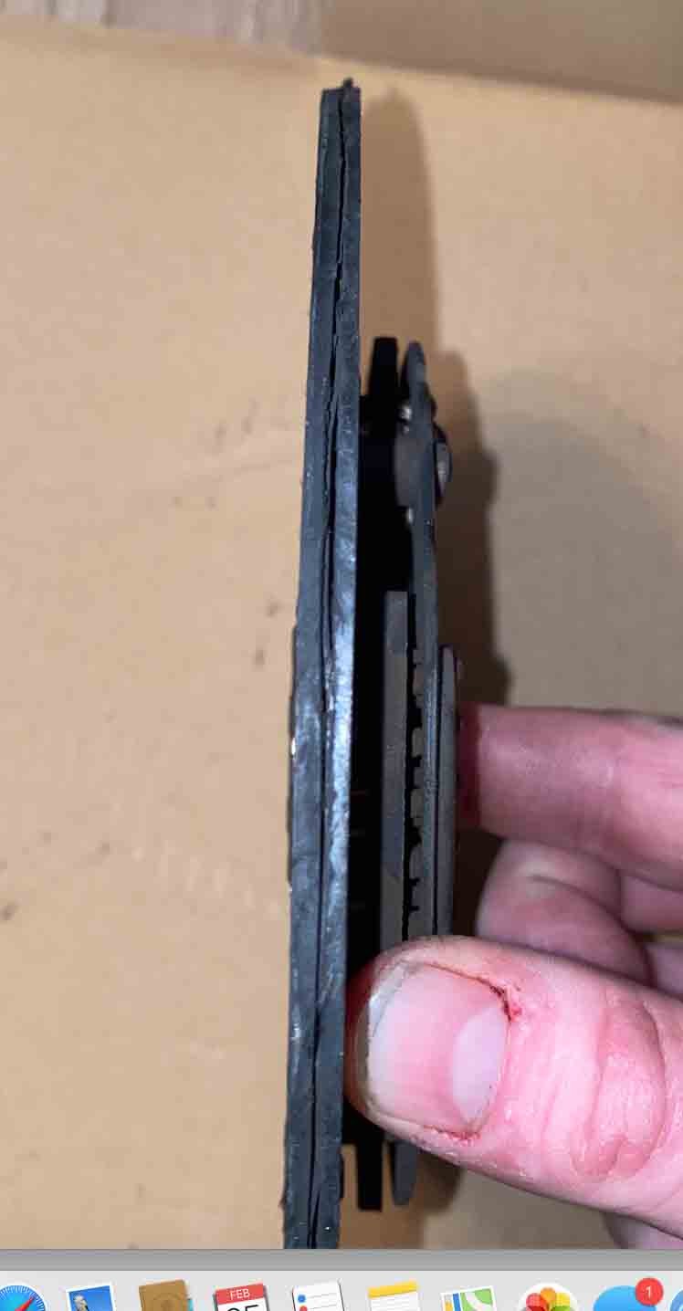

gearbox out today and clutch plate worn, does it matter which way the new clutch kit goes? as i forgot to mark it, same with the flanges, here is a picture of the clutch, and the flywheel ? ( if its what its called?) thats on the inside of the engine where the clutch plate goes on - how do i know if that is worn and need changing?374364401_Screenshot2020-02-25at17_13_13copy.thumb.jpg.5bad0a87dbebfe4bb9f2416d5c6ff302.jpg
Normally on the clutch plate there is stamped on the metal centre part "flywheel/engine side" or something like that

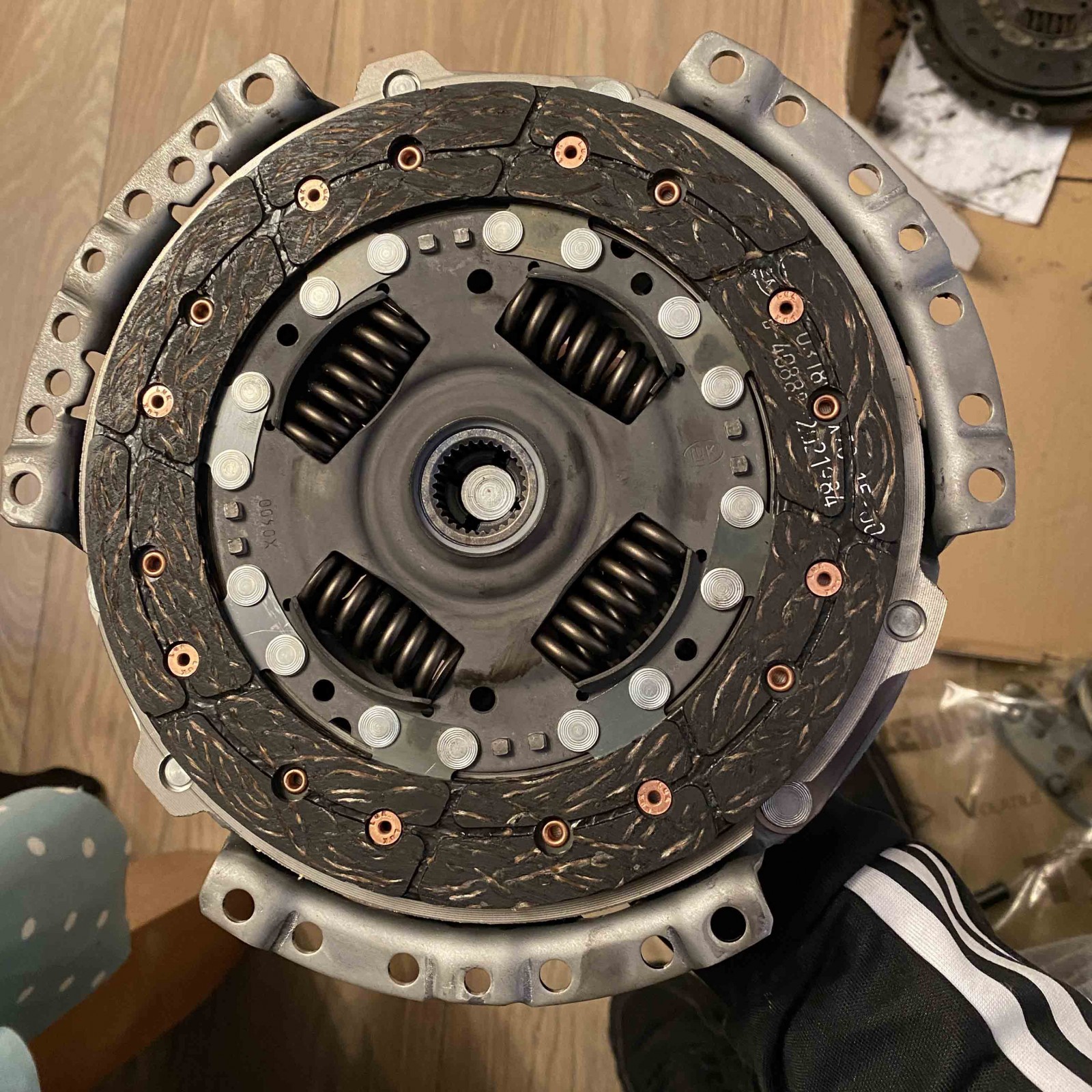

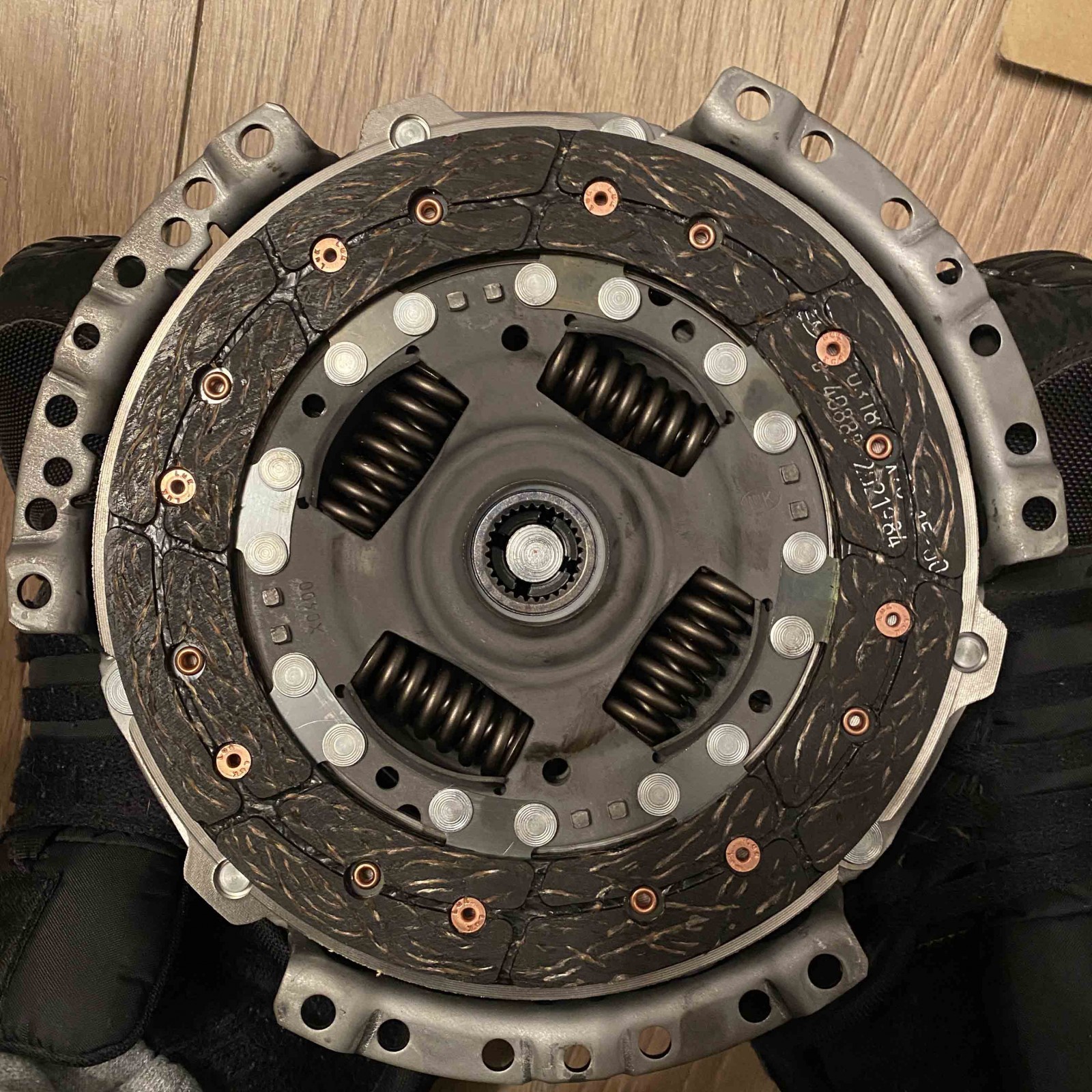

also ive just used the clutch aliment tool, does this look ok?new1.thumb.jpg.59f8480857cb9b90011c78f49a743135.jpgnew.thumb.jpg.de44220105dea8bc7c2f9a08641f3ac6.jpg

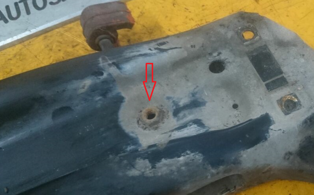

hi all clutch in today but having trouble with the drives shafts, they dont seem to turn all the way round with wheels on, wondering if ive pulled out the cv joints, started car up and clutch is fine and gears go in ok, not drove it tho as wheels wont go all the way around also the lower gearbox mount bolt just keeps spinning in its hole, what size bolt do i need to replace it?bolt goes into the round bit see pic
Not sure about the driveshafts, but be very careful what you do with that rearmost dogbone bolt. The (M10) OEM one is 61mm long, whatever you do, DON'T put anything longer in there, the steering rack is right above the captive nut that that goes into, and putting even a 65mm long bolt in there dents and wrecks the hydraulic bit of the rack. That's why it's important not to mix up this bolt with some of the 65mm long ones that hold the gearbox to the block.
Unless the bolt thread looks badly damaged, it sounds like you may have stripped the thread in the captive nut, or it's broken free and is no longer captive. Tricky...

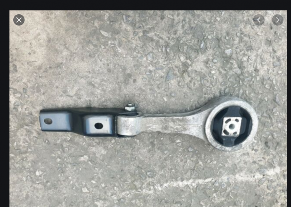

yeah i can see the captive nut on the top near the rack and when i turn the bolt it just turns but the captive nut doesnt move and the bolt wont drop out? seems to hold it in there but loose and engine moves forward on revs? maybe drill a new hole? p.s sorted drive shafts cv joint had popped out of the drive side innercv joint, cant seem to get it back in yet, raining all day here, think i may have to take the drive shaft out and take cv boot off to see whats going to.....
had a look today and the bolt has snapped off in the captive nut, any ideas ? if i drill the bolt out it may damage the captive nut? can i join the gearbox mount under the sub frame(just under where it supposed to seat, and put a new bolt through it a and put a nut through where the mount is supposed to go, this will hold it but will it be ok for mot? also clutch pedal very low after clutch change, biting point just off floor?
