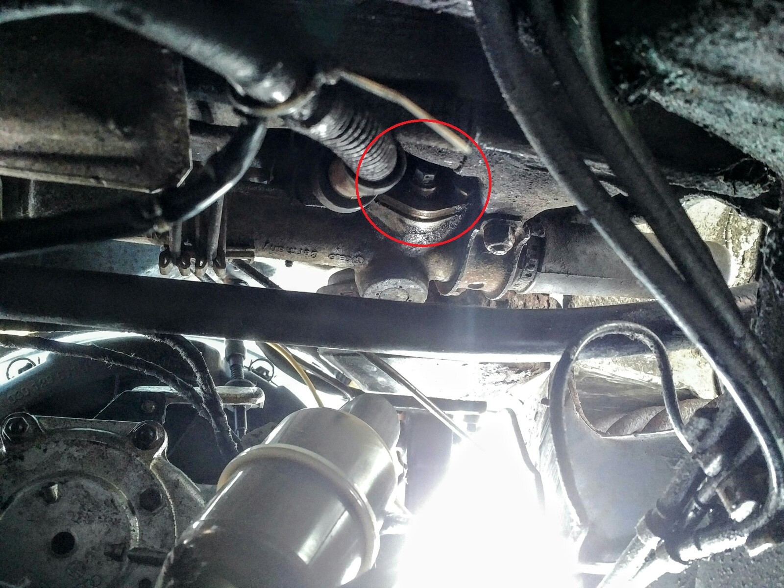

You -may- be able to take up a little of that slack by tightening the thrust bearing screw on the underside of the rack. Its a pig to get to but you can reach it lying underneath the car with the front on stands. Mine was sloppy around the centre and had a 'click' at ~11 and 1 o'clock and tightening this up (just a smidge, mind) sorted that out. It can only help so far though - if the gear is too worn in the centre then there's not much can be done without a new rack.
You'll know if the bearing is too tight if you can no longer turn the wheel to full lock so test each adjustment across the full range.
Thats the adjustment screw there, viewed when on your back!
