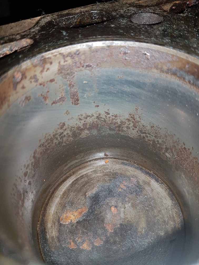

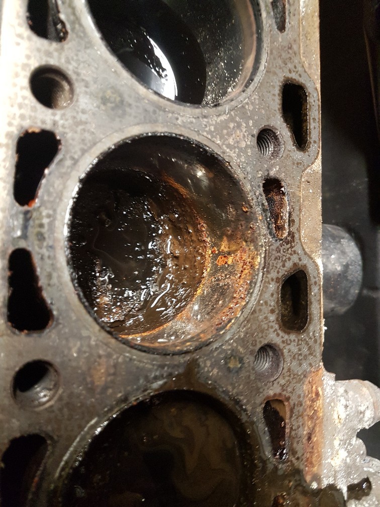

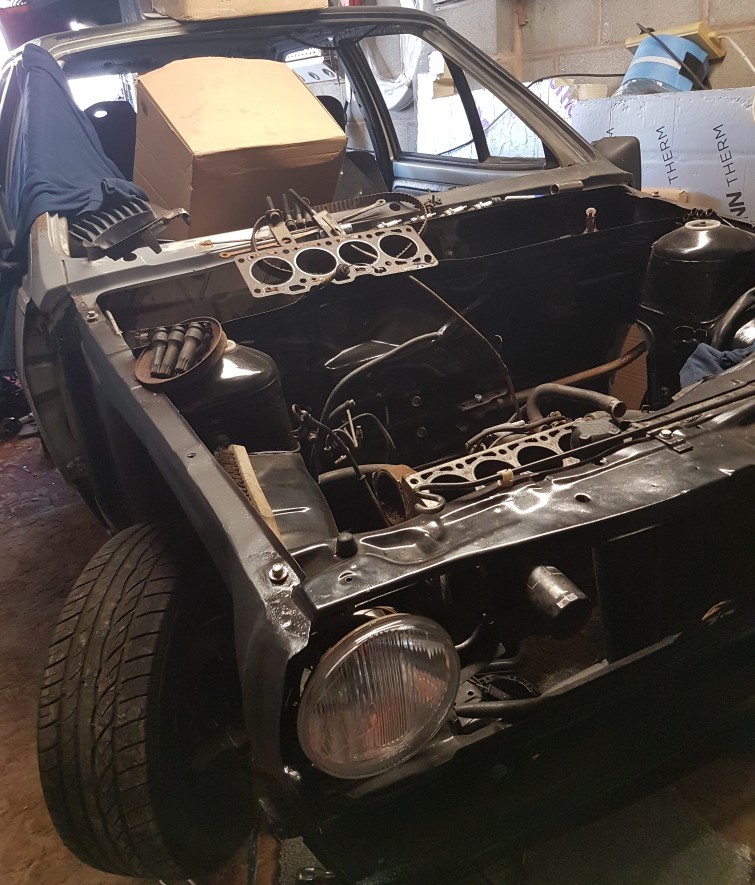

Firstly I started on the engine, I tried turning it over by hand and it was having none of it so I pulled the head and was greeted by this very unfortunate sight

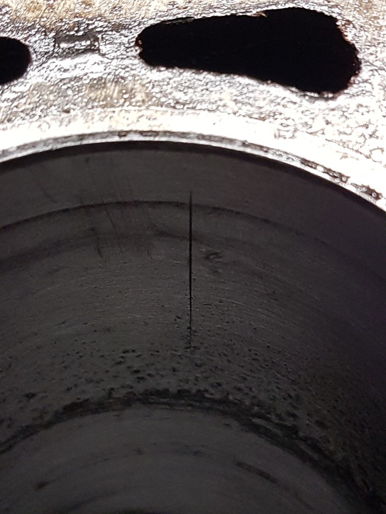

So I cleaned it all out and started honing the cylinders only to find this

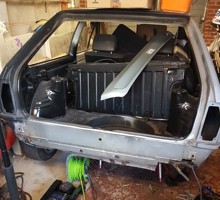

    Forgot to add a pic of the complete car (in pieces)    More info to come when I get the replacement engine and rotisserie to make the underneath prep/welding much easier!

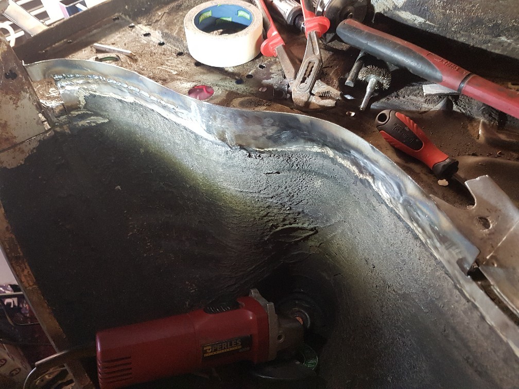

So while I pondered engine solutions, i thought I'd tackle some of the rust issues.
20200323_112543-756x1008.jpg.f0c7e8962564b6012b6264d1824e06ba.jpg20200328_134341-1008x756.jpg.6975ee17c87169ff539c1254188c6a5b.jpg20200328_134357-1008x756.jpg.b9456c04684d619fbc85d3329afcc386.jpg20200328_134416-756x1008.jpg.f24379edf32fd8a288766aba37410204.jpg20200402_222435-1008x359.jpg.d3b335cabc1a80df3aed885e9288e603.jpg
20200324_094118-755x885.jpg.73f55446cc0f0729644919854219c523.jpg20200324_094016-751x682.jpg.ddbfb0f06e0b8cf9b607bff1f6c830c0.jpg

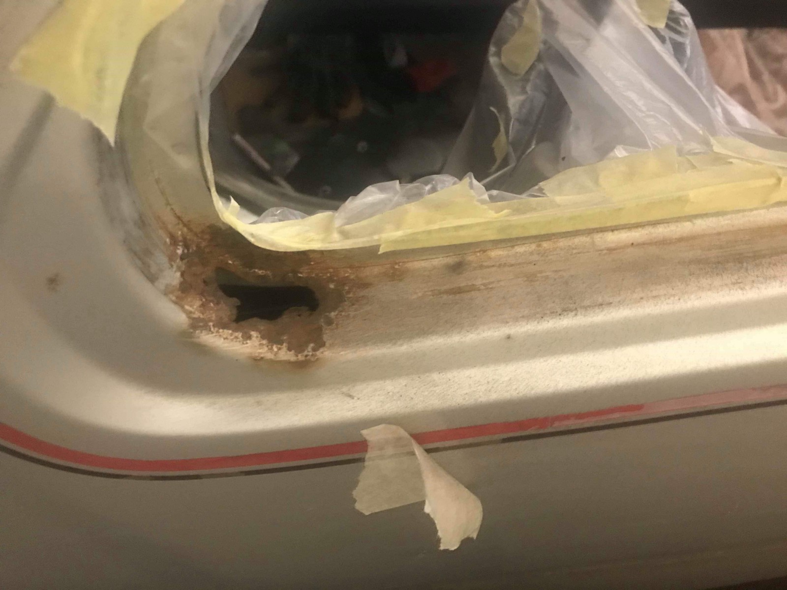

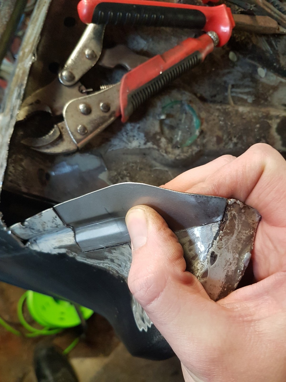

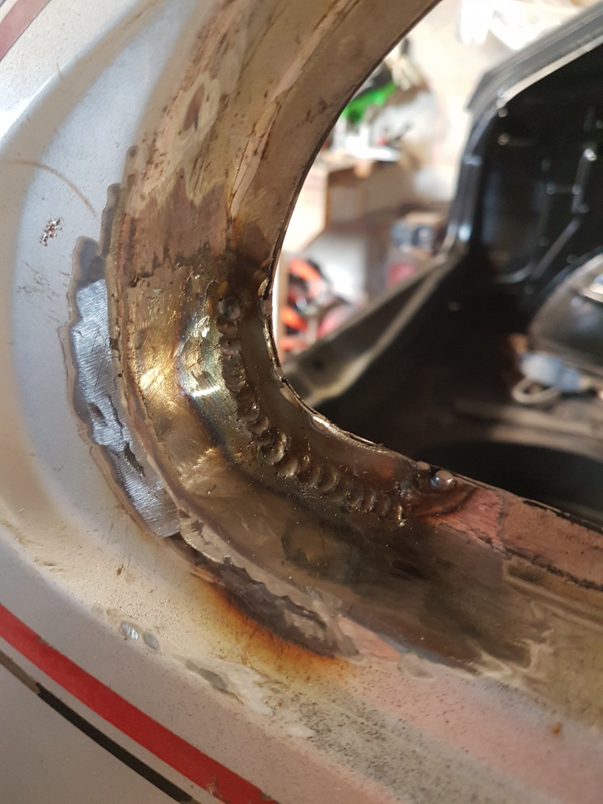

Rear window corner was rotten, just wants a bit of cleaning up once I get a die grinder.
One of the more fiddly bits!

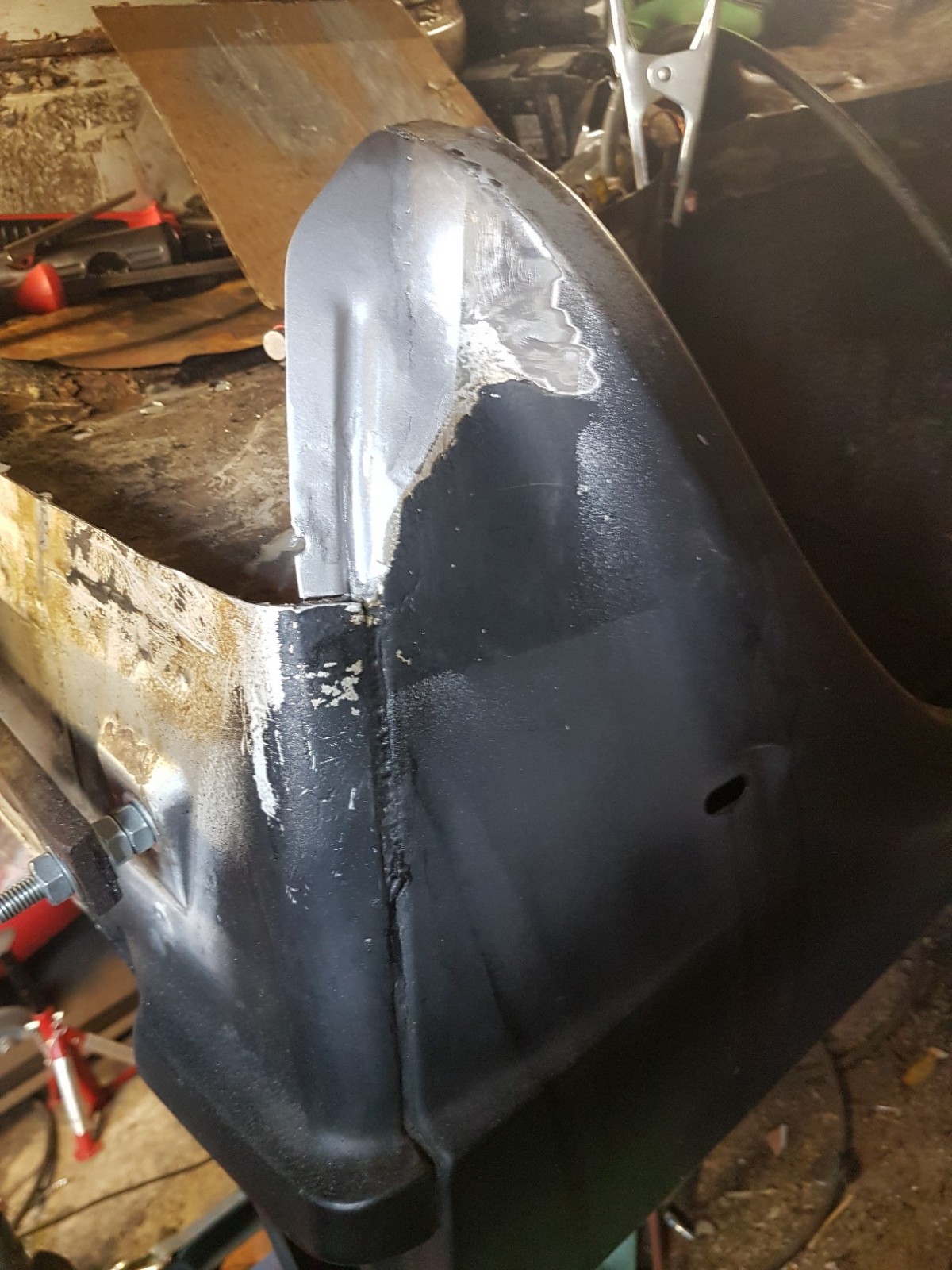

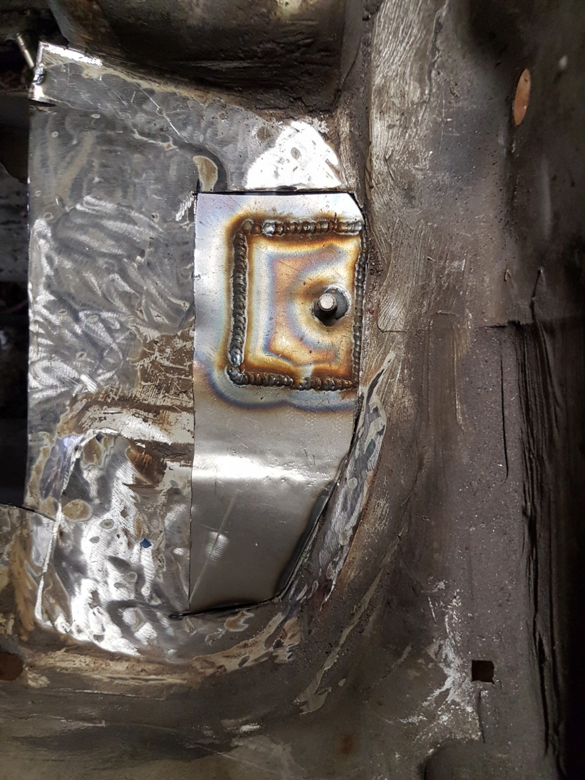

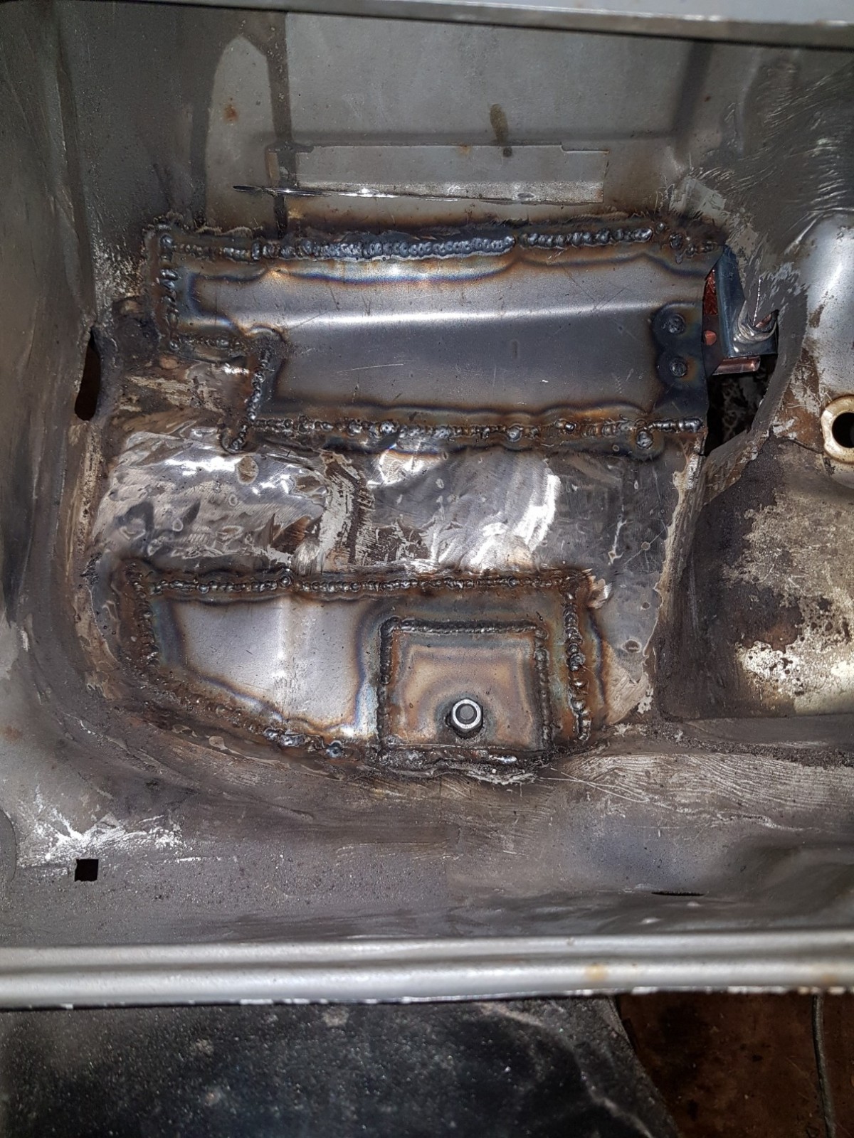

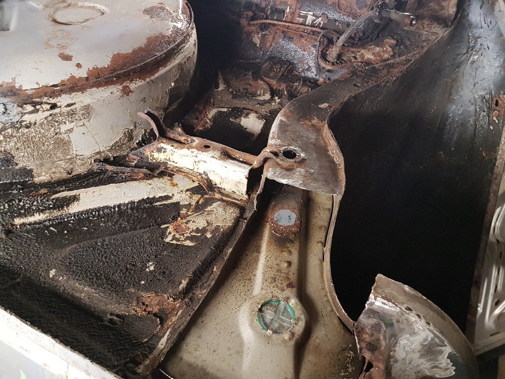

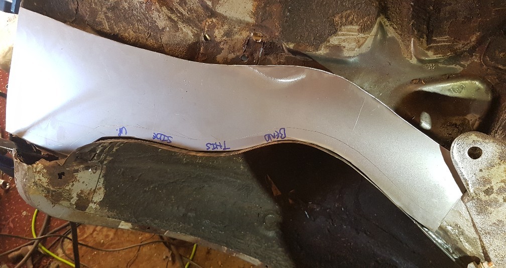

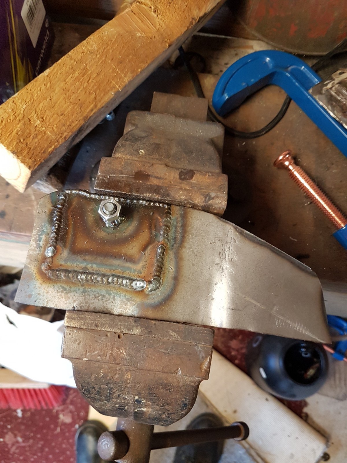

Little bit of an update (Just a bit more metalwork)
20200408_132151_copy_1209x1612.thumb.jpg.5713fd7c2c755592a385328679c4d276.jpg20200408_131337_copy_1209x1612.thumb.jpg.6643a39097f2702dcb89b1635410f9f3.jpg20200409_133200_copy_1209x1612.thumb.jpg.89b2647418f28e49a81dc5ef9349c39b.jpg
hasn't been cleaned up yet as I've got a couple more bits to go in before work tomorrow, managed to retain the shape of the battery tray so far!
Great job, awkward enough repair that. There is a panel available but with vat and post was going to end up at over £80 for mine
Yeah it is quite awkward to get in with the grinder at certain angles, I saw the complete battery tray but decided not to bother for that price! There should be a hole in the plate I've put in next to the battery clamp that goes through to the inner wing via the inside of the car, should there be a pipe connecting the two? Can't see vw designing it so that water would run inside the car before it goes out through the inner wing? Anyway I haven't drilled it out for now, I've angled the plates slightly  to run towards the big drain hole at the end of the scuttle, should be more than enough!

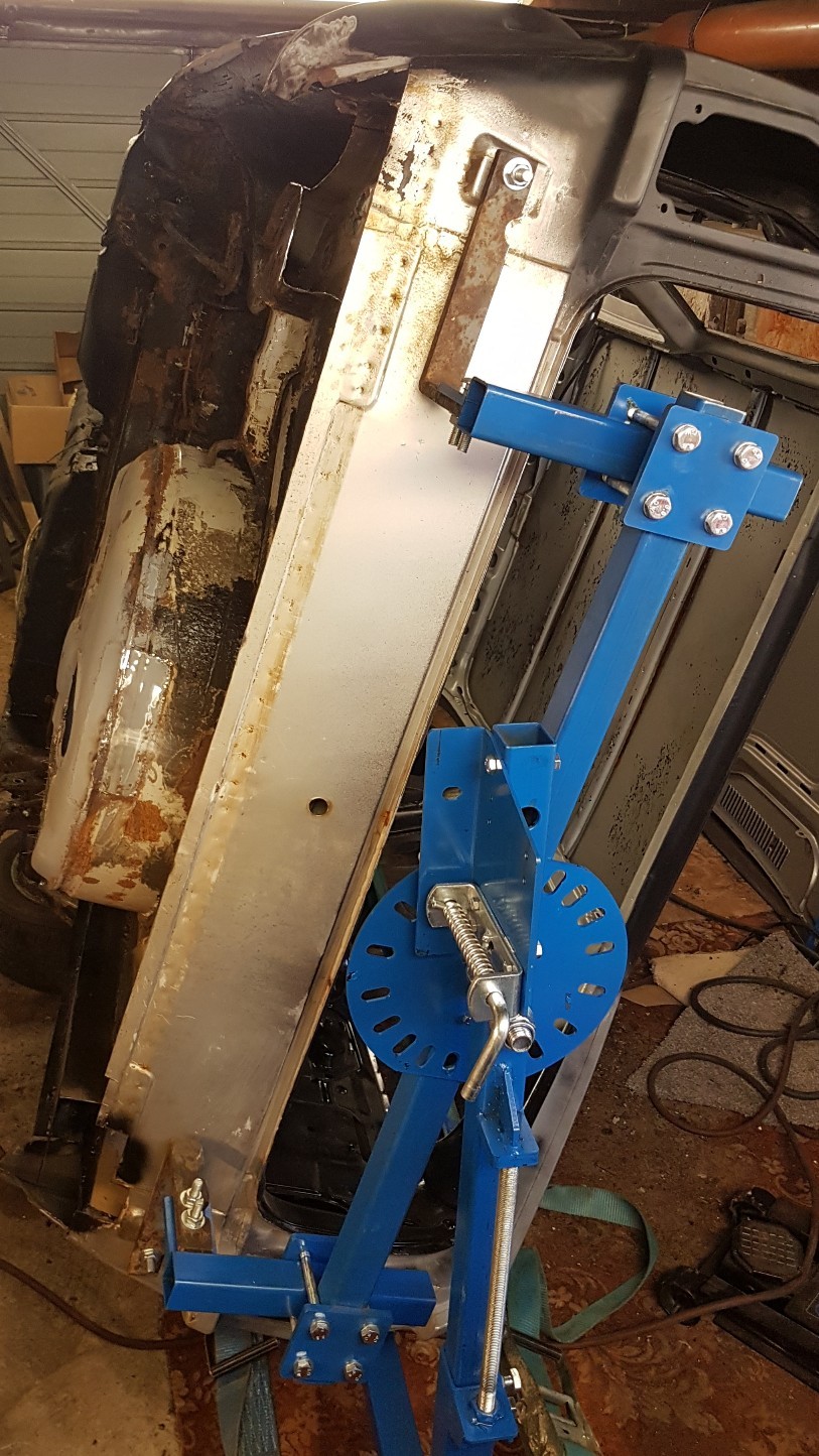

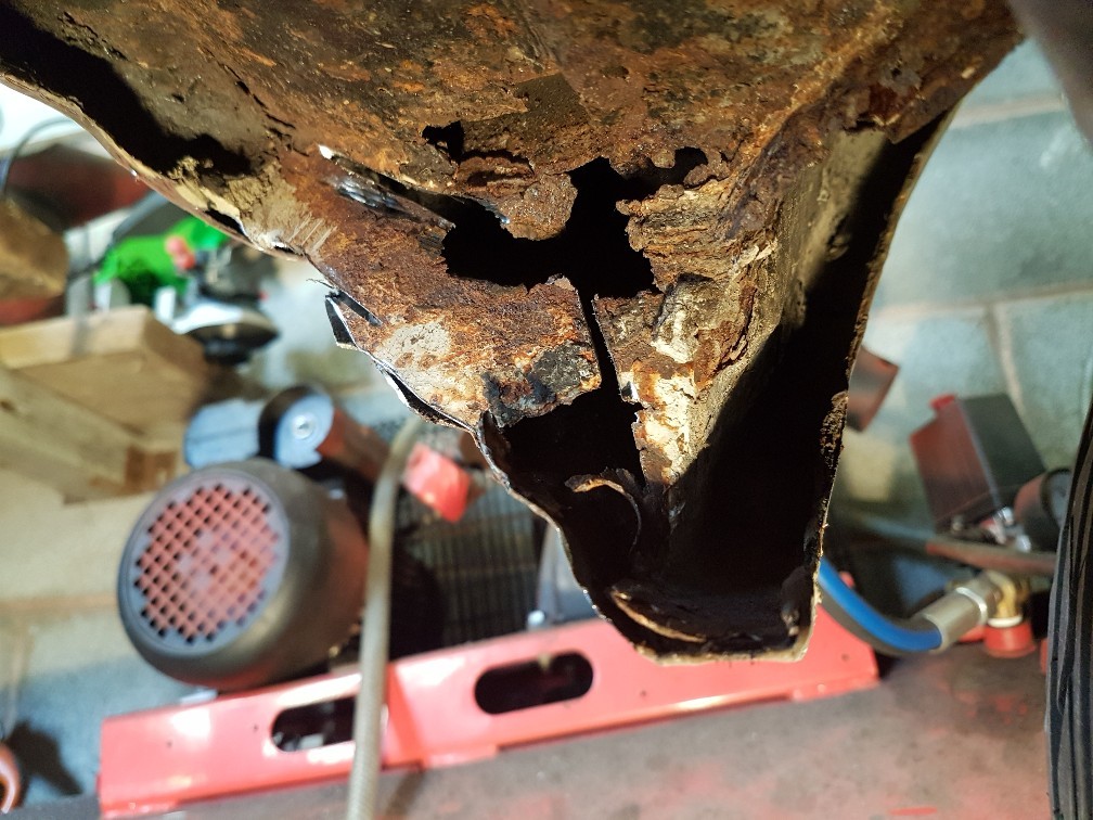

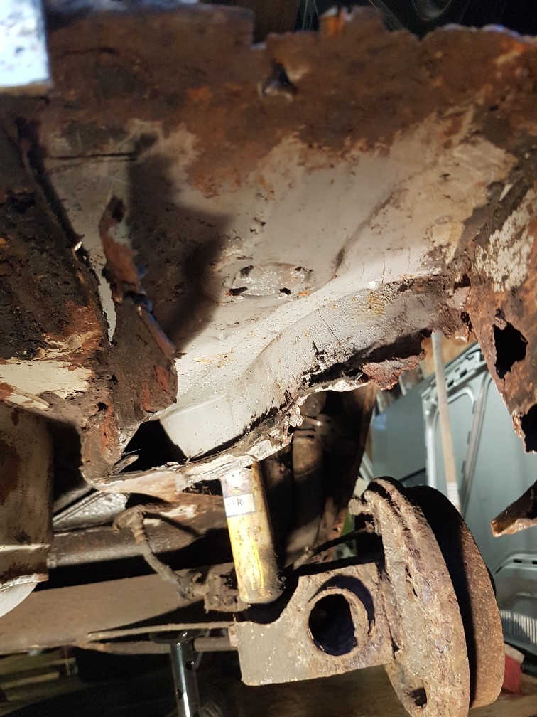

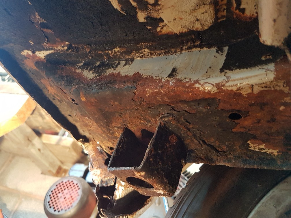

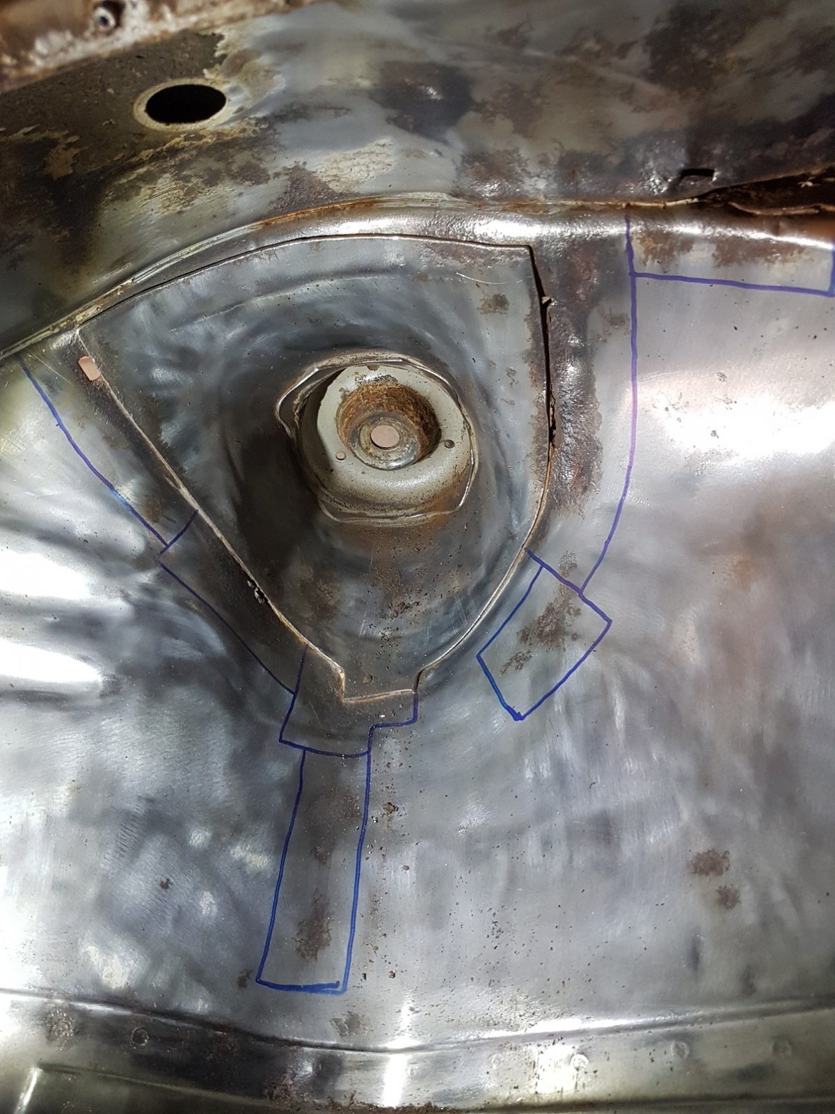

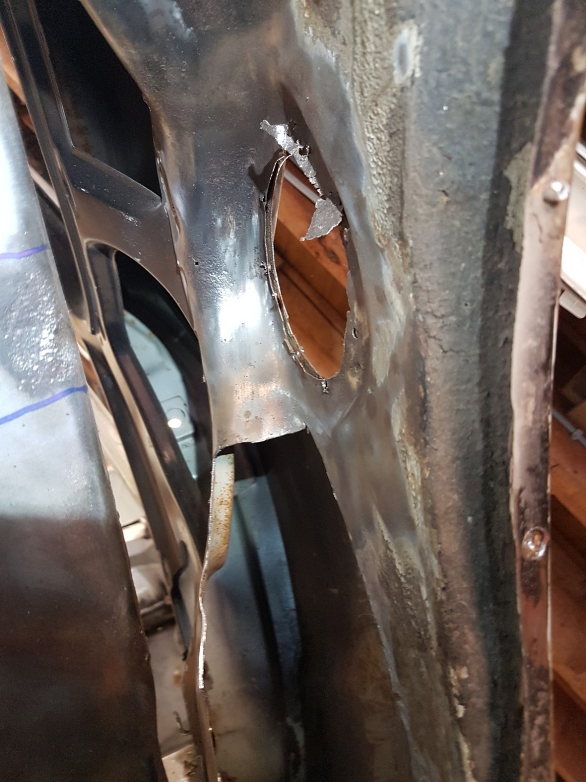

Little bit of an update, finally got a rotisserie sorted! Making life much easier getting underneath to repair the metalwork! Although now I've got a good view of it I've found more 😕
20200421_124205_copy_813x1445.thumb.jpg.73f338007a999a96fd3f05348108a6af.jpg20200423_121219_copy_1209x1612.thumb.jpg.72d3fab82421538e876163a6a89aefc6.jpg20200423_121211_copy_1209x1612.thumb.jpg.051926f8cc9a12cd3ffef285a86044a1.jpg

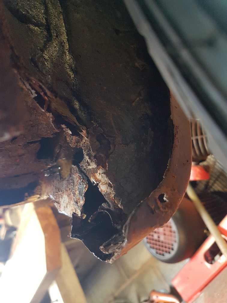

A bit more work done, removed the chassis leg as a whole rather than patching bits in, made the new pieces they just need folding, welding together and a bit of adjustment. Also replaced the lip on the bottom of the inner arch as that was rotten 20200428_130838_copy_1008x756.jpg.d4d498ac5567d0c3cf4b6701c04dbbb8.jpg

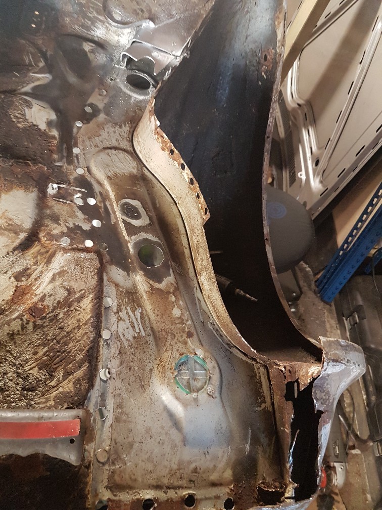

Little bit more progress, mainly spent cleaning the underseal off but I've replaced a few little bits
20200504_141617_copy_1209x1612.thumb.jpg.992a5df94f53d211ec45849df15d469a.jpg20200504_151952_copy_1209x1612.thumb.jpg.ce5b74cdfbf64267d8dd99bb7ae9ad80.jpg
decided to scrap the chassis pieces I made and order new ones from vw classic parts in Germany, didn't know they were available!
