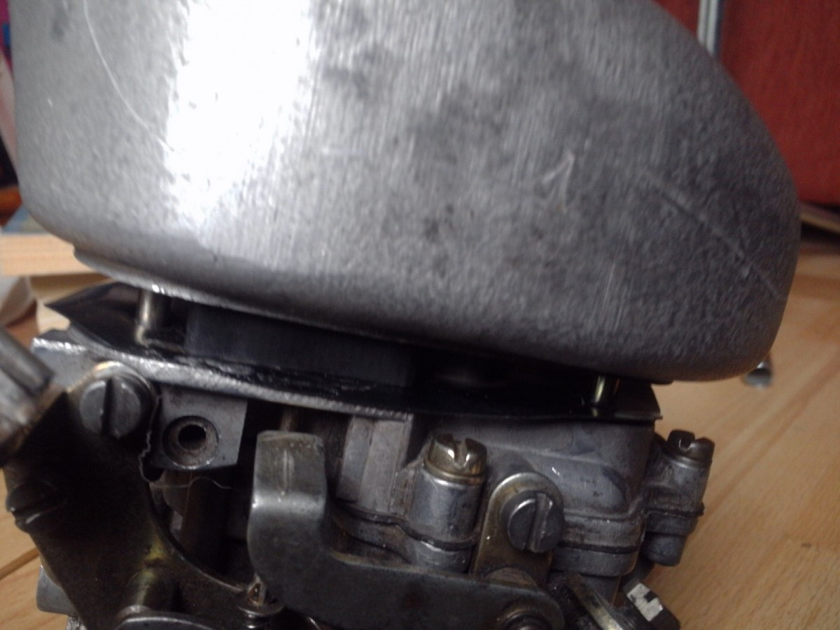

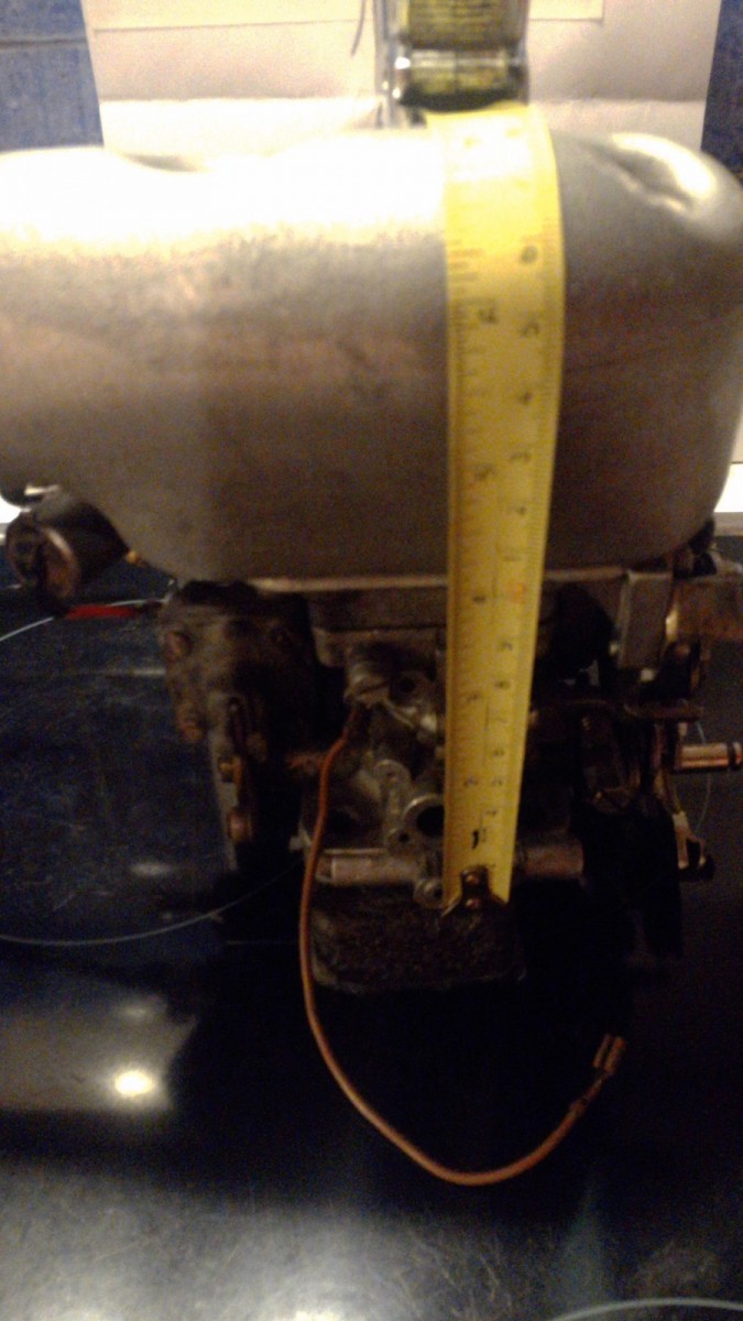

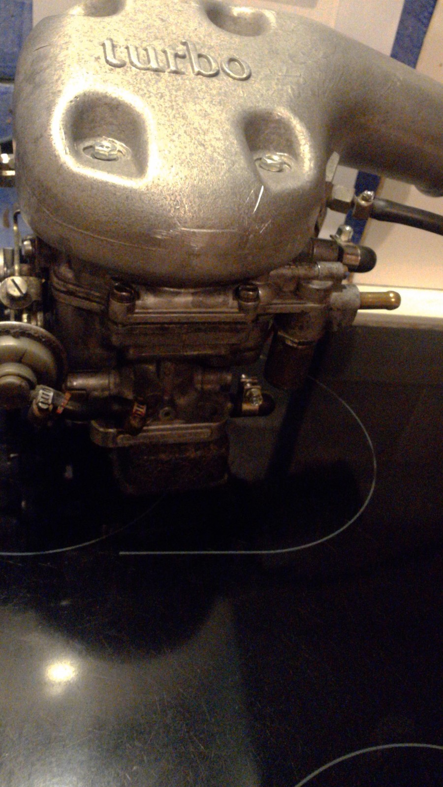

might need a bonnet power bulge
Might need some bonnet surgery for a power bulge...
Think it is 166mm high without any gasket!

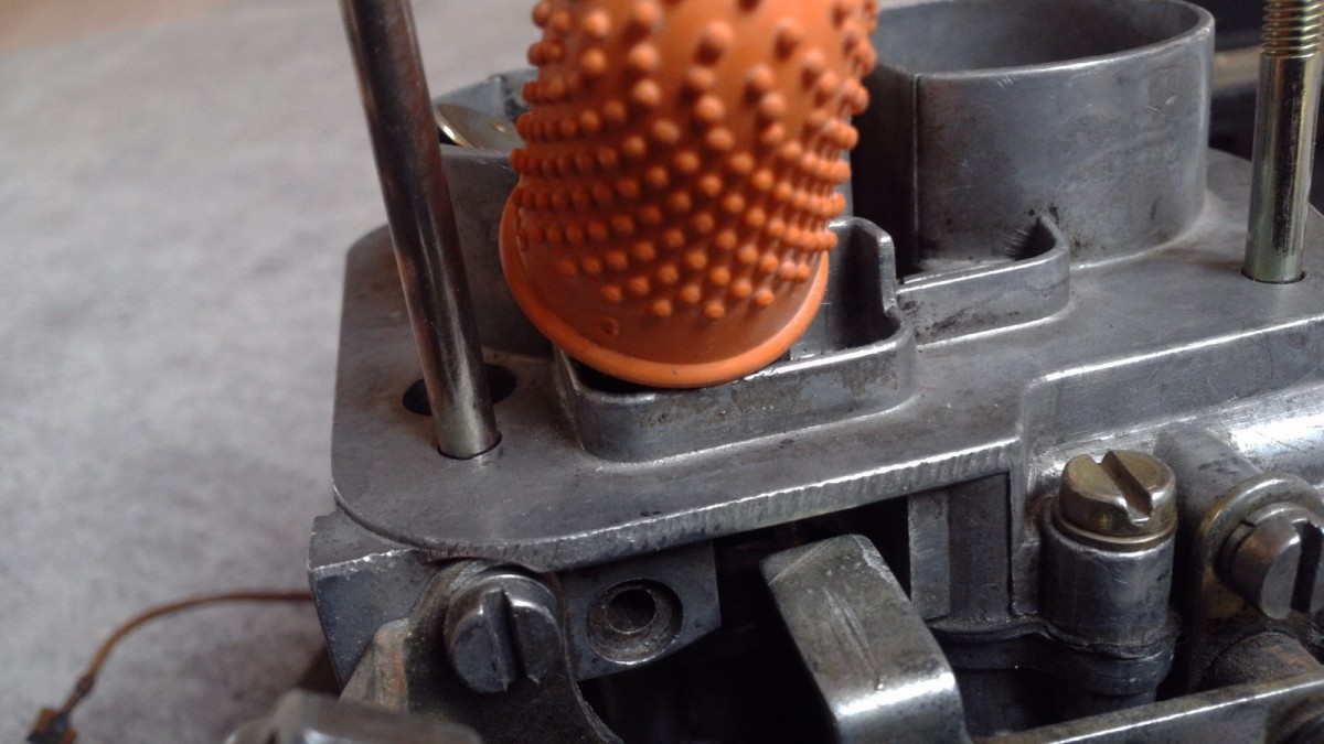

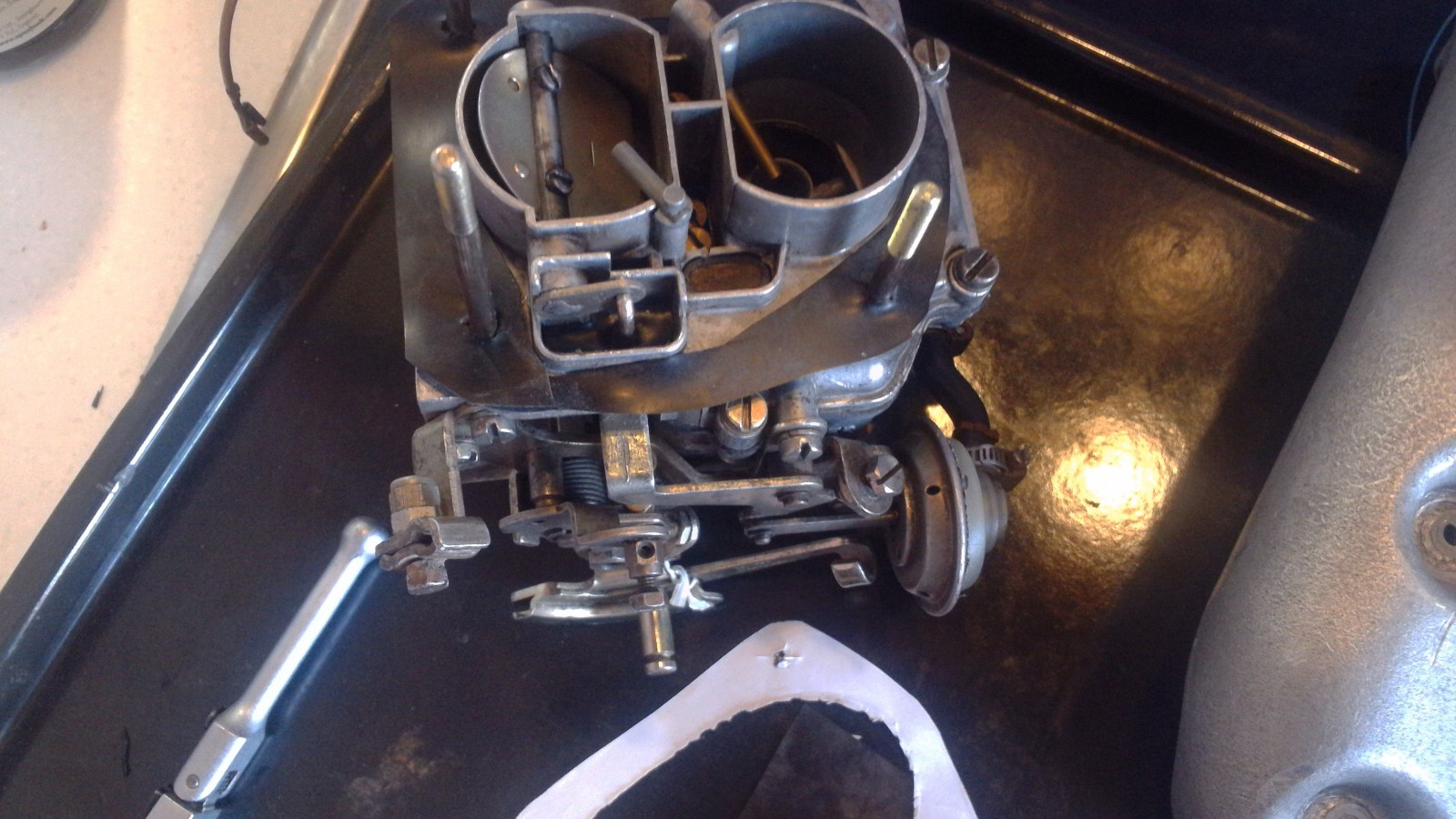

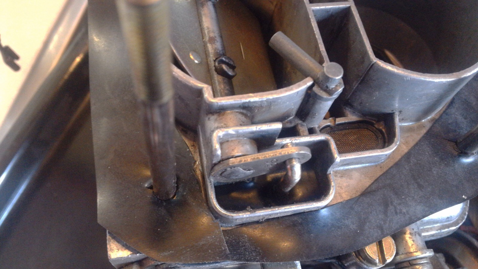

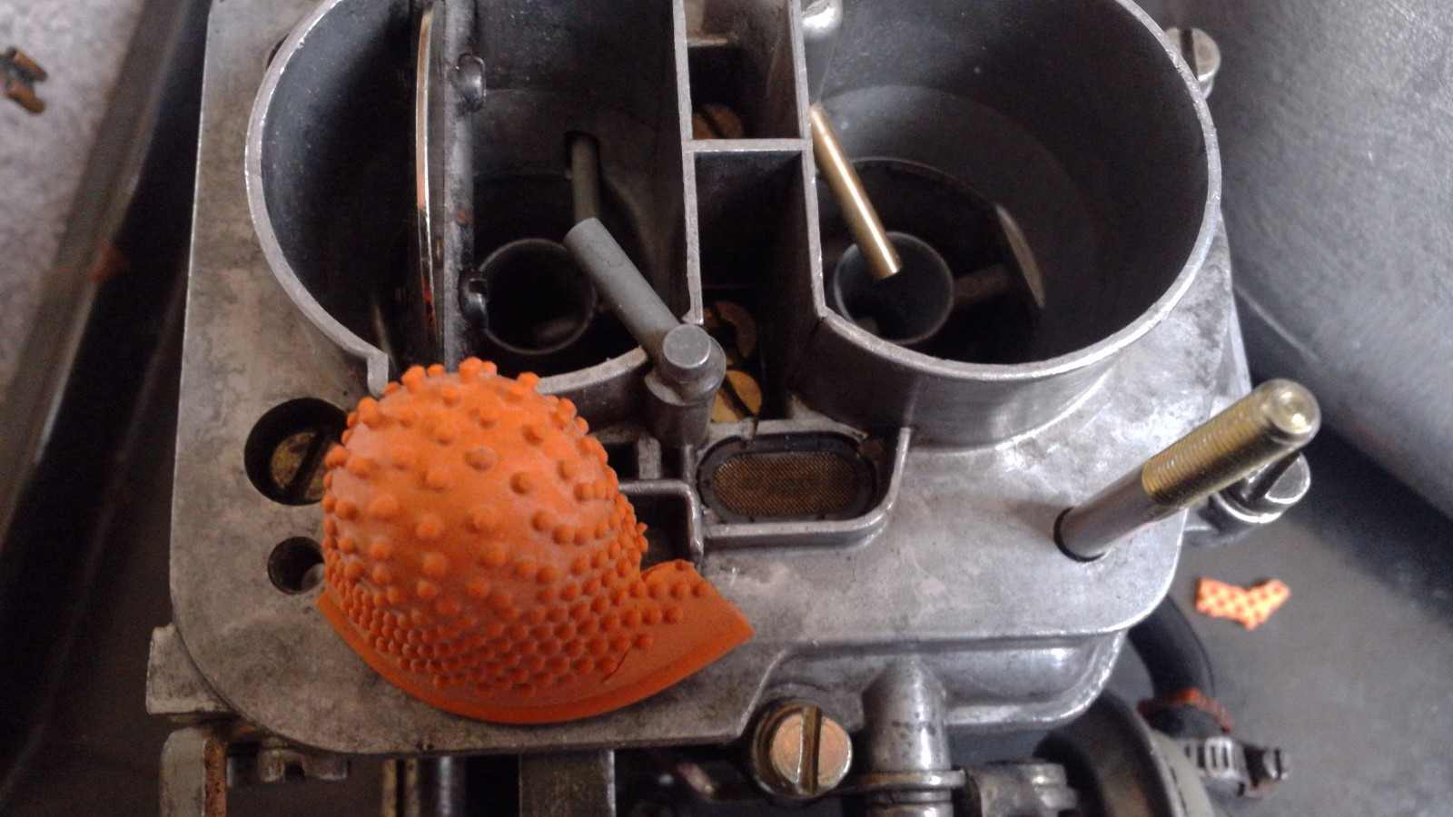

Need to keep the boost from escaping down the choke flap actuator hole.
Normally there's a rubber cap covering this. Had a go with a large rubber thimble
but failed.

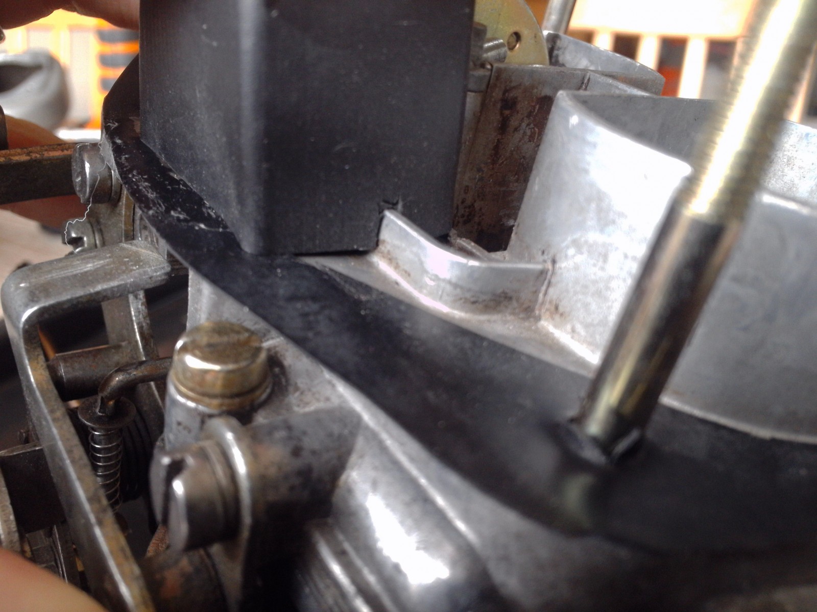

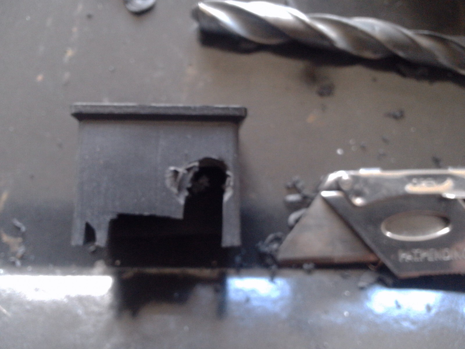

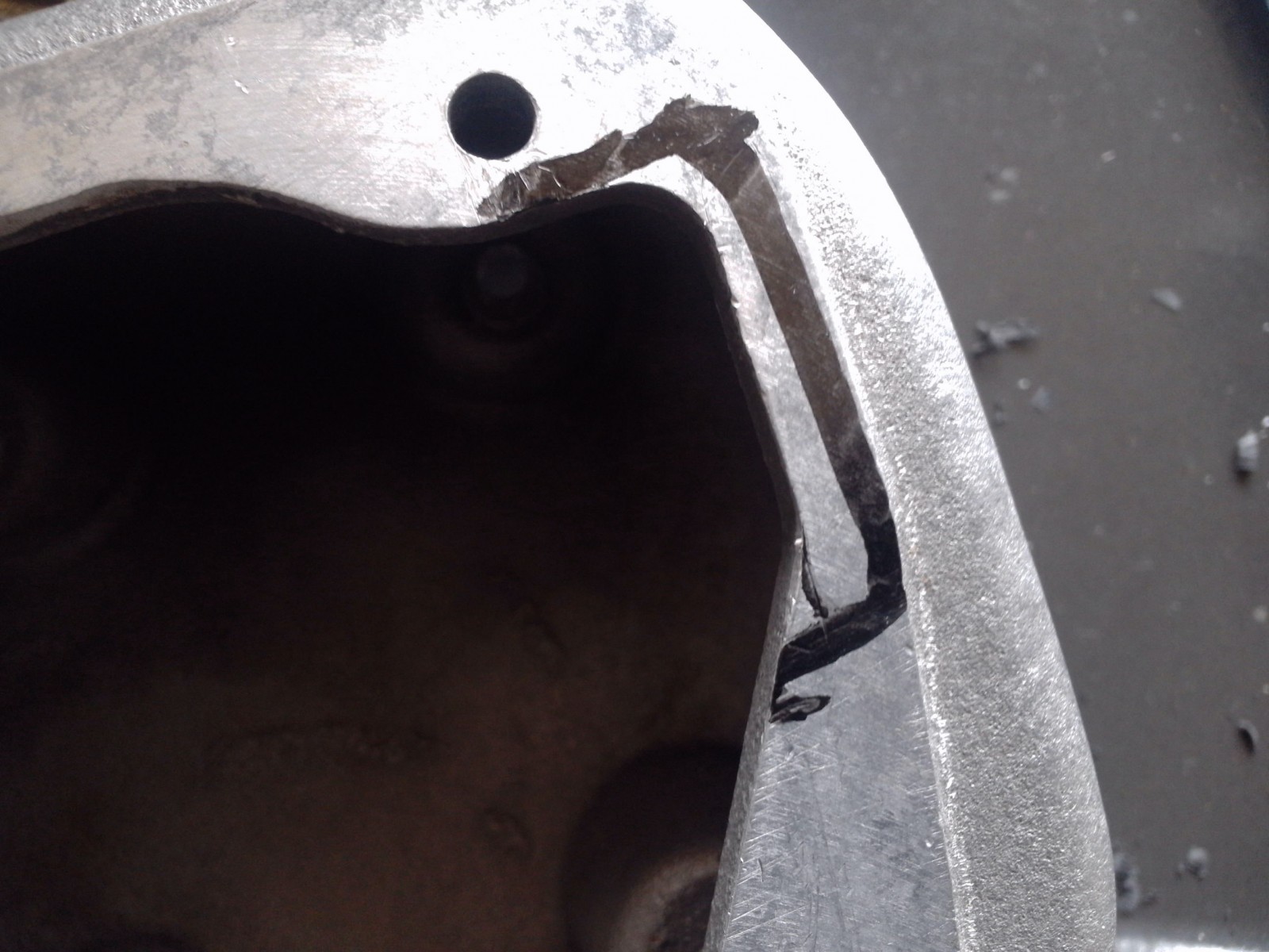

Then I tried some neoprene sheet to seal it off a bit while making a top gasket...WIN_20200412_14_50_05_Pro.thumb.jpg.c8807e3e2b8aa6eee8f4f5b274d59d1b.jpg
The super sharp blade cut a bit far... so used some vinyl glue to patch it up.

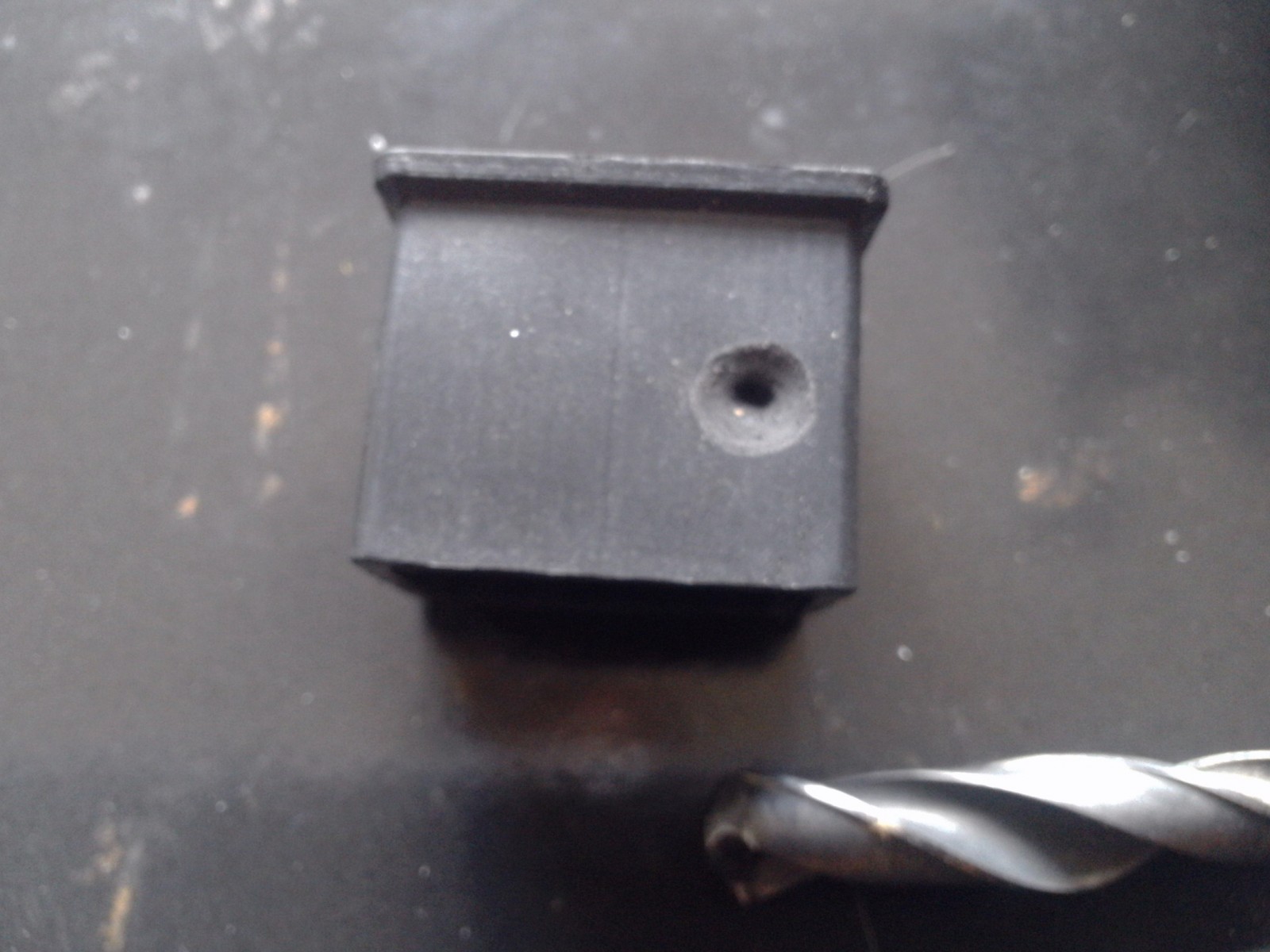

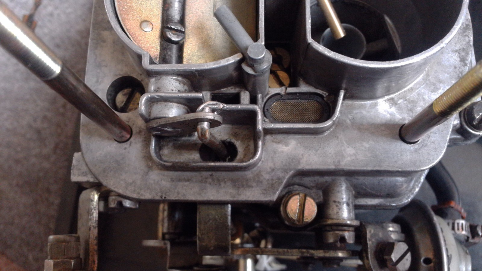

Back to sealing the choke flap lever. This is meant for a chair leg...
10mm hole for the choke axle towerWIN_20200628_17_06_54_Pro.thumb.jpg.329e2d7cc612abbffe54c923e0fc6644.jpg
cutout the profile
some trimming at the top
Need to smooth it and maybe use neoprene glue..
Grr, going to need to the trim the top hat too....
Bit of Dremel diamond saw and filing
and it fits like a glove
Can't decide whether to glue it to the neoprene or to glue a light wide compression spring to the top of the boot.

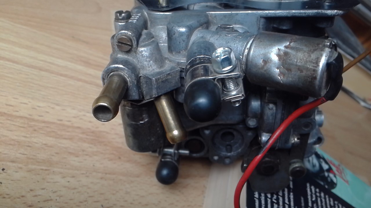

Now there's just finding out how and when the second fuel inlet valve solenoid  is activated.
It is capped off here for none boost operation. The red wire activates to open.
The main inlet and return also has a cut-off solenoid valve.
I'm imagining a big red switch on the dashboard to enable and cut power.

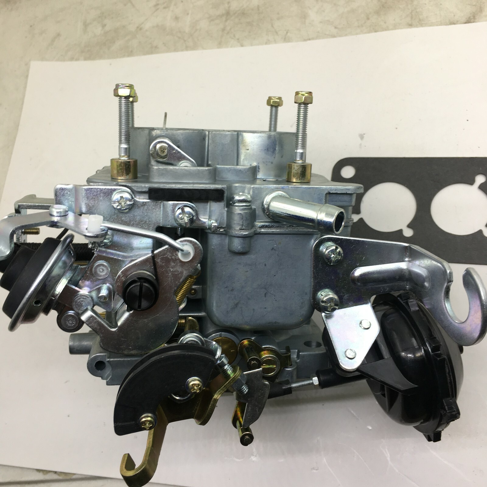

SherryBerg ? have a clone 103/252 carb.
https://www.ebay.com/itm/carburettor-replace-weber-30-32-DMTR-103-252-carburetor-for-lancia-y10-turbo-226/324073698562
But it shows a vacuum operated secondary which is surely bonkers.
No valve on the secondary inlet either.
Maybe it is just putting boost pressure air into the fuel bowl. That could work with a rising rate fuel pressure regulator.
Cause how could you have two needle valves?
