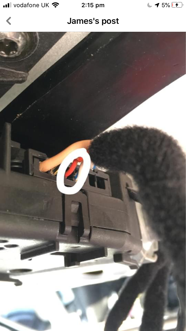

So basically my sunroof is not working,
I replaced motor, switch and did a check on wiring to see if current was going thru, the only wire that it didn’t have power to was the red one.
now Also my passenger window don’t work , I read online someone saying they are linked that if the passenger side window don’t work the sunroof won’t too...
I’ve stripped the dashboard and followed the wire down to the clips at the bottom, I also checked the wire for the look (the red one) and that isn’t showing power, (not sure if it is supposed to) I am so damn confused and need serous help.

First Welcome to the forum.
The Red/Brown wire does run down to the passenger door window motor (pin 8 )  along with the Yellow/Black wire  to pin 11 there are separate fuses for the roof #35 and the passenger window fuse #39
