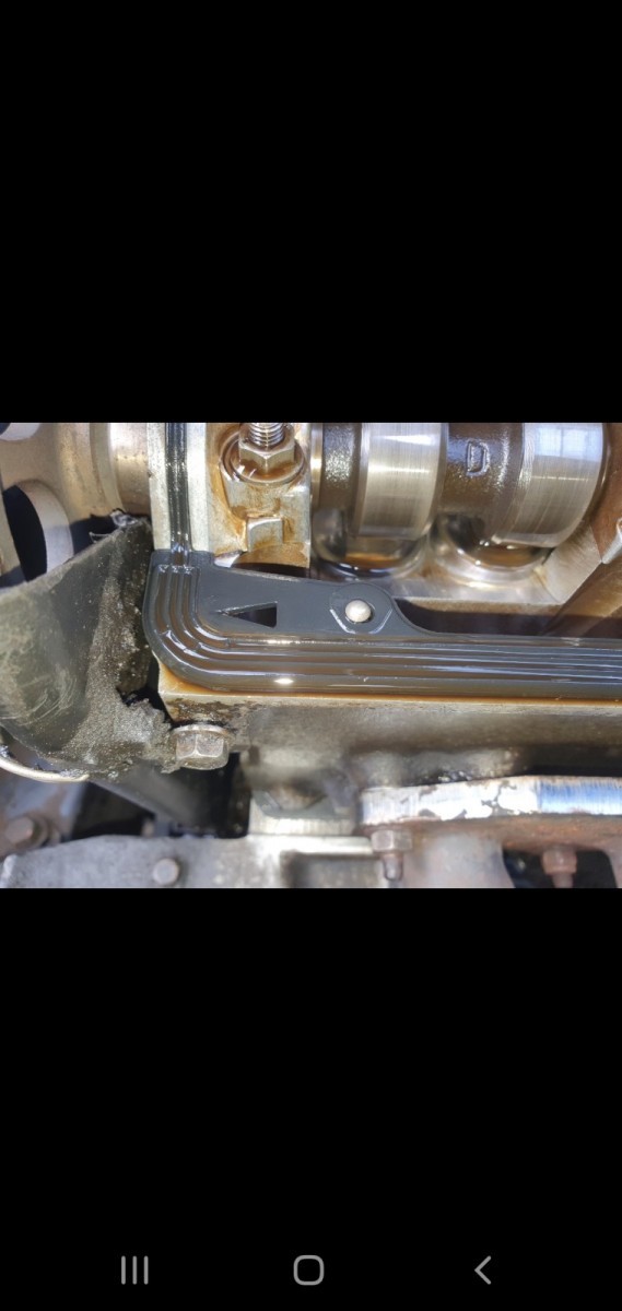

I have had an oil leak fairly excessively for a couple months costing copious amounts on oil. I decided after looking and looking that although I had a suspicion of the leak being from either the rocker or head gaskets as had just changed them.
So after fully dismantling and re assembling after a deep bay clean and an actual metal coloured engine had appeared I was able to see it was from the rocker cover gasket in the drivers side and closest to front of car corner of the gasket. The rocker cover sits level but does have some movement left right when the top bolts are not tightened down.
Is there a position the rocker cover has to be in to properly seal?
The gasket is also seemingly slightly big as you can see it on a side of the rocker cover when it moves.
Have attached pics to help explain although have a video I cannot attach here of the movement l/r of the rocker I can email etc ?
Any help appreciated
Thanks a lot
George

Its a long while since I had a Mk2, but a couple of things come to mind:
(1) Doesn't the cam cover have 'top hat' sectioned rubber plugs under the nuts that hold it down? If so, I would think that they should centre the cover into place.
(2) If the holding down nuts are of the domed variety, it is possible that the studs are bottoming inside the dome and preventing the gasket from being compressed sufficiently to form a seal. This could be caused by (a) a gasket that is thinner than the original or (b) replacement studs that are too long.
Don't be tempted to place washers under these nuts in order to obtain more 'nip' - its OK to do so up to a point, BUT too much clamping effort may distort the cover, causing even more of a leak.
It might also pay to place the cover on a flat surface (sheet of glass) and, using a thin feeler blade,  make sure that there are no gaps between the face of the cover and the flat surface when it is held down by hand pressure - It would be very difficult to make a distorted cover seal the joint.
