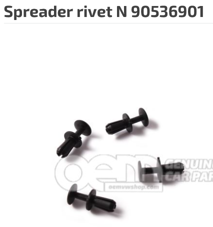

I think they are the type where you have to push a central peg in/upwards first, which then allows the thing to pull out easily?
According to this page that was wrong, they look like this:
So it looks like you have to pull  (just) the central mushroom-shaped bit downward first, that then releases the other part?
Edited by Pete1
They're normally the ones where you push the very centre piece of of in. If you push right in the centre with a 2mm drill bit, they should release
