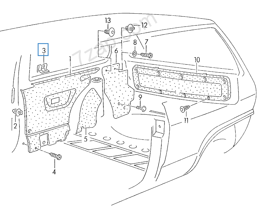

How do you remove what would be the rear door card on a mk2f coupe (apart from there is no rear doors). Not sure what its called
Rear interior trim panel for passengers.
https://volkswagen.7zap.com/en/rdw/polo+derby+vento-ind/po/1992-120/8/867-84000/#3
Can see on etka little screw at bottom - that's fine.
But how do the clips at the top near the window work?
Don't want to break anything.
Do seats/rear bench need to come out?
Any help much appreciated.
  • Views 1.8k
4 - screw = ok
3 - clip = how to?

On mine after the screws have come out I need to pry off the front door seal where it also clamps over the door card and the rear window seal where it covers a thin metal lip along the whole of the card's top edge. Once these are free I have to push the rear seat-backs down a bit to wiggle the card free but you'll work it out.
